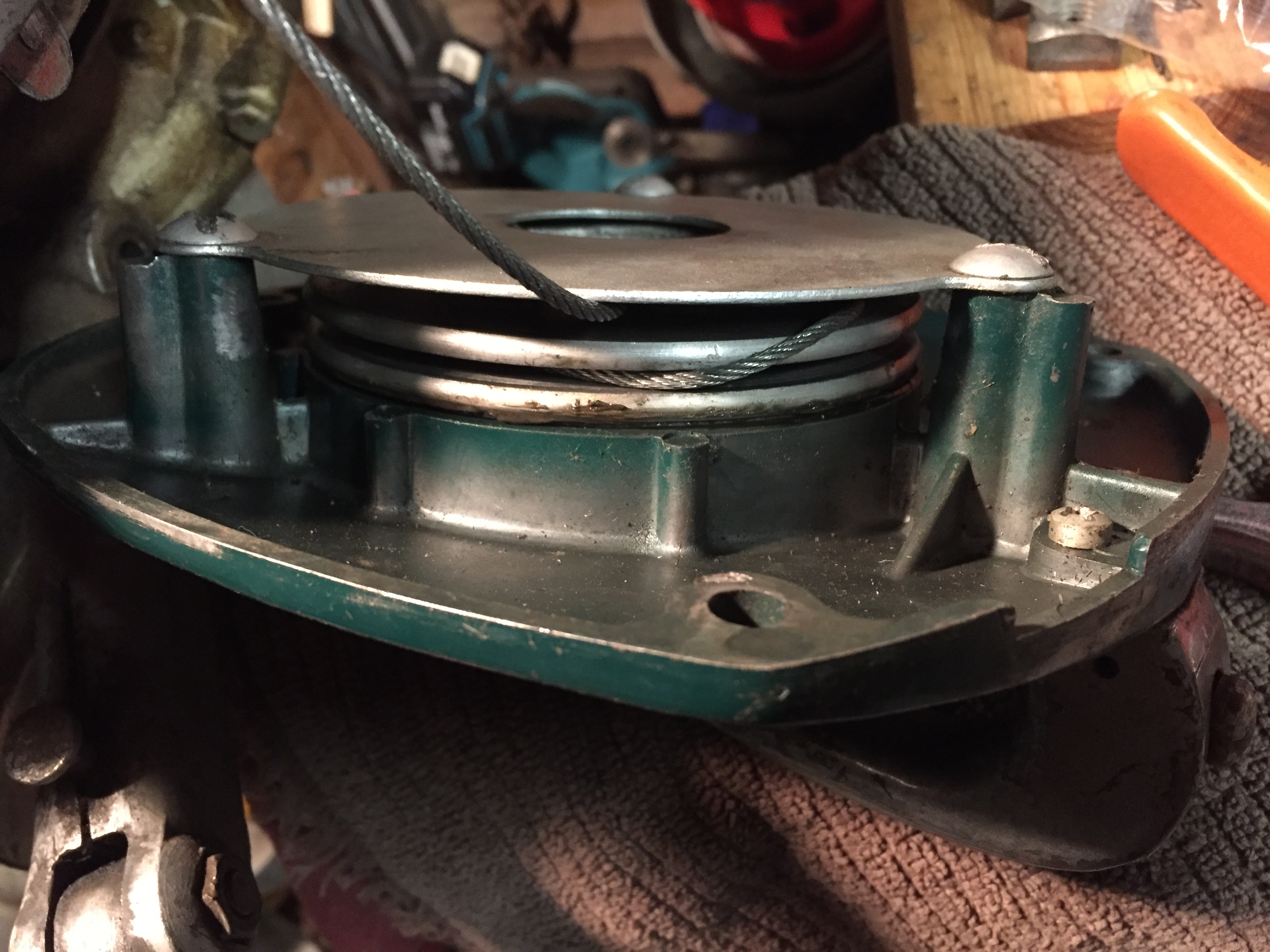

      Why does this cable keep getting pinched in the pawls? Is there a trick to this recoil? It retracts v-e-r-y slowly. I suppose i need to take it all apart and put new white lithium grease in there so it retracts more quickly. Is the cable correct? I wonder if it’s too long. It’s almost 4 feet long. Any idea of the appropriate length? I know OMC had different lengths for different models.
      Any words of wisdom for me?
      Thanks in advance!
      Scott

          That looks too thick, I will measure my cable and post it.

              I have two Mark 5 and the cable is about .09 inch your cable looks larger.

                I got this motor in a group buy. The recoil was disconnected completely. Maybe a po tried to replace the cable and tgat’s where it all went wrong. I’ll check the cable thickness and go from there.

                  pull the 3 screws and plate and 2 paws. the recoil will work . when it is fine then put the paws and plate back on. the rewind will lock up if it is not on the motor . it must engage the flywheel nut to work.

                    When testing it off the motor, you can hold the recoil upside down and temporarily put a short 1/2" drive socket, say maybe size 7/8", in to the recoil where the toothed flywheel nut would go. This keeps the pawls from over-extending and locking up the recoil.

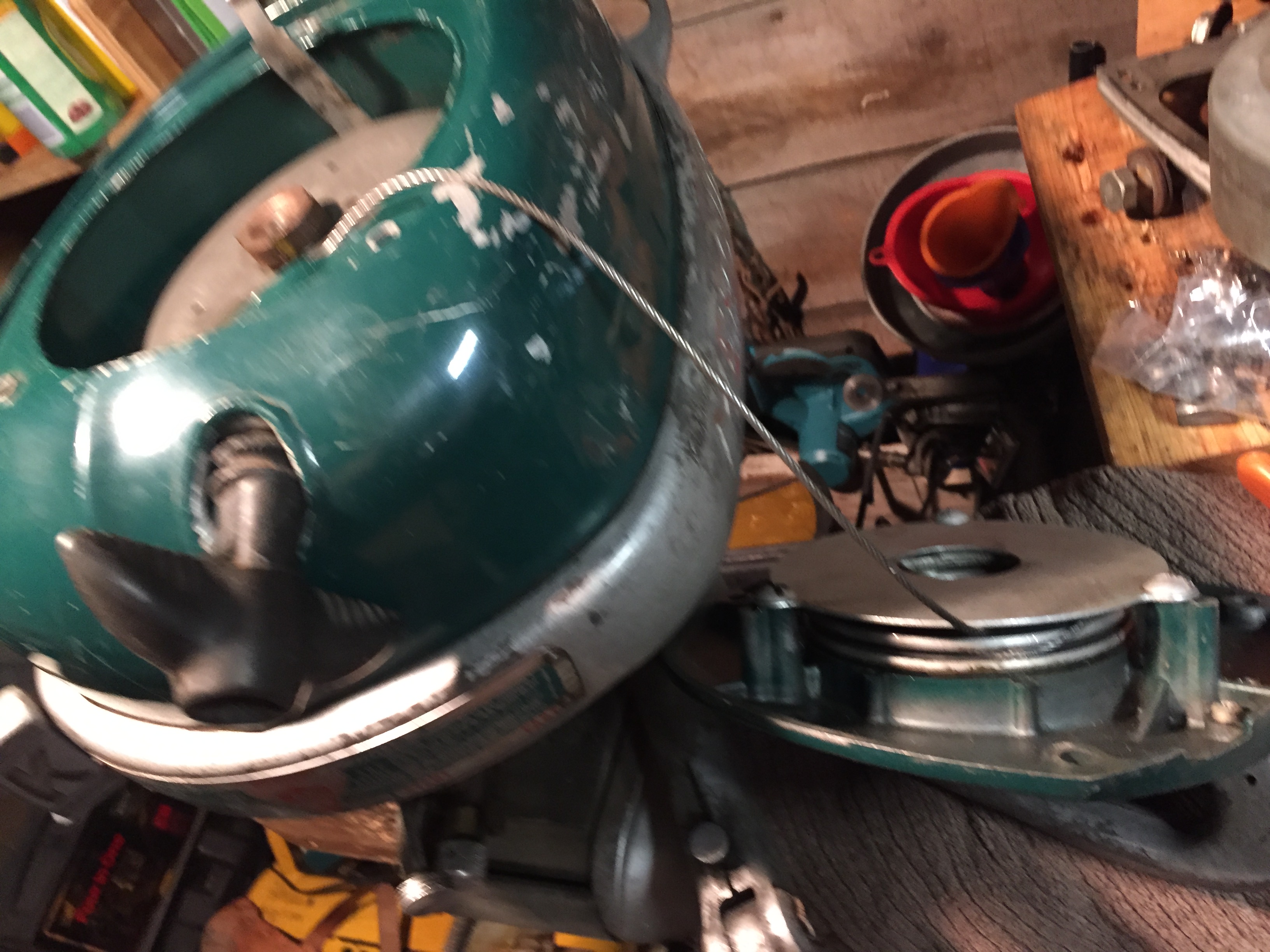

                      Well, more trouble. My cable measures 3/32 so that should be fine. Now I can’t get at the allen screw which holds the sheave screw because I can’t get the neutral lever assy off of the recoil housing. I removed the 3 screws which hold it on but it’s still rock solid. Tried tapping with a drift set through the holes where the screws go but it wouldn’t budge. Any suggestions? Here are some more pics.
                      Are the pawls supposed to just sit loose on their bosses? The manual mentions some anti-rattle springs but I didn’t see anything like that. Are they supposed to be there?

                        Scott, to remove the Allen screw, I have cut an Allen wrench down so it will fit in under the handle. I hate it when I find top handles that have had holes drilled through them to get to the bolt. Usually on Mk-20’s. These are often pretty tight, but at least on green tank motors, they usually are not rusted in place, just tight. Be careful to try to not spin the wrench in the bolt, as then you will have no choice but to drill the sheave bolt head off. As for the anti-rattle springs, these are just wave washers that sit under the pawls. Not critical for the operation of the recoil assembly.
