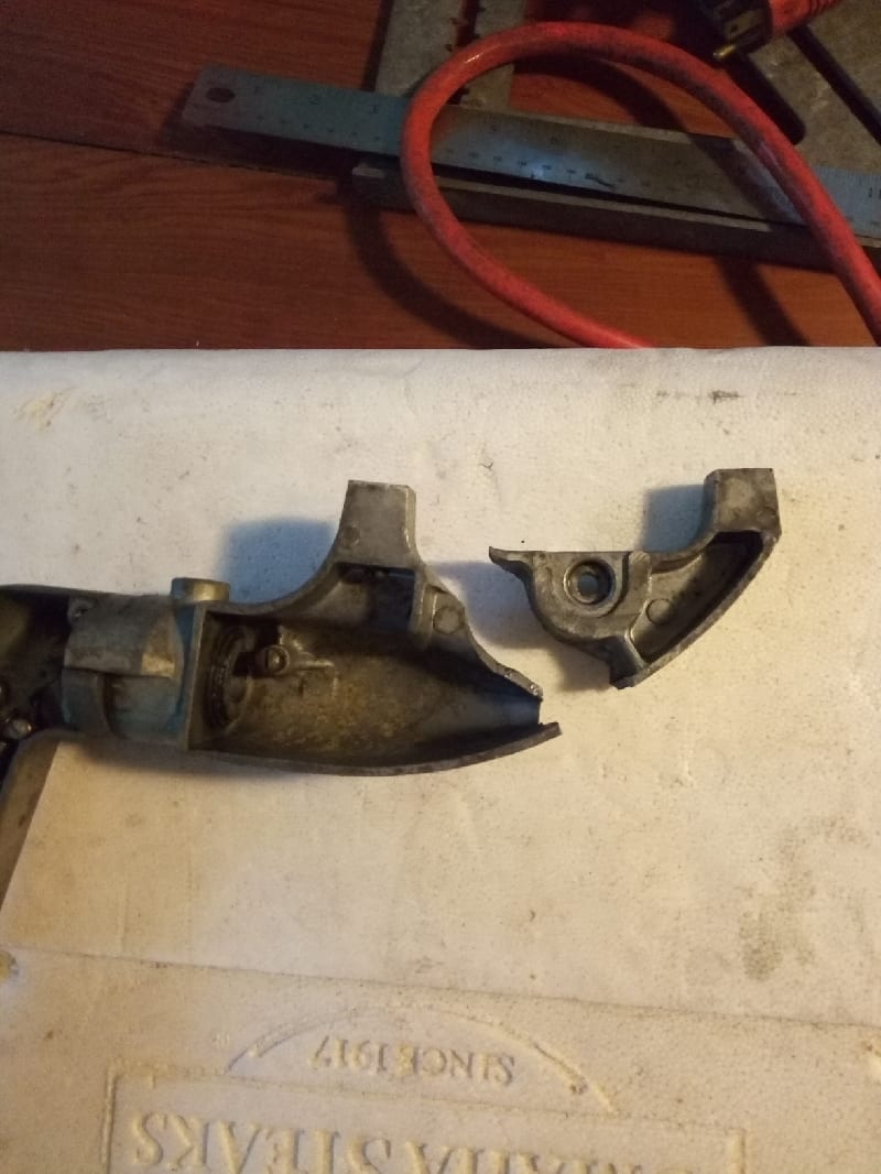

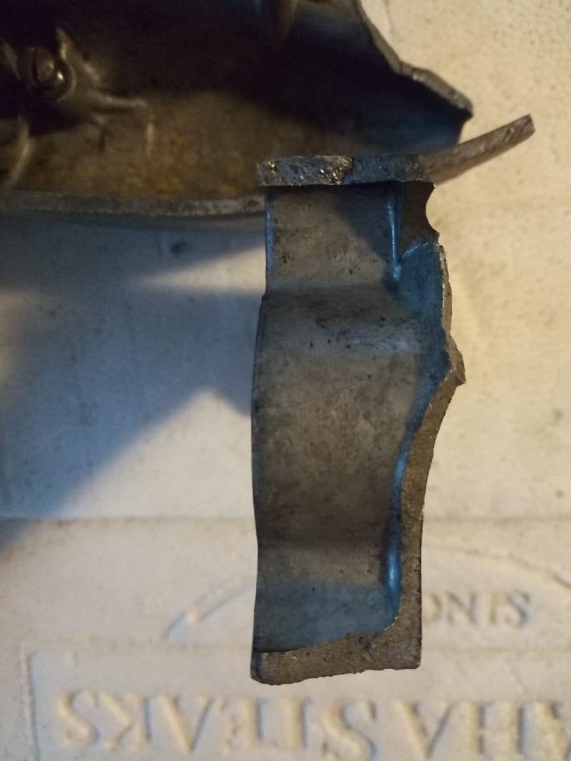

                Now I am thinking the handle bracket broke first. I looked at broken edge and three sides were bright looking and on one corner the crack was dirty looking. Everything happened so fast I not sure if handle jerked out of my hand, but I know I lost control.

                    So do you have a picture of exactly what broke on your motor?

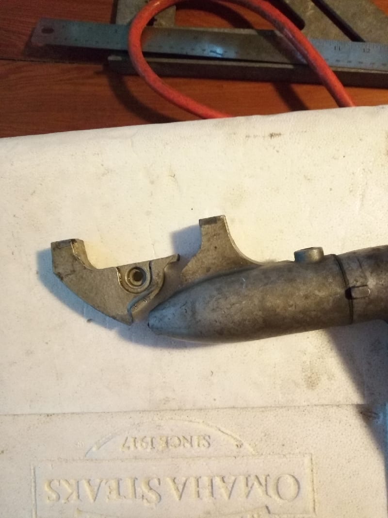

                      Looking thru my hard copy of the Martin master manual, it seems there are 2 different parts depending on which model motor you have.
                      The number you posted in your want add is listed as the standard motor and not the twist shift. Is this correct?
                      Again, a picture is worth a thousand words here, as I think one of the motors has a black tiller grip and the other has a red.
                      Let me know as I may have a spare…depending on what it is exactly that you have..

                        Steering handle bracken photos. The first pix shows dirty crack line top and bright sides and bottom. A pin through the small holds the bracket to front of motor block.
