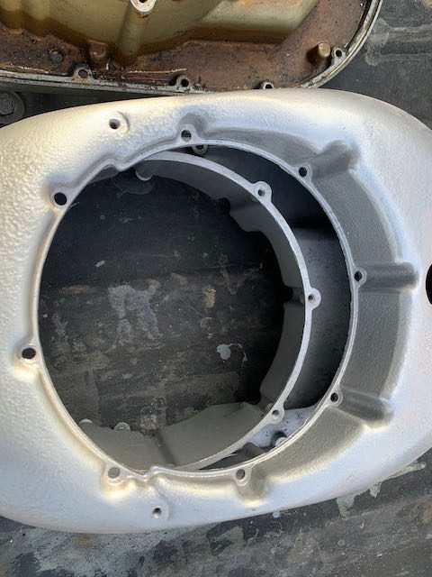

      What kind of gasket material would I use for this tank?  Cork coated with Seal All?
      IMG_6286
      Is there some kind of gasket that goes here?

      #253254

        davidk
          Not sure what you are pointing to there, Outboardnut.  I don’t see a fuel tank gasket offered.
          #253260
            Click on the search icon and type in “gas tank”
            Contact Russ with questions..
            https://martinoutboards.com/product/204045-split-tank-gasket-sets-2-gaskets/
            • This reply was modified 4 years, 9 months ago by Tubs.
            #253263
            davidk
              Dang it.  I thought I tried that and got no result.  Thanks Tubs, and Outboardnut.

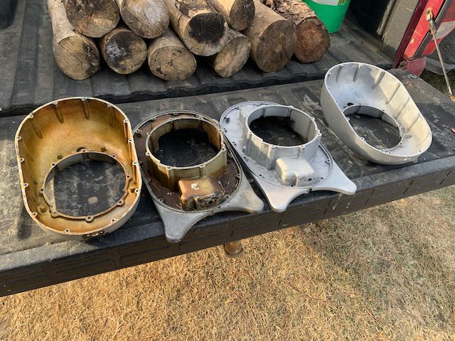

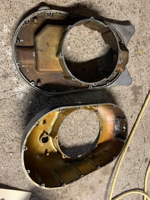

                  Buc, I started this project a couple of years ago and I forget how I got it to split but I’ve done it twice.
                  IMG_6323-2
                  Got all the screws out, above and below?  Heat gun?
                  IMG_6327

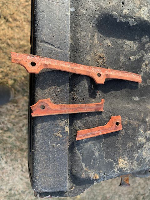

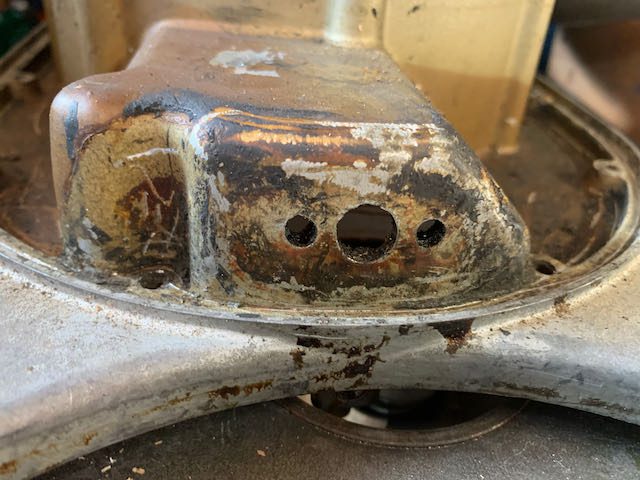

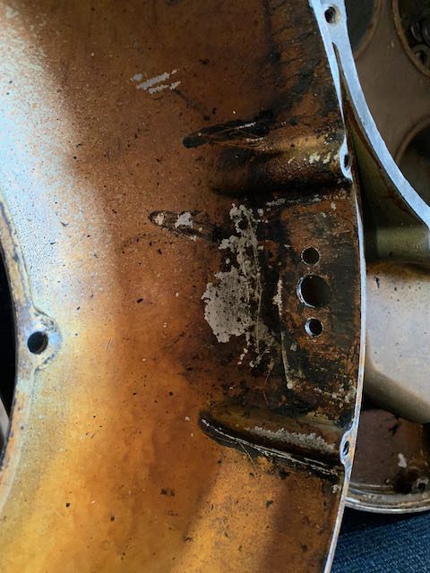

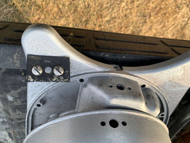

                  I found pieces of the old gasket and the gasket that goes around the hole for the needle valve
                  IMG_6325
                  IMG_6326
                  #253296

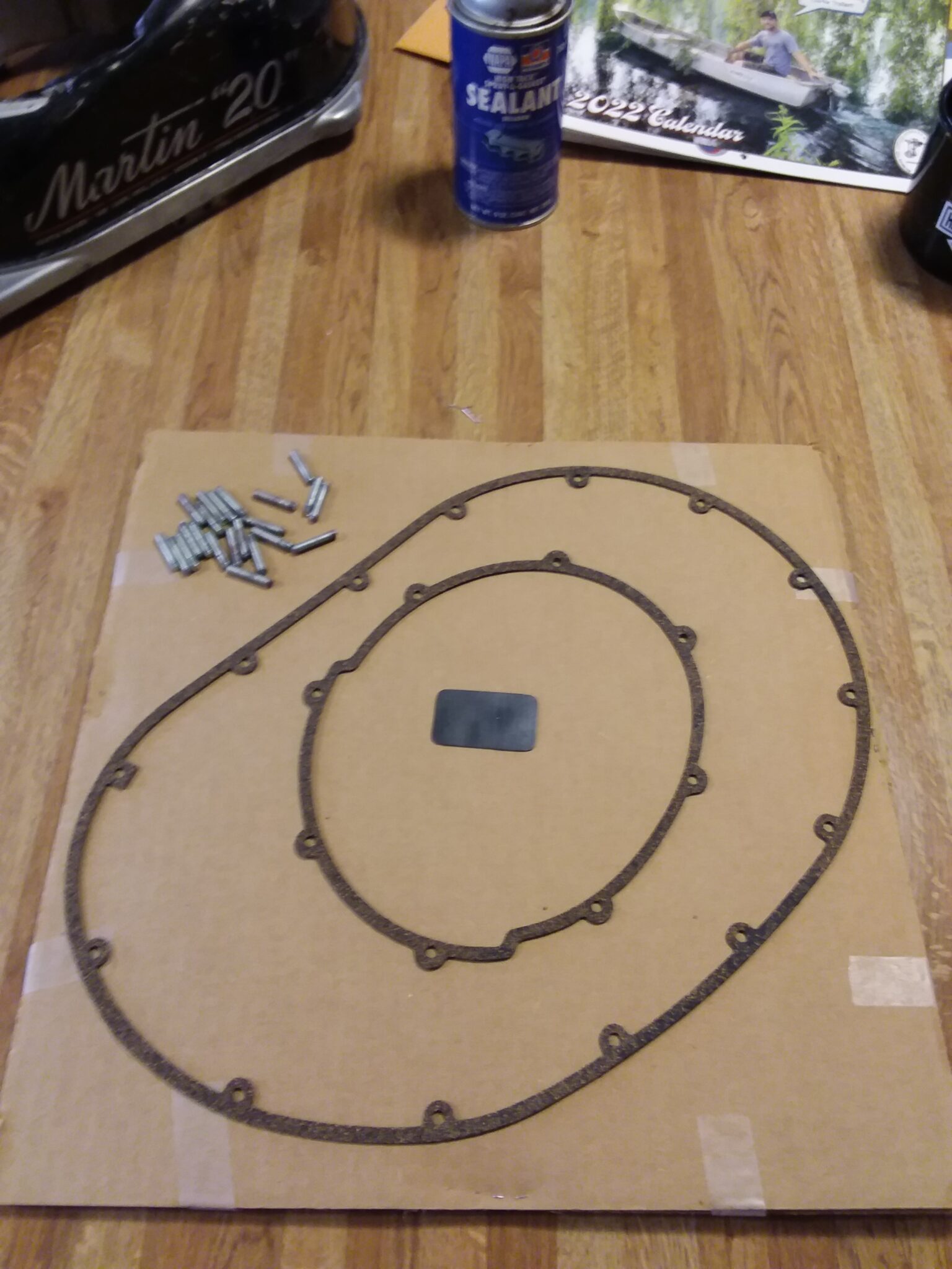

                      This is the 3 piece gasket set Russ Larson sells for the 20 tank. I have had great success using Larsons 2 and 3 piece tank gasket sets on the 20s and 40/45s.
                      Russ recommends using a light coat of “High Tack” spray gasket sealant on his tank gaskets. NAPA/PERMATEX type stuff.
                      Also using 22 “alignment pins” (which look a lot like 10-24 screws with the heads cut off) screwed into the threaded part of the two gasket areas allows you to keep all the gaskets in place as you are putting the two tank parts together as there will come a point when you really can’t see either gasket and it’s holes. Kinda gives you the confidence that nothing slid out of place. Now you can pull the “alignment pins” out one by one and replace with the original screws. “Alignment pins” that I use are about 7/8″ long.
                      Anyway, hope the attached picture is decent!
                      Respectfully,
                      Bob (In Sunny Southern Maine!)20220124_104557
