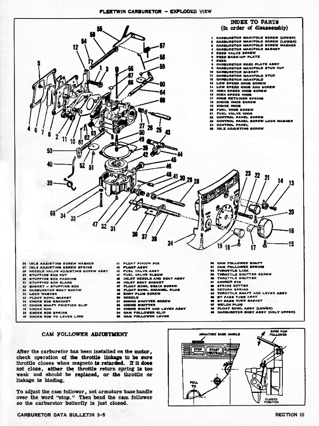

        I have no idea about the Martin, But the Neutral Clutch Evinrude Fleetwin also uses the Tillotson MD carburetor and this is what they have to say. . . 🙄
