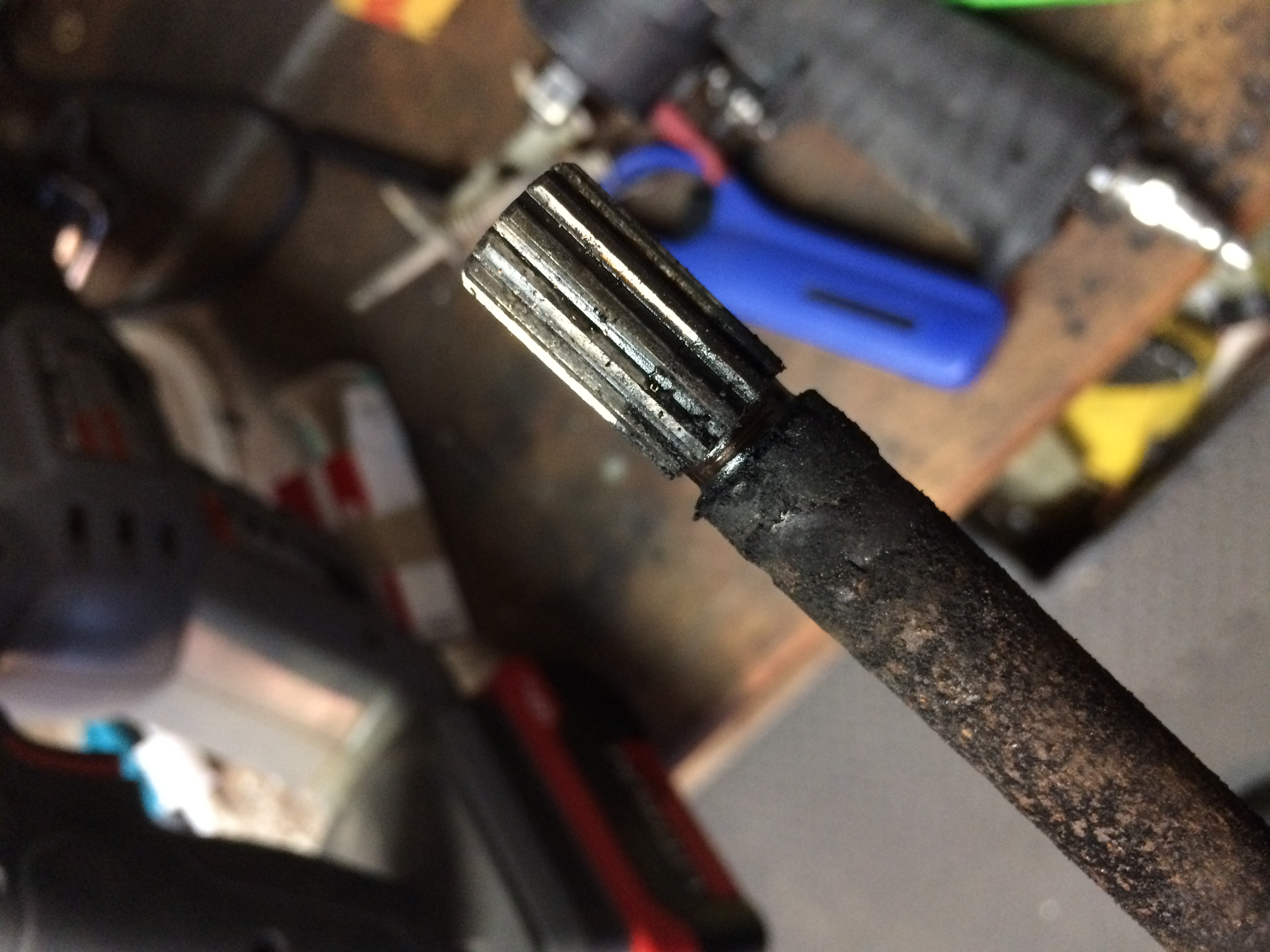

          Putting back together and I have a o ring missing from upper shaft where it connects to block. How pertinent is it to have?
          #76636
            It won’t hurt the driveshaft, it’s stainless steel. HOWEVER, the crankshaft is not and it will rust just looking at it. The "O" ring is supposed to stop that, keeping the water out and the coat of grease in. If it fails, the rust will make it very hard to remove the shaft. Then as the splines rust away, the motor no longer propels the boat. . . 😮
            #76642
              You can probably find a replacement at a well-stocked hardware store.

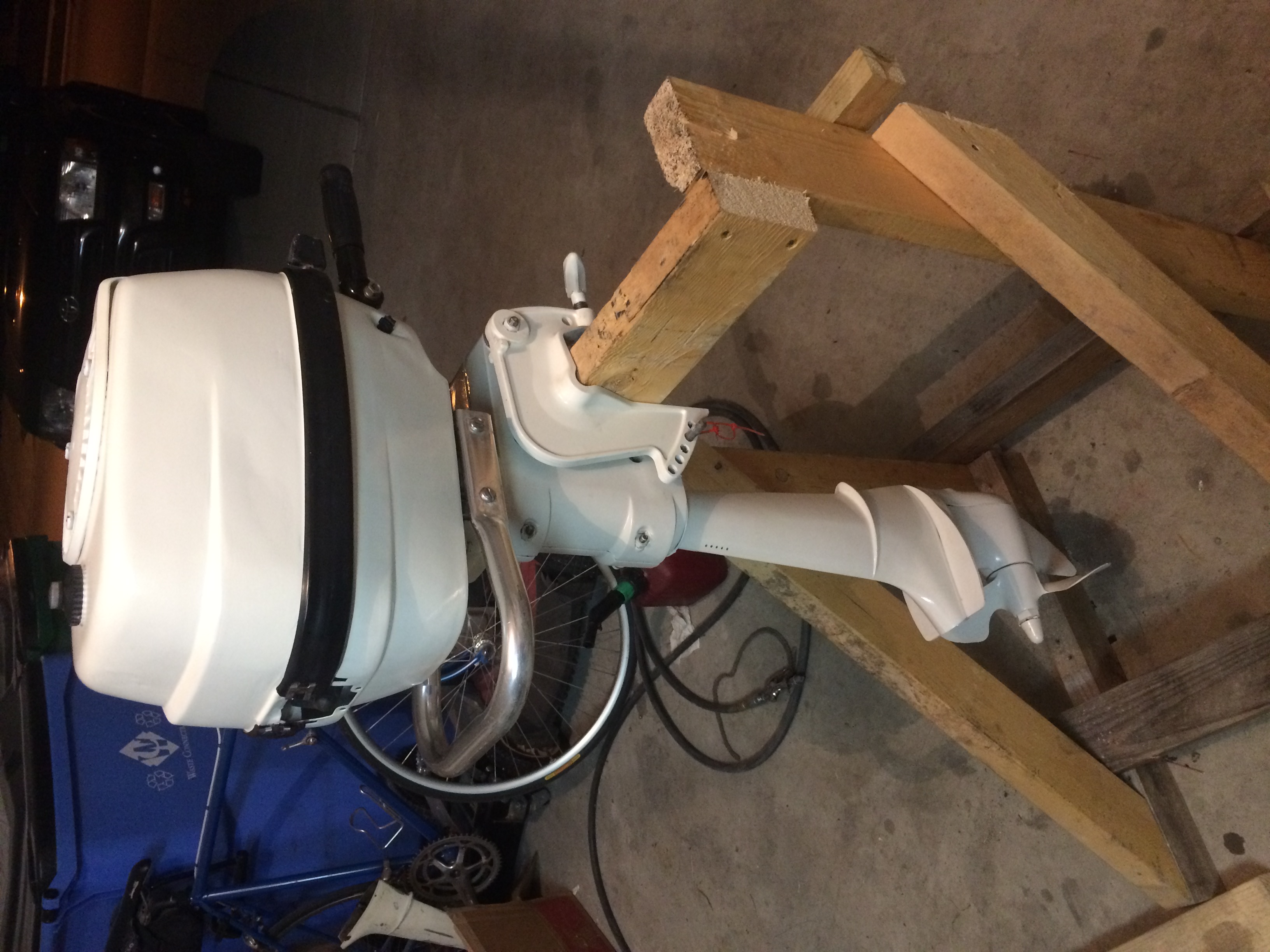

                john8504
                  Painted and just need some decals.
                  #76690
                    Wow, looks really good!
                    I have never noticed drive shaft O-rings to be anything special…They just seem to be the black, Buna-N material.
                    #76692
                    john8504
                      I had some cheapo ones from harbor frieght and put one on there. I’ll find out after a few runs if it melts off haha.
                      The paint is body work isn’t a ten but that is fine with me. It is going to be put back to work.
                      #76693
                      joesnuffy
                        Looks Great. I have gotten a lot of decals from ebay and their are some available by club members here.
