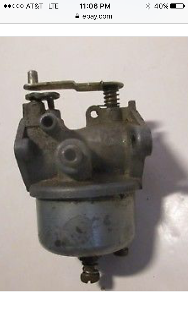

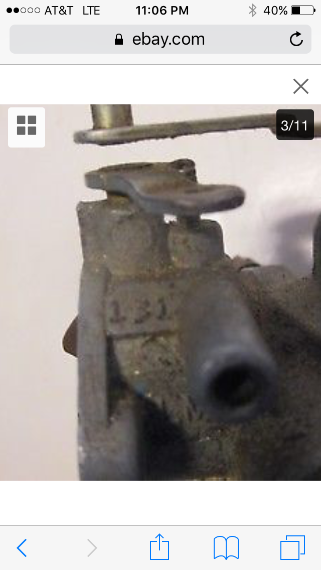

If you have an old yard equipment repair shop within reach, they may still have Walbro LMGs, I’m pretty sure they had widespread application..April 10, 2018 at 7:46 pm #73756So I ended up finding a carb for a 70 3.5 mcculloch on eBay and I’m just waiting for it to arrive and see what happens with that. I hope it works.
April 11, 2018 at 12:49 am #73780Some Ebayers know not what they have. McCulloch officially spit the bit in ’69, and to my knowledge never produced a 3.5. But whatever it is may be close enough..
April 11, 2018 at 4:25 pm #73820I looked at it and they might have the year wrong but it looks identical to the once that should be on mine. It’ll be here Friday, so we shall see

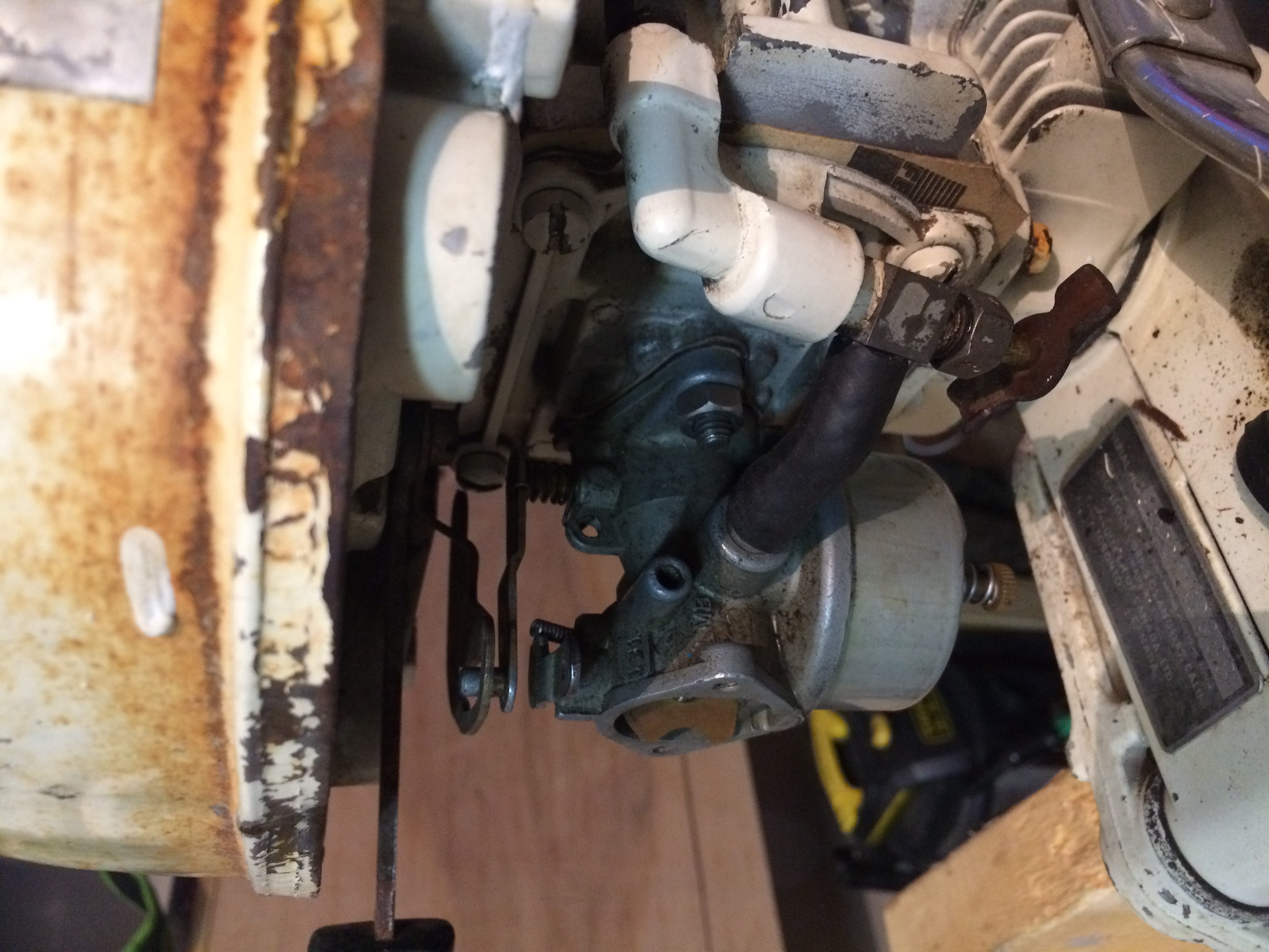

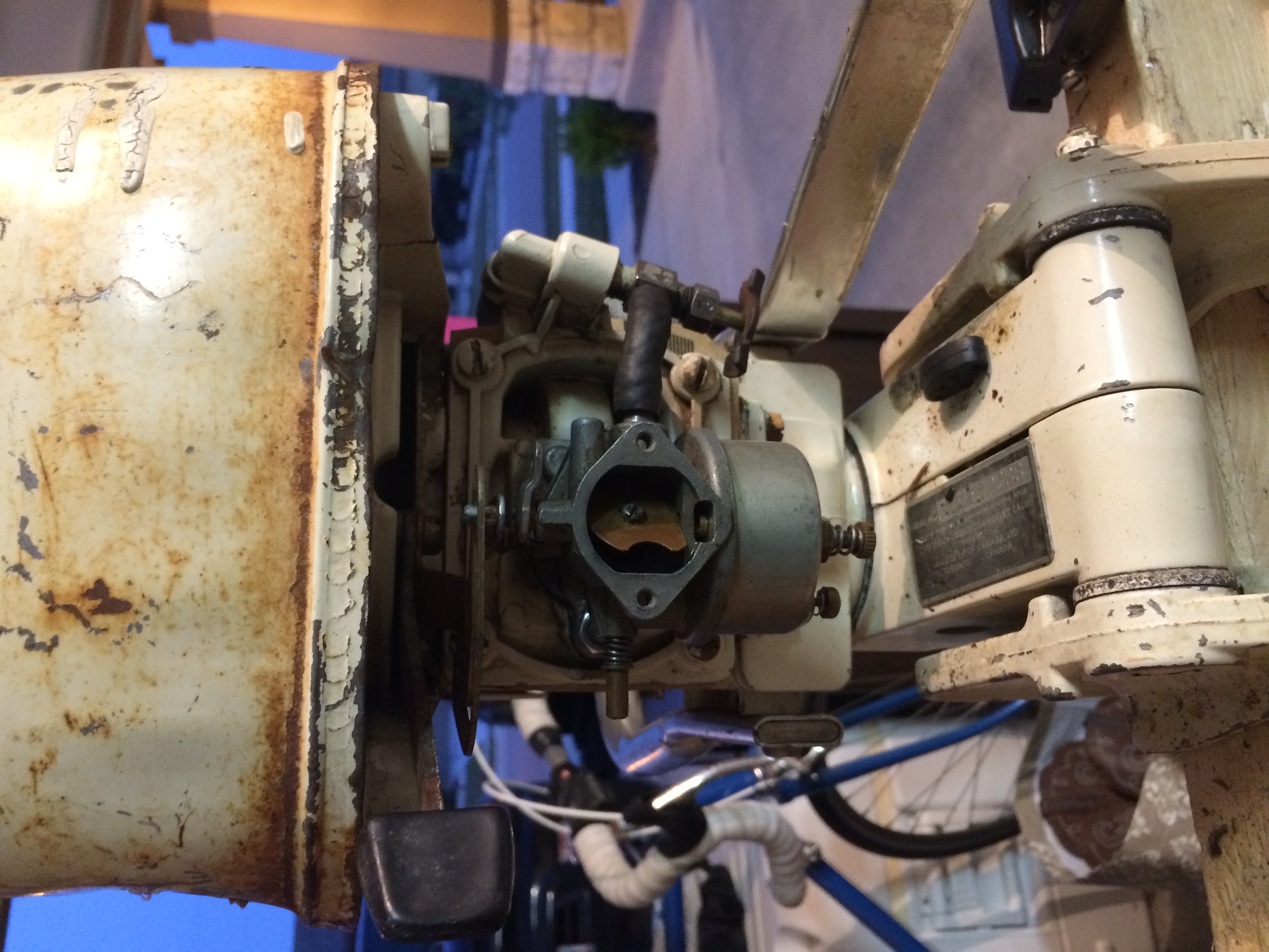

You could also just try cranking with the choke closed ?April 14, 2018 at 11:30 pm #73997Yeah I’ve done everything I know how. I rebuild the mcculloch chainsaws as a hobby and I have 4. So I know that the engine is a modified chainsaw. I have that going for me. The carb is a glorified lawn mower carb. When I got the carb in, I took it all apart to see about cleaning and it was perfectly clean. The drain on bottom does its job and I have fuel coming out. (Waiting on a carb kit for it since the drain gasket is bad and causing a leak.). I have tried every throttle position, spraying fuel past the reeds,spraying fuel into cylinder and reinstalling spark plug. My points gap is a .20 and the key is not sheared. My compression is 92. I’m just baffled to what could be going on.
April 15, 2018 at 2:20 am #74008Does the magneto have a cam to operate the points? It could have been installed upside down.
April 15, 2018 at 2:31 am #74009Is the exhaust clear? I had a two-cycle pump that would not fire one time. Wasps had plugged the exhaust with mud.
