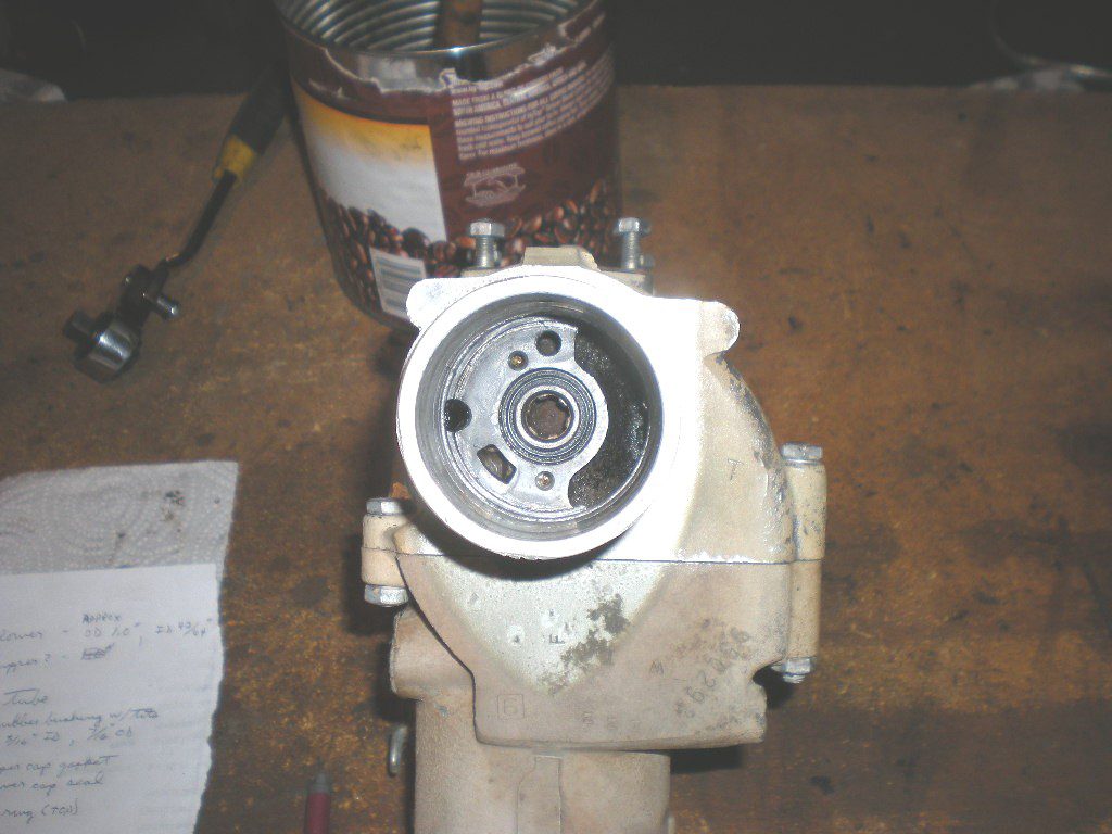

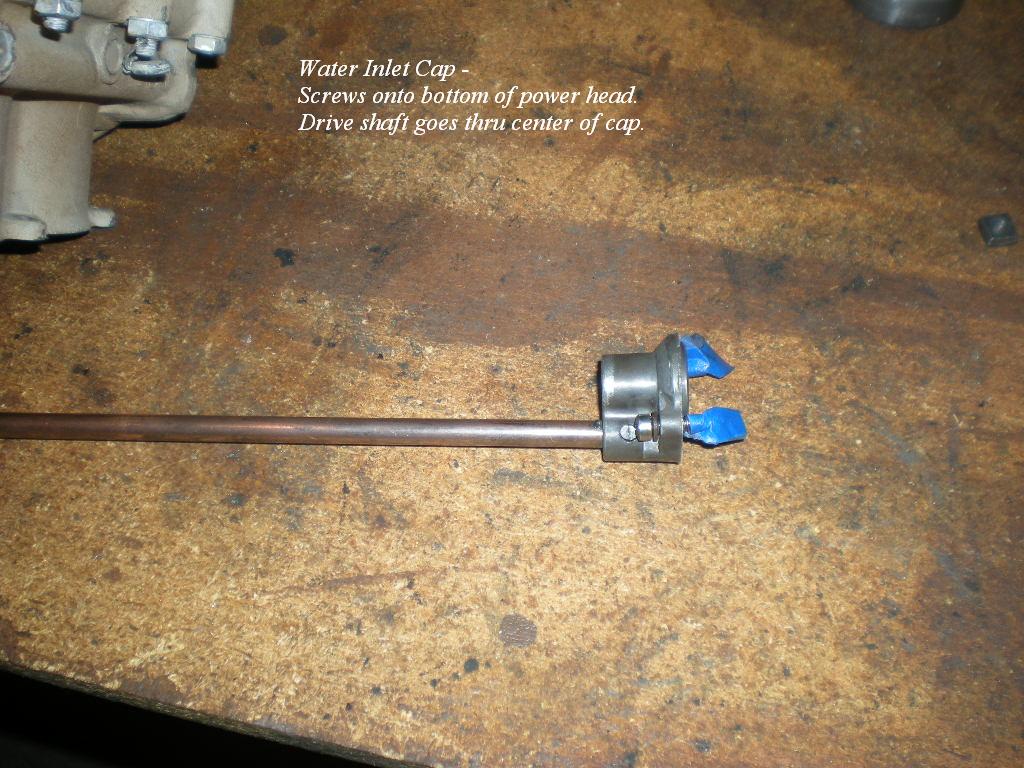

The Mark 5 Swivel Tube is conneted to the Crankcase as an assembly. Deep down in the attached swivel tube is the Water Inlet Cap Assembly with both the crankcase oil seal and the bushing / seal for the water inlet tube. I would like to replace both seals, but stumped on how to get at this. Anybody done this before?

March 28, 2023 at 6:54 pm #274534A long Philips screwdriver.is the merc tool takes the assembly out. as said no need to remove the tube.

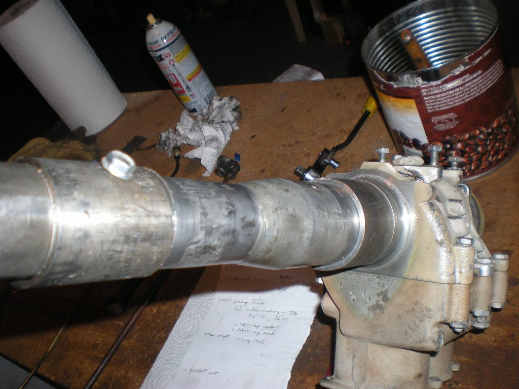

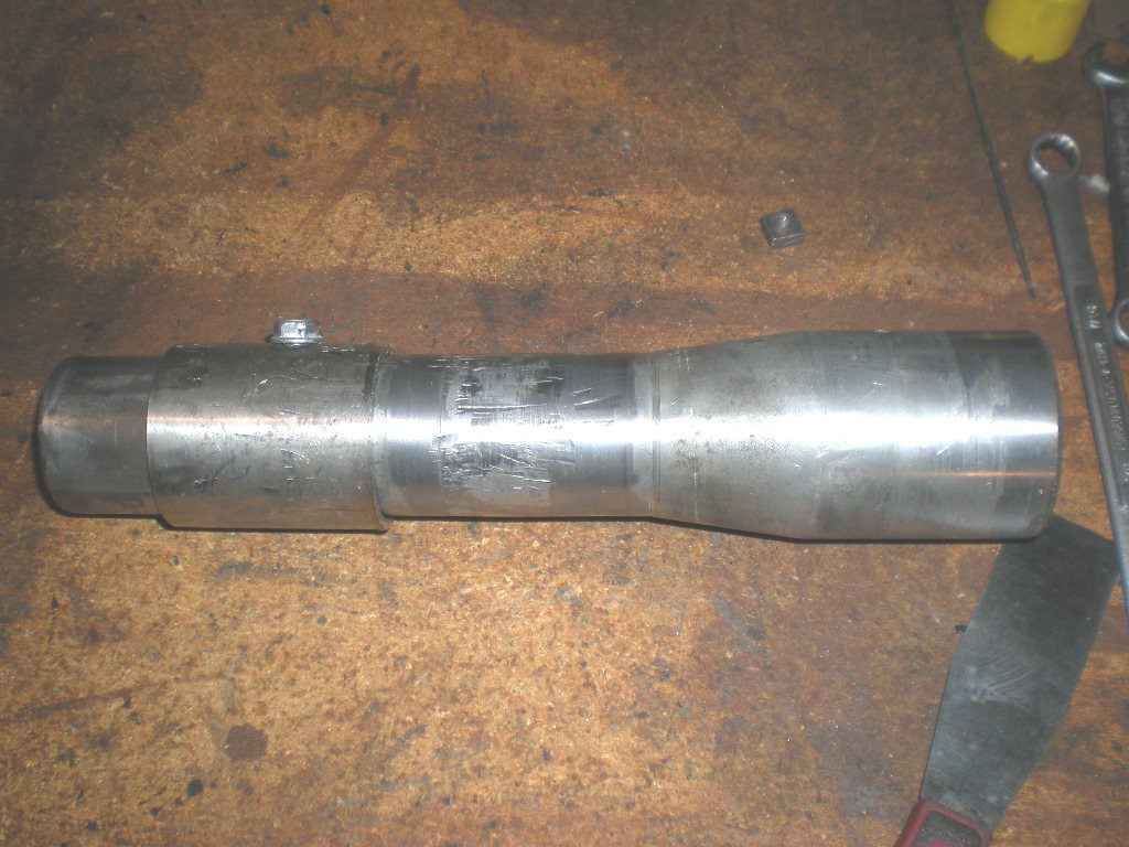

March 28, 2023 at 10:25 pm #274544If you don’t take the tube off, you may have to get creative
to clean the old gasket. Mine was a mess and stuck on the
bottom of the powerhead. I think that’s why I took the tube
off in the first place.Prepare to be boarded!
March 29, 2023 at 5:52 am #274545Assuming the screws don’t snap off, the gasket surface can be cleaned by grinding a sharp edge on the end of a steel bar and scraping it back and forth until the surface is clean enough, then vacuum, etc. This takes a lot of patience and time; but that is a standard requirement for the Mark 5 and Silent Six, in general. I like Mercs, but let me tell you, most of those engines are truly silent for a REASON.

March 31, 2023 at 1:41 pm #274610Thanks to all! I have a couple of approches here. I did not look to me that the Pilot cap would come out of the swivel tube. But learned that it can. No matter which way, Full on Open Heart Surgery or Arthroscopic, I am in for a Mark 5 surgical session. I think I will delay until the next long Ohio winter to begin (not long a long wait). Fun!
