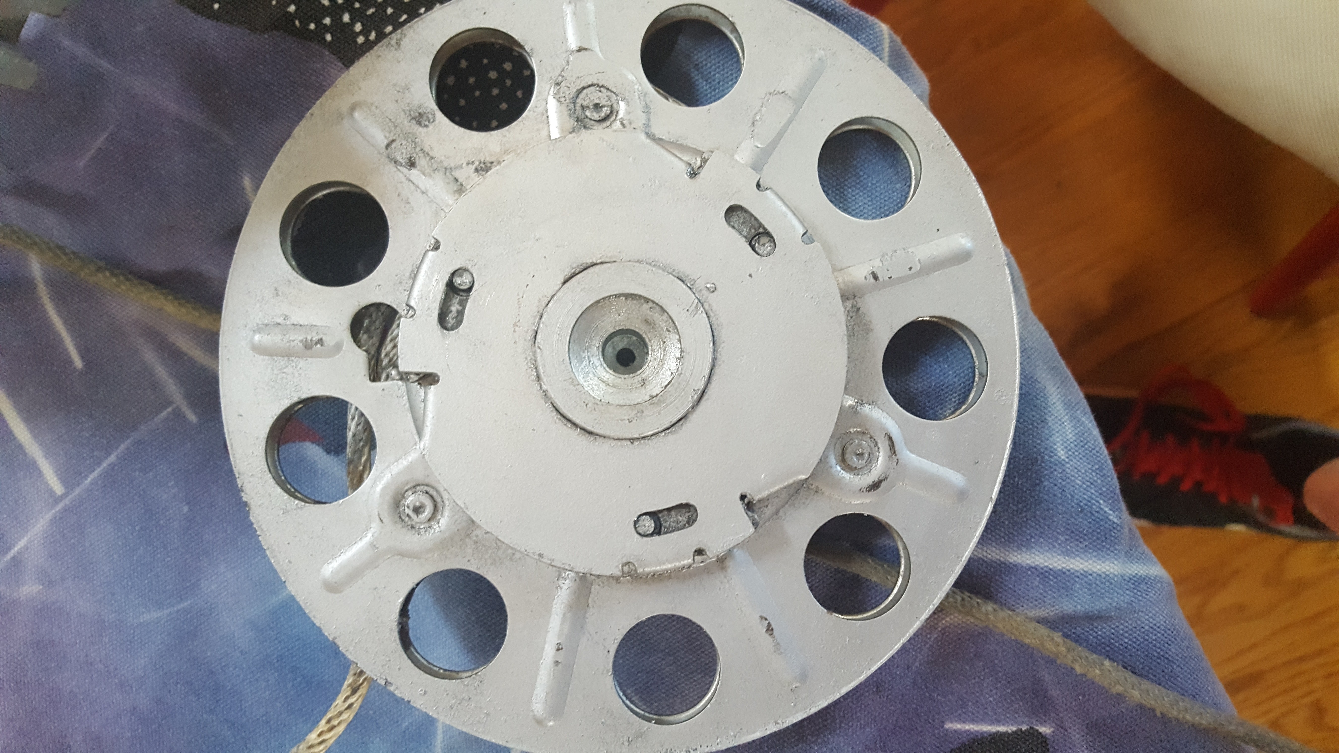

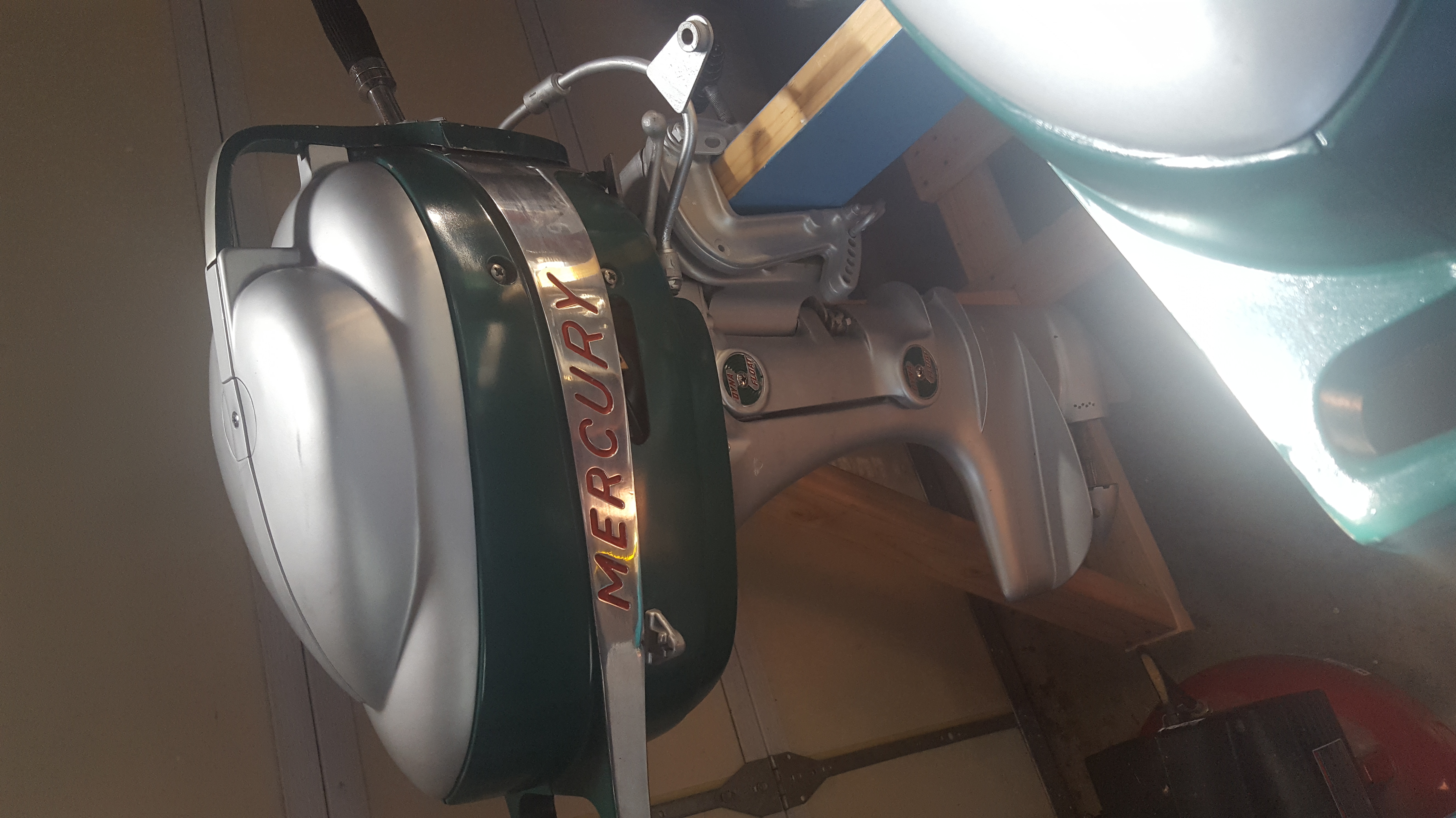

      Picked up a nice restored mk 25.
      The pull start rope is hanging out with no tension. When I pull the rope i can feel a little bit of spring? How do I take the recoil start apart? Do I need any special tools?

            Remove the front cover then the side. You will see bolts for the rewind.

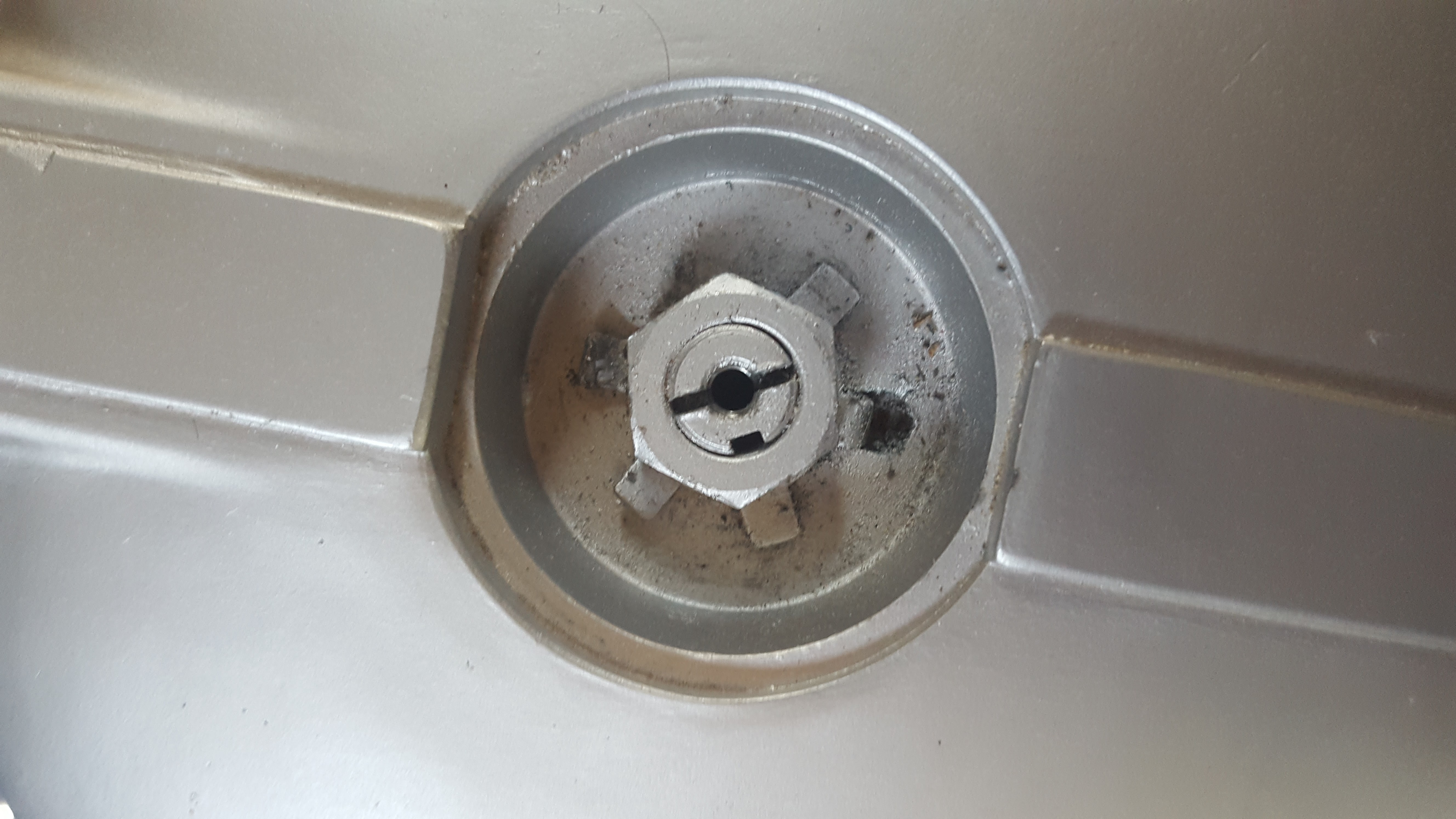

              remove the center cap on the top to access the nut to remove the guts of the rewind after removing the rewind assy like Jeff says.
              #60608
                Keep in mind that nut will be left hand thread. Sometimes you can work some oil into the various moving parts and it will work without taking it all apart…SOMETIMES.
                #60609
                cheetahgod
                  How do I remove this bolt it seems very tight?
                  Thanks I’m having fun. 😀
                  #60610
                    like the man said left hand threads use a socket .
                    #60612
                    cheetahgod
                      Thnaks got it off.

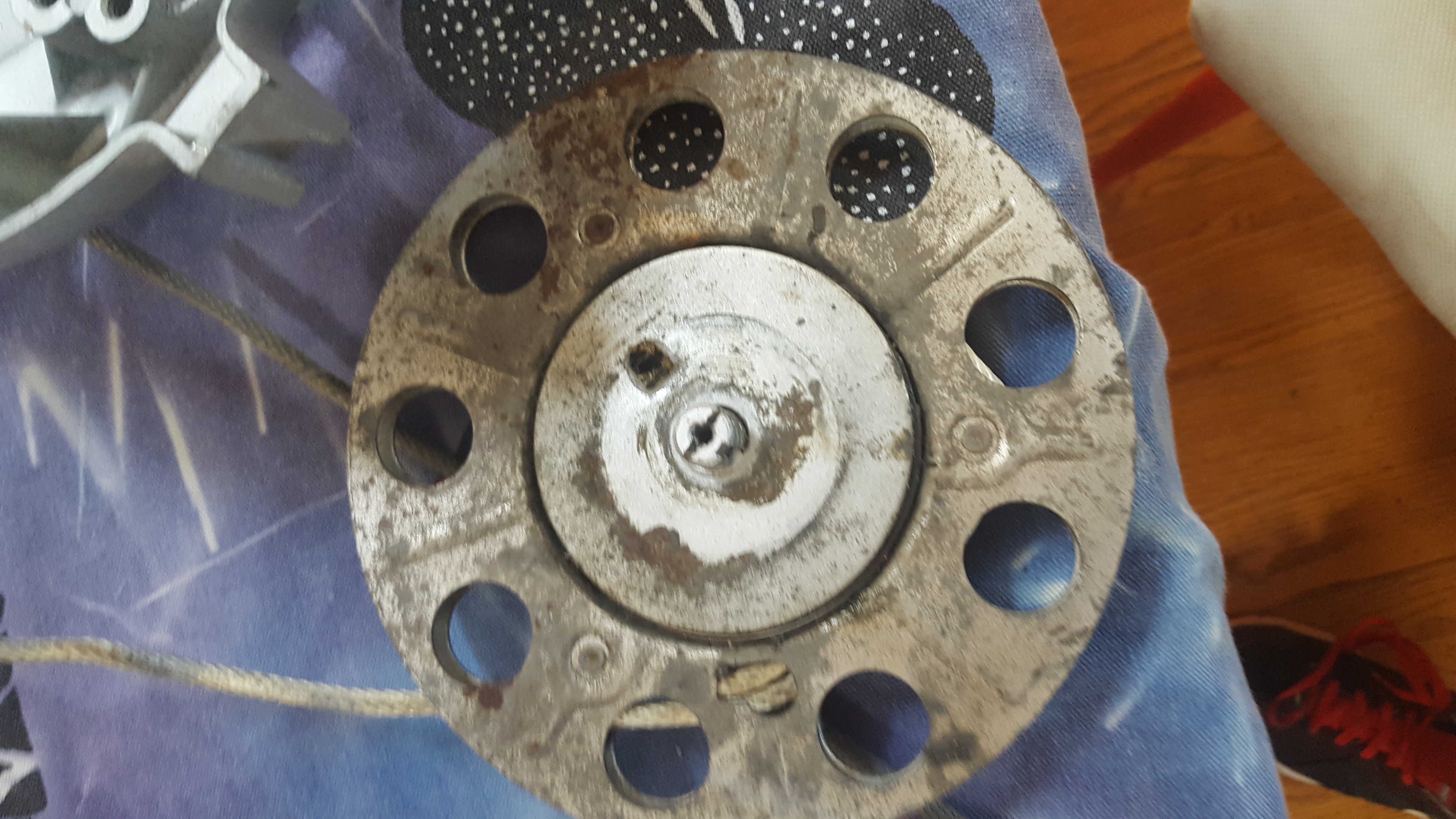

                      I think the problem is it has old grease in the spring how do I take it apart and clean in?
                      #60613
                      CHUCK WEBSTER
                        If the recoil spring is broken you need to replace it or repair it. I have been able to rebend the spring by heating it and then bending to fit the posts on the recoil. If you try to clean the spring, be careful it does not pop out of the top. Good luck
