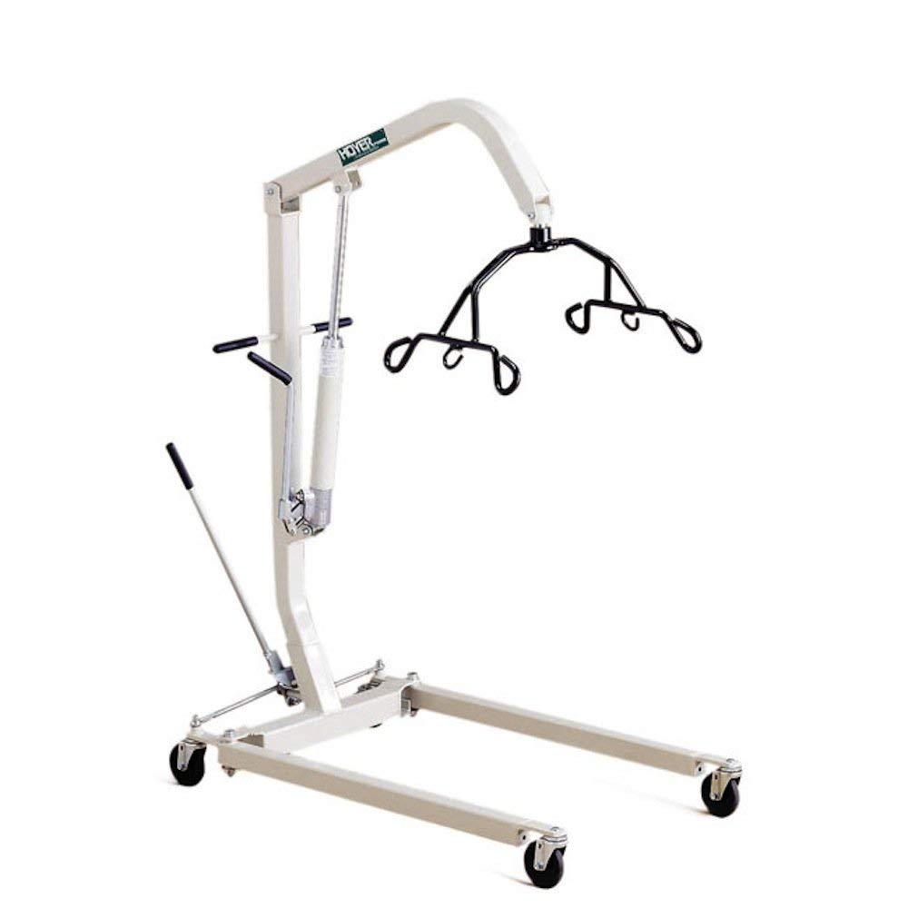

        bill-loveland
          I bought two of these – Hoyer hydraulic patient hoist – on craigslist last winter – $100 for the pair, virtually new. They’re rated for 450 pounds and break down into easily manageable pieces. Very handy for lifting big outboards, or maneuvering motors into position, such as the cast iron Kohler on my garden tractor.
