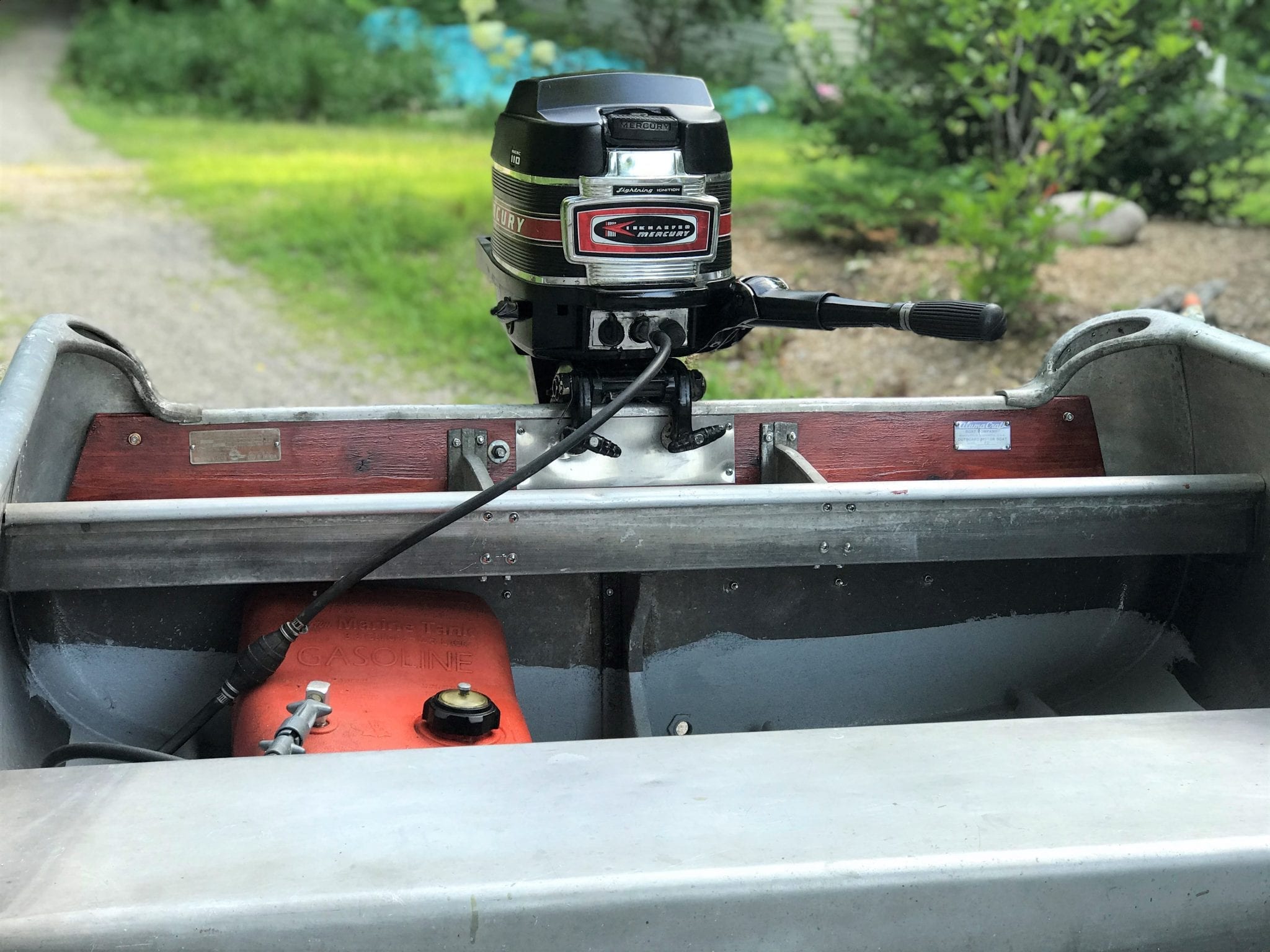

      Should it the tell tale get pretty hot on a 1969 110, 9.8 hp? I recently had the water pump replaced at the marine shop as I’ve only worked on Johnson and Evinrude’s and spending most of my time restoring my Alumacraft FD that accompanied the motor when I bought the combo. Anyway, it still runs hot after the replacement at full throttle and lukewarm at idling and low speeds. It cools down pretty quick when I lower the speed but it concerns me a bit. Should it even be warm at any speed, I don’t know Mercury’s much at all. I ran the boat and motor at various speeds tonight for half an hour and everything performed well except that tell tale.

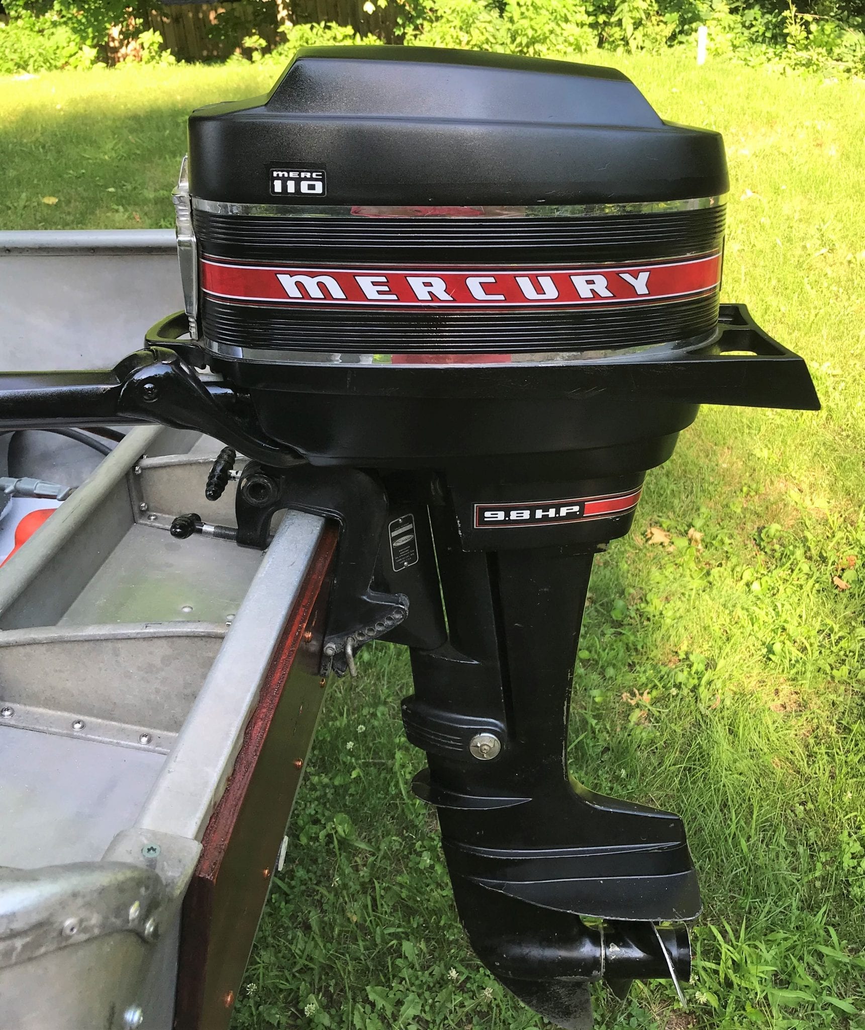

            Thanks need2fish and fleetwin. The marine shop I go to for all my supplies like gear oil, grease, and such, thought it was running good after they made the repairs and ran it in their tank. They barely charged me anything to replace the pump. They looked it over and found leaky fuel lines and replaced those and “made” new nipples as they couldn’t find those parts any longer. And they replaced the kill switch. Told me the gear oil looked great. I knew the previous owner had just changed. I suppose I could ask the shop too but they really aren’t specialists in older motors, just newer Mercs.
            It is a beautiful motor. I bought the boat for the boat but I really like the motor. It runs like a rocket, especially if it’s just 1-2 people. But it trolls down nice to next to nothing too.

                Thanks BillW. My son and I taped everything good, scuffed, sanded and rattle canned everything above that 9.8 decal with original mercury phantom black. Not a perfect job but it looks great. It was pretty nicked up up top at first.

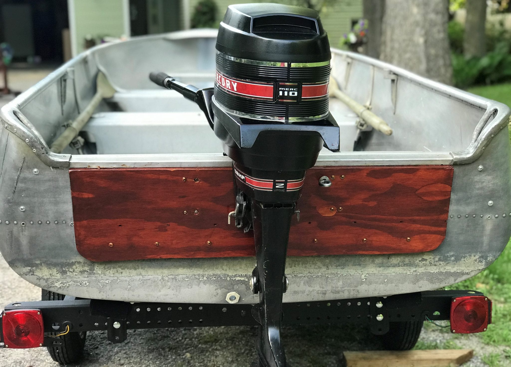

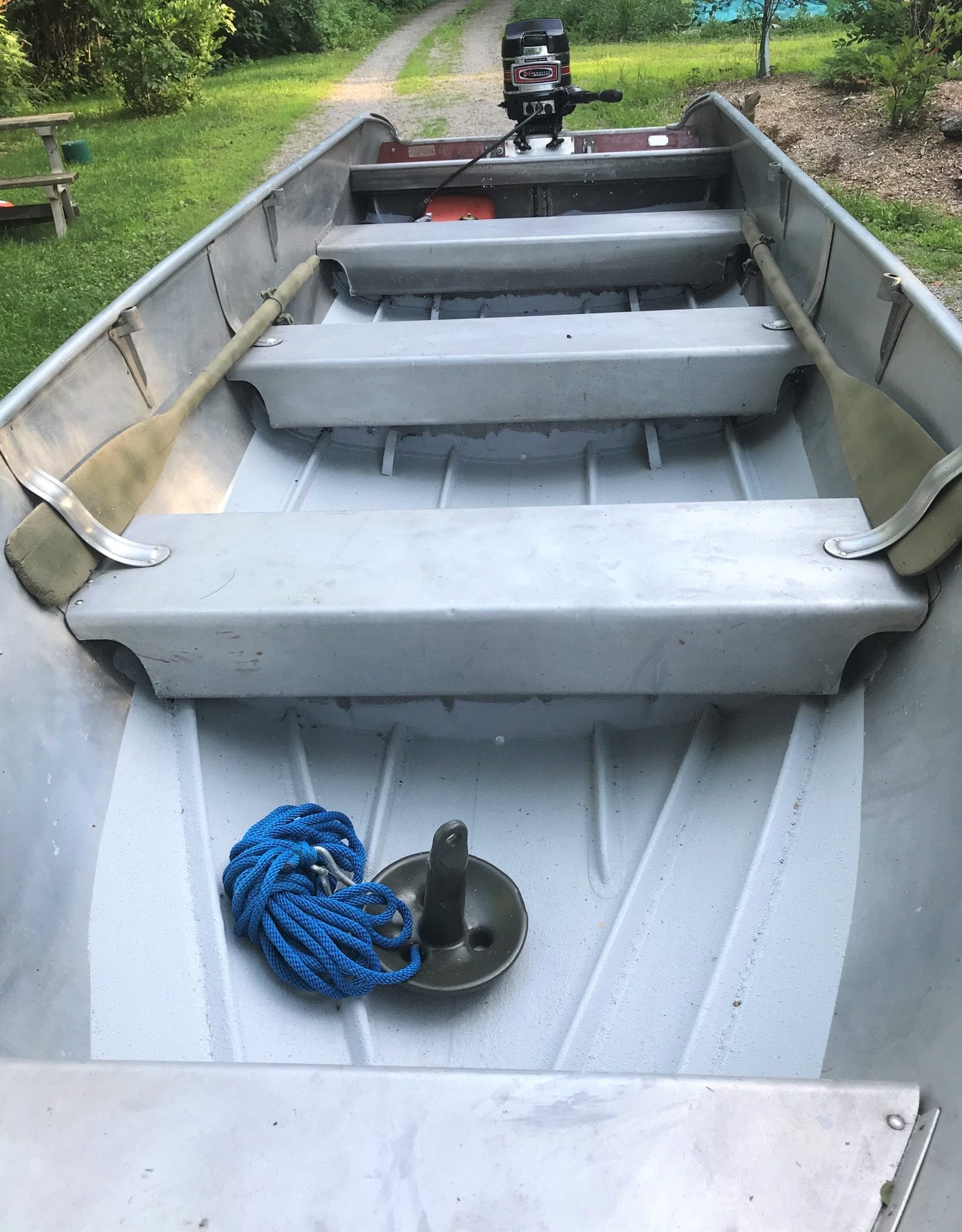

                      Thanks fleetwin and tubs. There were lots of nicks and scratches down to the original primer. It was OK as is but thought I would try a simple “touch-up.” In reading the Mercury paint can, I realize we could have, should have used a clear coat on top for best results. But we’ll see how she does. Right now, it sits on a lift and I use an old Weber kettle cover cinched down over it to protect the top half from the sun and rain. Here are a few more pics of the motor and boat. From the back and the inside paint job we did. Re-riveted where necessary. Then expoxied all the floor rivets and seams with Gluvit and then two coats of primer and 3 coats of non-skid rubberized Tuff Coat. I’ll tell you, drilling out all those aqueduct transom rivets was a careful, tedious job. They were replaced with stainless steel bolts, washers and lock nuts.
