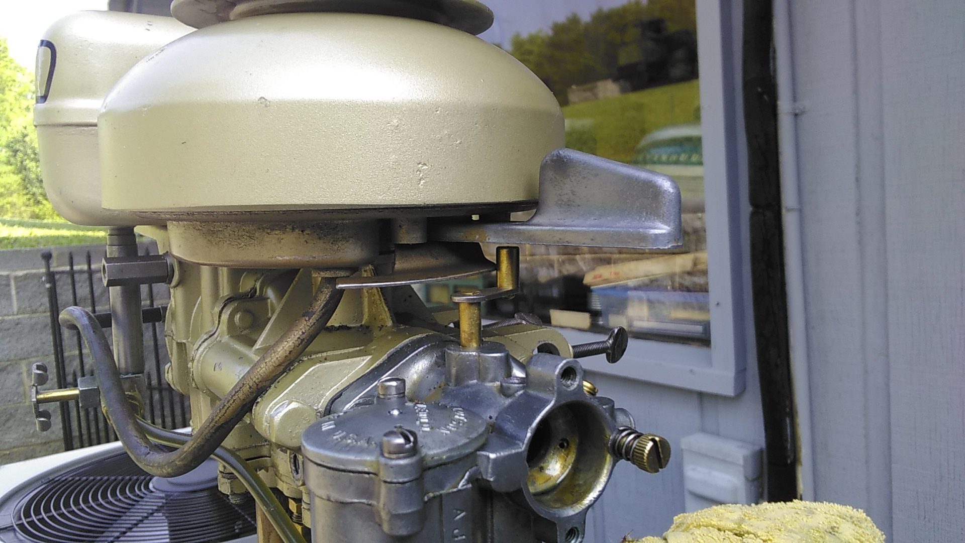

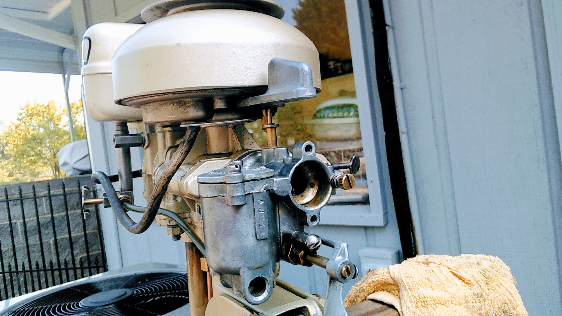

      I bought this little motor about a year ago and just now started working on it. It’s a single cylinder model WC1 from the 60’s. Looks like new. Has good spark, compression 65psi+. I cleaned the carb and she fires right up, and idles fine. However, when I push the throttle lever to speed it up, she dies. Seems like a link and sync issue. I looked at the throttle cam and it almost looks like its mounted wrong with the gradual increase part of the cam trailing instead of leading if that makes sense. When I advance the throttle from idle, it only takes a small push of the throttle to completely open the carb butterfly. Pictures attached. It looks like there is no adjustments on the cam, and I tried turning it around but there is no other way to mount it. Anyone have any experience with this motor?
      #276444
      lindy46
        First pic shows it at idle, and second pic shows throttle nudged a little to the right.  Note carb roller butterfly goes from closed to wide open. The blunt edge of the cam is leading and immediately pushes the carb throttle lever all the way open.
