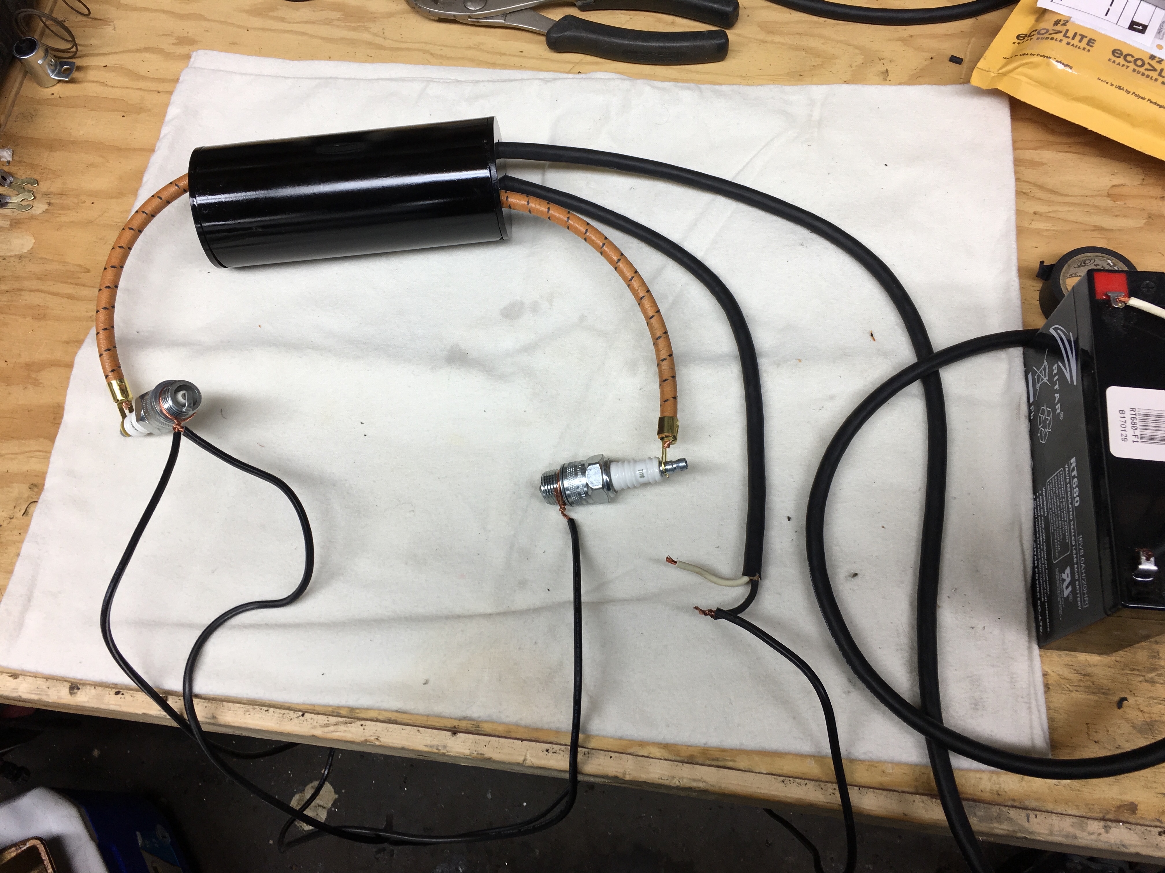

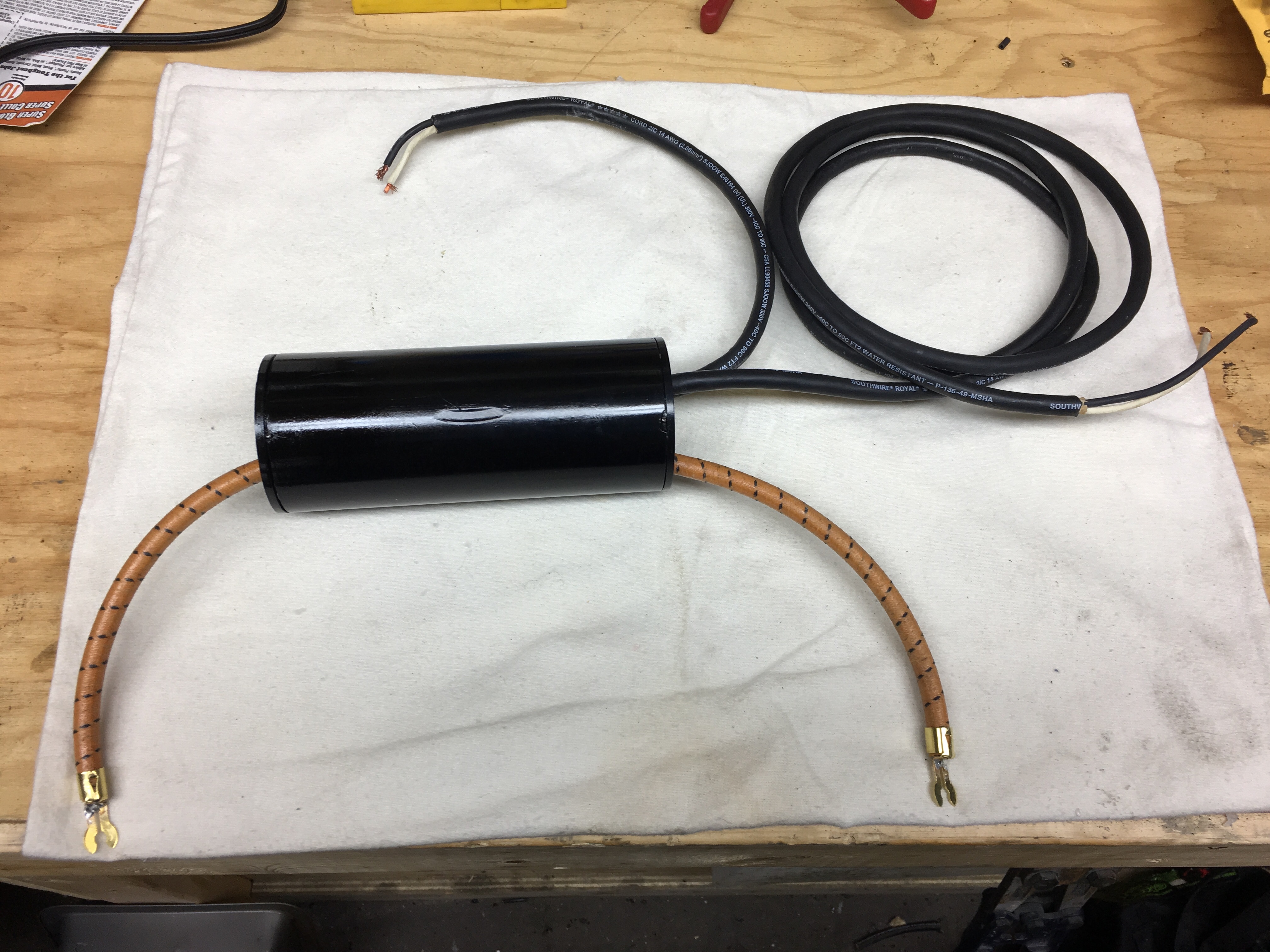

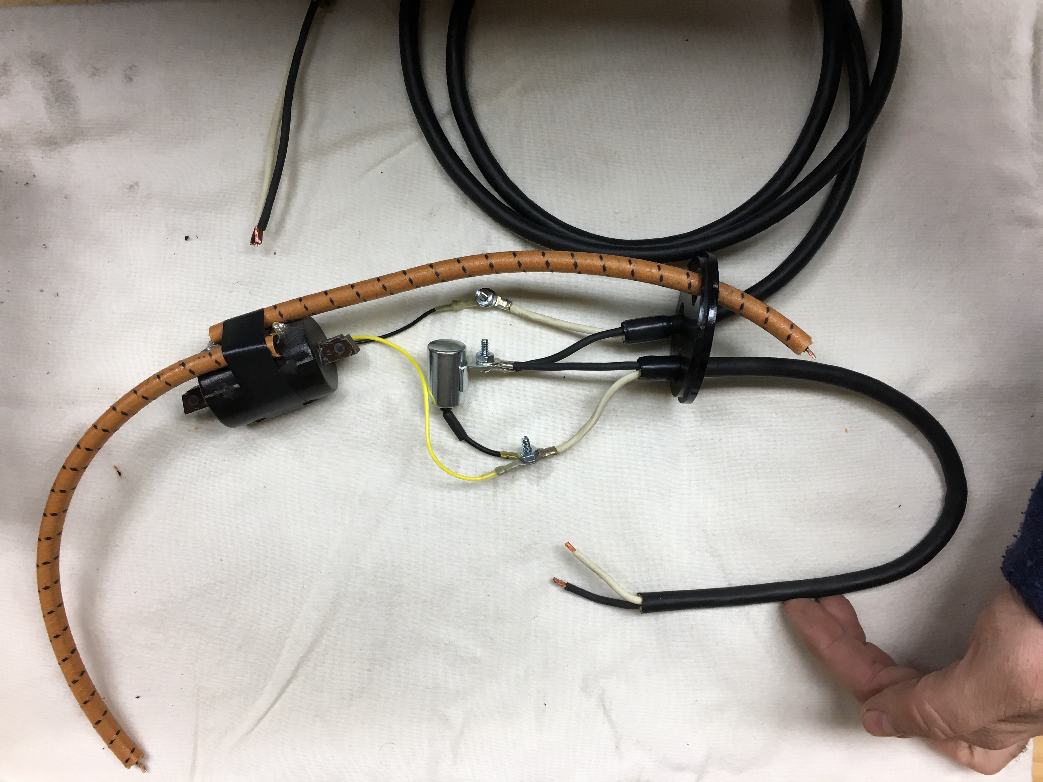

      Today I finished rebuilding some coils for early ELTO’s. I used the same coils seen in a Caille ignition rebuild article that was published in a recent issue of the Antique Outboarder. The coils are reasonably priced and are military spec so they should last a while. The coils require a condenser of .25 uf, which I decided was close enough to the .22 uf condensers used in the OMC universal ignition. The bench test was positive with a nice spark.
      UPDATE: I have run the rebuilt coil on my 1928 Speedster and it works flawlessly.

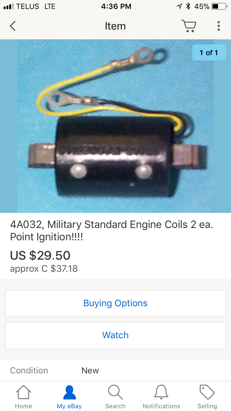

                    #69732
                    dan-in-tn
                      The Saturn link works, but it’s for 2014 date. When I tried to get to their checkout I couldn’t get anywhere? A little checking on eBay put me on this link:
                      https://www.ebay.com/itm/2-SPARK-IGNITI … 1438.l2649
                      Seems to be the same coil? 3/8" laminates, but that is not a problem for battery ignition, right? This is the Standard Ignition Co. outboardnut refers to from time to time I believe. I didn’t think they would sell to the public? I have contacted them before. Times are a changing, maybe?
