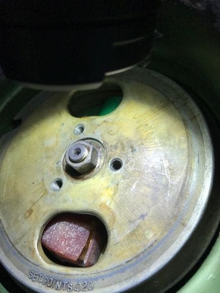

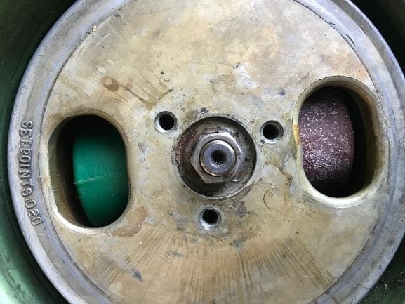

      If the motor is running that good, it probably doesn’t need new ignition parts. You can remove the cover on top of the flywheel and have a look without removing the flywheel. When they “serviced” the motor for $120, what did they do?
      #181878
      Yellowstone
        They reassembled the recoil correctly, installed a missing spring and new rope, put new spark plugs in, checked the gear lube and replaced it, and ran the motor in the tank for awhile. So I see what you mean now. Just ran out there and removed the thin plate, which I had failed to realize I could before it was stuck on there so good. One coil looks brand new. Other is shot.
        #181879

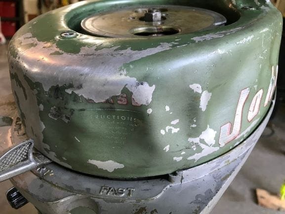

        Yellowstone
          So here are a few photos of the coils and the dents up front. I may just leave the latter if this is our trusty duck motor.

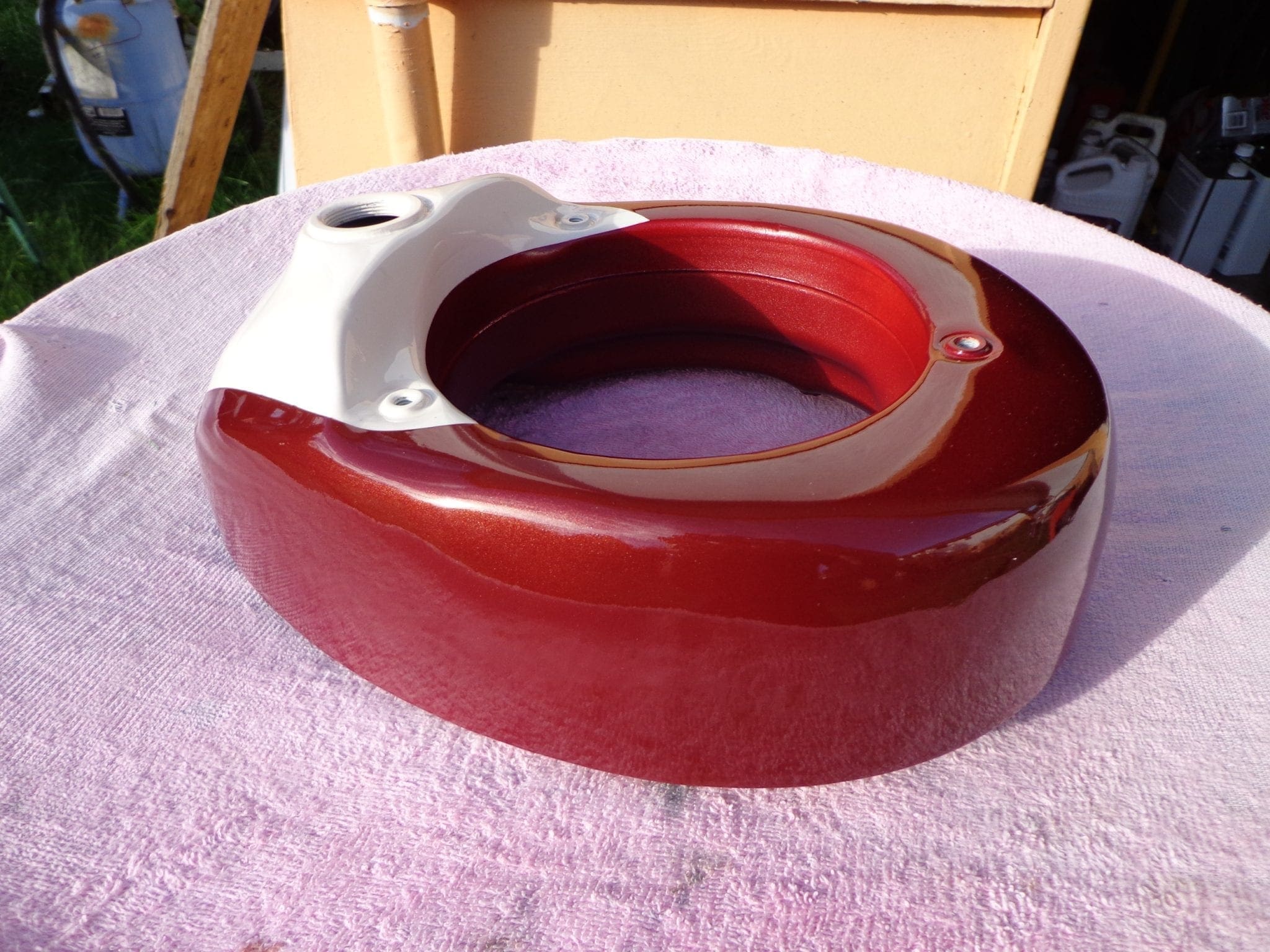

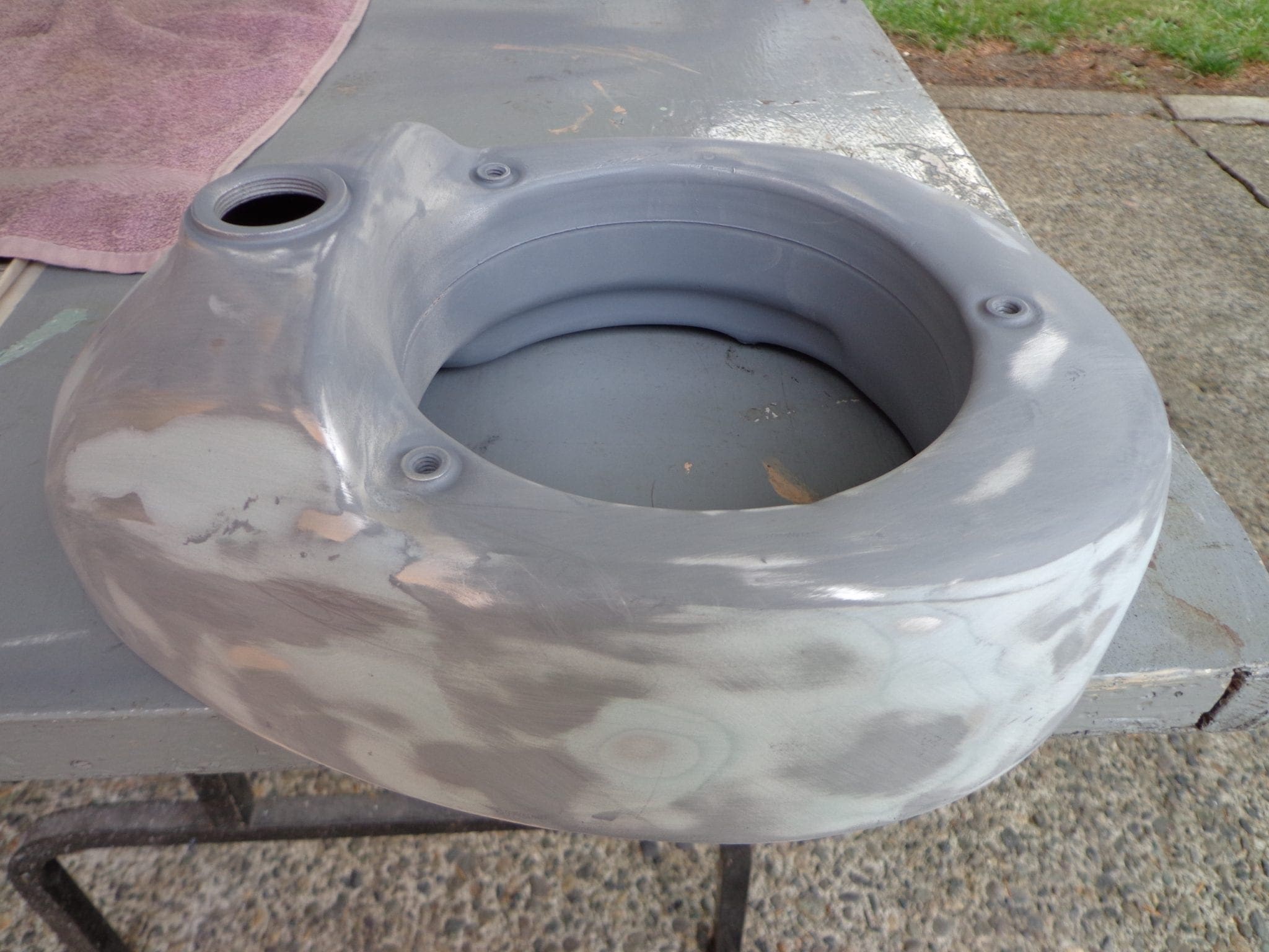

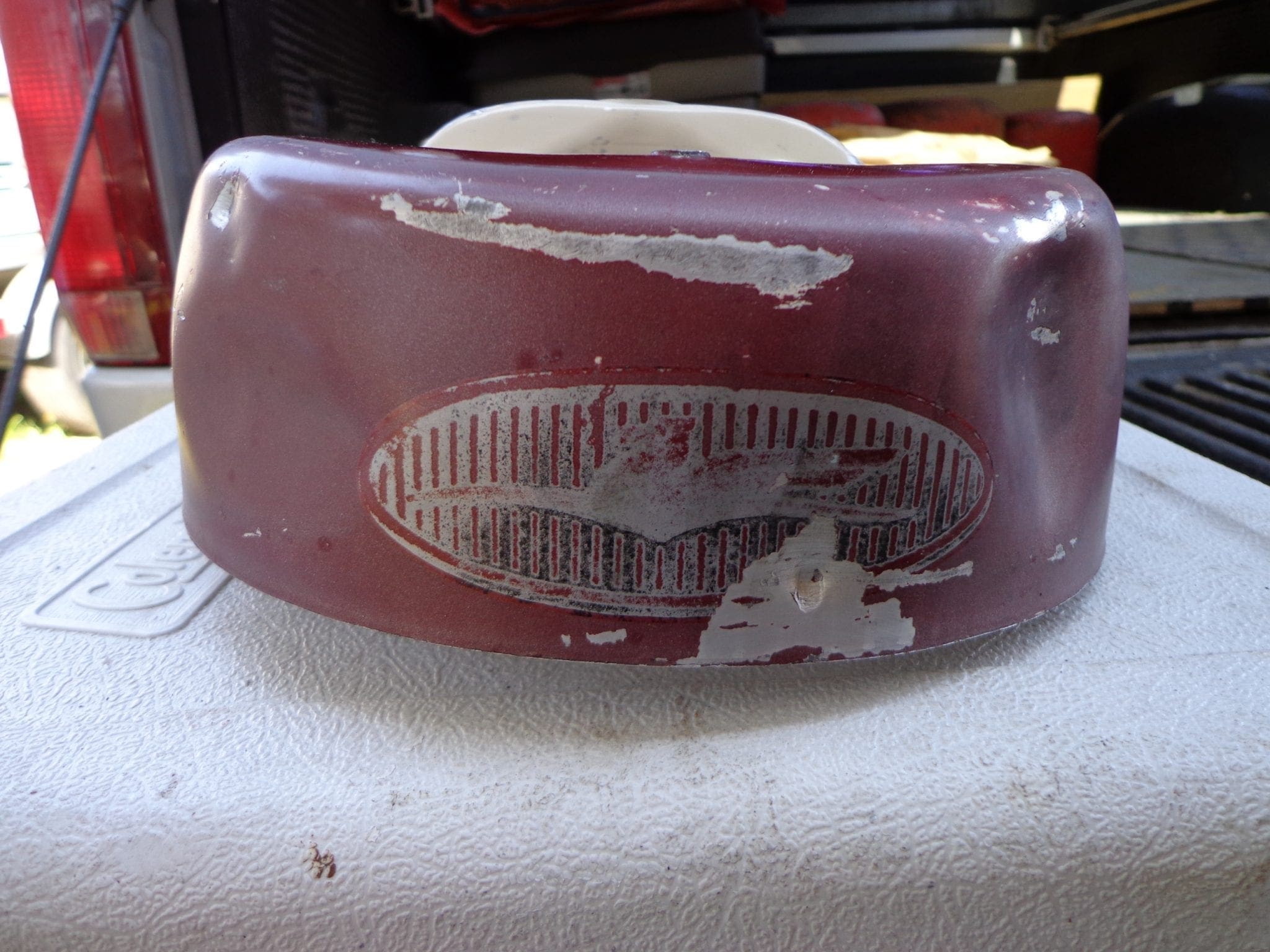

          #181884
            A dented tank is almost mandatory on an original JW or Lightwin. If you are doing a cosmetic cleanup, the dents can be hidden.

                The JW series of engines is what helped make OMC/Johnson great….That engine is simple, easy to work on, and most parts are available either new or used. I wouldn’t bother trying to refinish the engine, the original patina looks great and I don’t think you will get the dents out of the tank…

                  Yep, that coil is shot, am surprised it is sparking on that cylinder at all…Have a look at your service book, or ask here before tackling the ignition job…This job isn’t too hard, but there are some things you will need to know, and some tools you will have to add to your collection…The nice part of these tools is that they are used on most OMC universal magneto engines from the early 50s right up to the late 90s….

                      Yellowstone
                        Thanks! I ordered a new coil (should be here today) and a tune-up kit with the points, etc. I have been looking through the service manual Mumbles sent and other videos and instructional pages. My biggest challenge to date was the flywheel. I couldn’t get the strap wrench to hold snug or really get it around the wheel well enough to do so. So I improvised and used some strong, thing rope, wound it around and snug against the notch and tied it to the motor stand in a way that made the wheel non-mobile. Then I got the nut off. Tonight, I have to get some 1/4 inch bolts for the flywheel puller I bought as no bolts in the kit I bought match up. Actually had some but found they are to short. They don’t get enough of a hold for it to work. Video I watched said the flywheel release can be “explosive” if not done for awhile so trying not to flinch when I do it. Ha.
