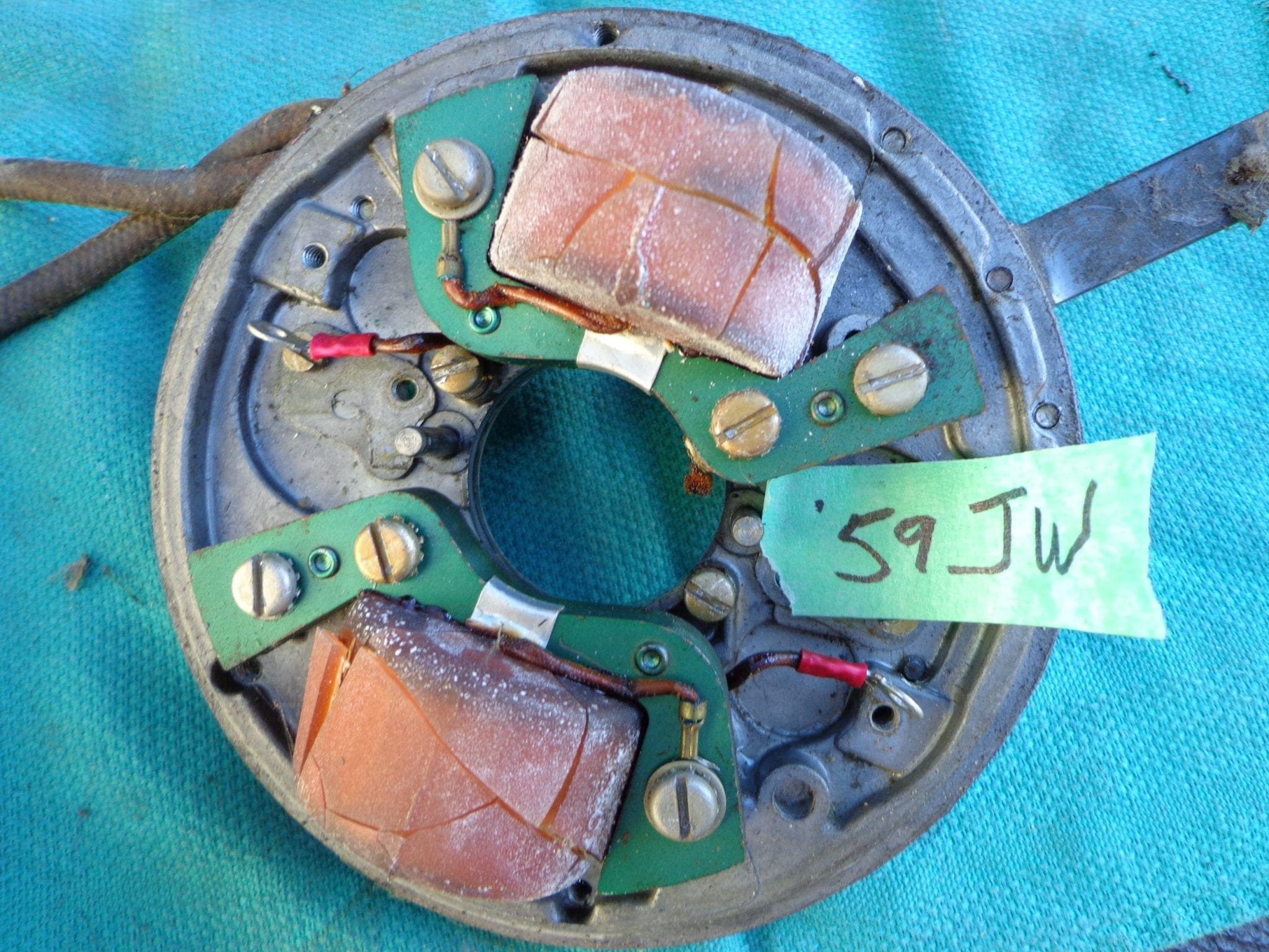

        One thing you are going to discover quickly is the coils used in the magnetos on any of these older motor will be deteriorated and be cracked from age requiring replacement. Sprucing up the ignition system with new coils, points, plugs, and condensers will help it spark while a carb kit and impeller will help it run smoothly and keep cool. One thing which should be done before spending any money on a motor is to take a compression test with a reliable compression tester. The numbers obtained will give a good indication of the motors health.
        Here’s what bad coils look like.
        1959-JW-Coils
