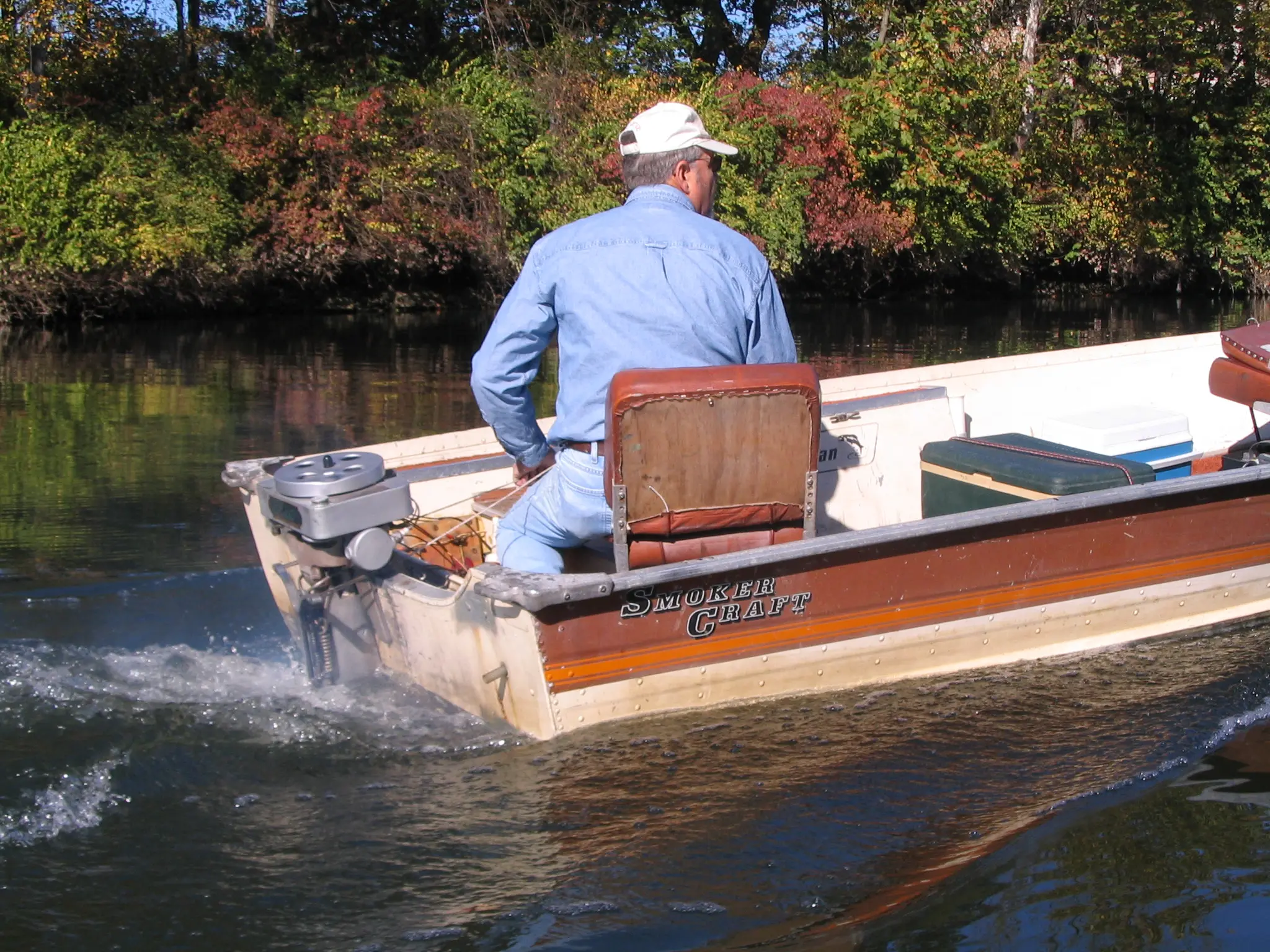

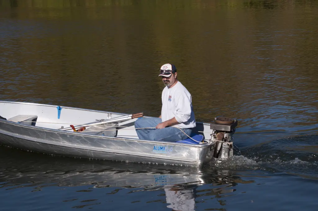

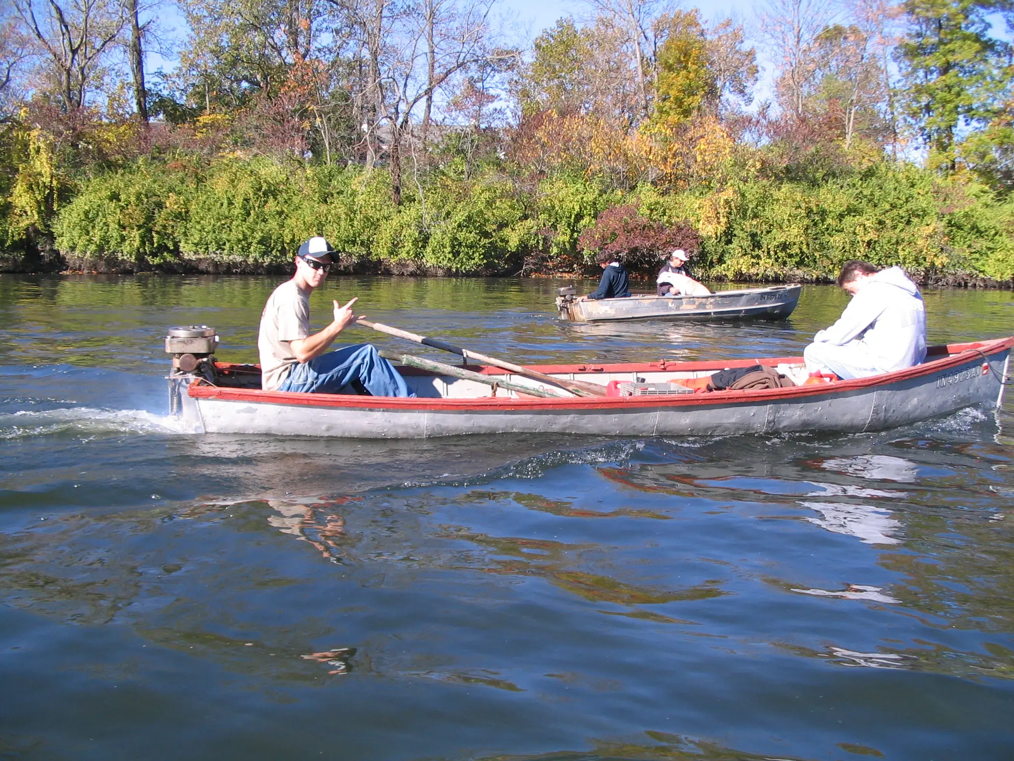

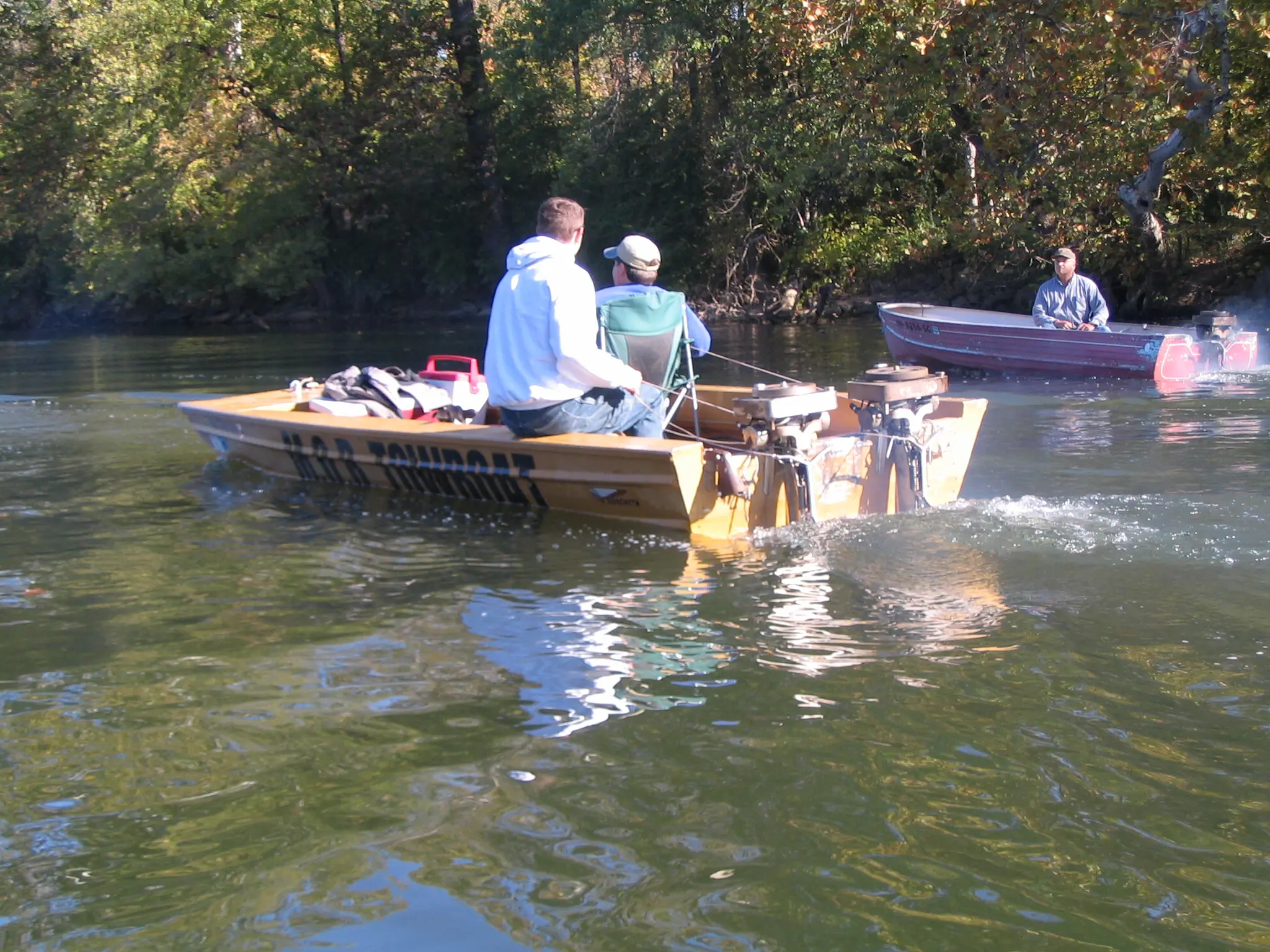

          Good morning. The motor spins in a clockwise direction, these Eltos use a LH rotation propeller.
          It is a 1927 motor, as ’27 was the first year for the J (they did offer them in 1928 as well)
          The gas tanks on those were provided from the factory with a finish known as “Terne plating”, which is a lead-tin alloy that is no longer used. Some folks have nickel or even chrome plated those tanks. I strongly recommend against that. Not only is plating them expensive, but it will show up every flaw, dent, or wrinkle that you didn’t notice before it was plated. Common practice now when redoing a motor is to paint them silver.
          The eyelets are for control cables or cords that allow the timing to be adjusted from a remote area of the boat. YOu could run a control cord thru each eyelet and tie the ends to the timer, as there is a hole in the timer handle for just that purpose. Coupled with the rope steering, this gave the operator a choice of sitting further away from the motor itself, thereby enjoying a quieter ride and possibly getting out of the smoke trail. Fortunately, these Elto motors typically run well enough to allow a boater to sit further away from the transom and not have to sit next to it to make constant adjustments.
          Hope this helps.

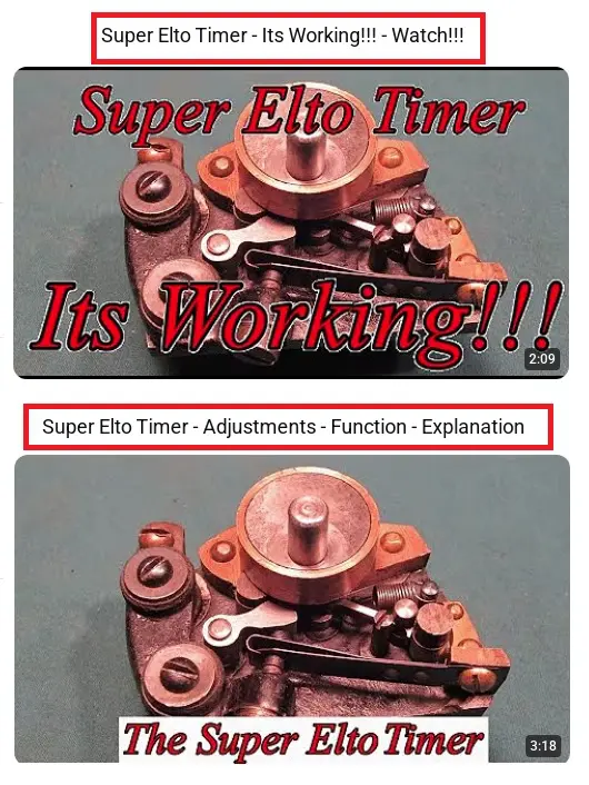

            They will actually run in both directions. Here is a link to starting mine. https://youtu.be/hKX0mZji7aA  To run forward, you spin the flywheel counterclockwise. If you have the everything set properly, the sparkplugs fire and the motor takes off, running clockwise. Do the reverse, and it will run in reverse. Once you get familiar with your motor you’ll see how well this works. Too many links can make a post disappear.  If you search for the videos below it will give you some understanding of how the timer works.

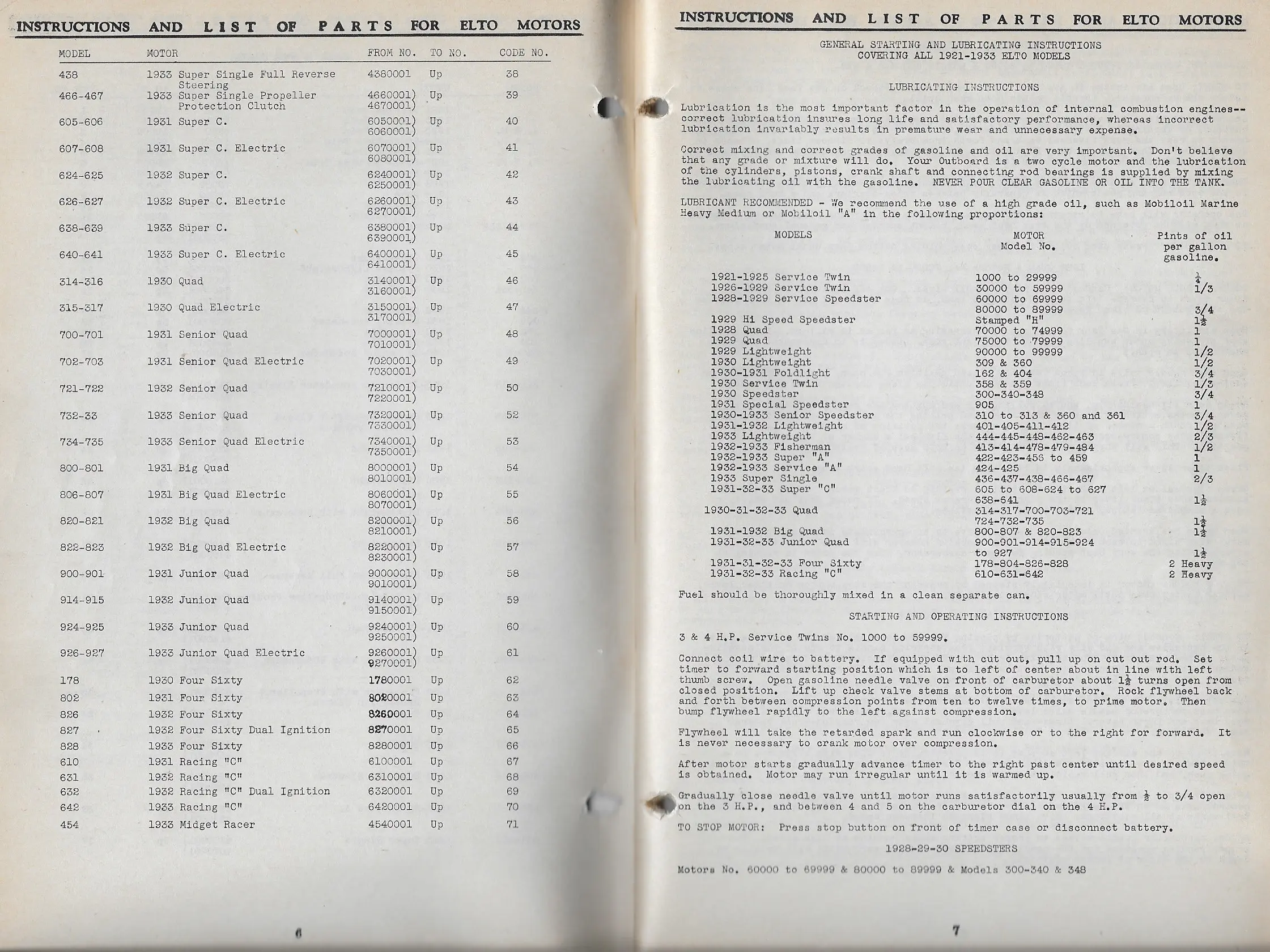

                    Just to be clear, when I do get to the point that I am ready to try to start it, I should ‘bump’ the flywheel back and forth off the compression a few times, and then flick it firmly CLOCKWISE?  Is that correct?

                      Starting instructions for your motor are included in the attached scan.
