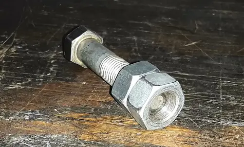

                      #311316
                        Get 2 nuts and a bolt. Tighten the nuts against each other .  Its important to be lifting up on the flywheel and the tool remains tight. Video Link –     https://youtu.be/RWgE9XiIBnk?si=OWRQKqmTPazplPCR
                        Tool
