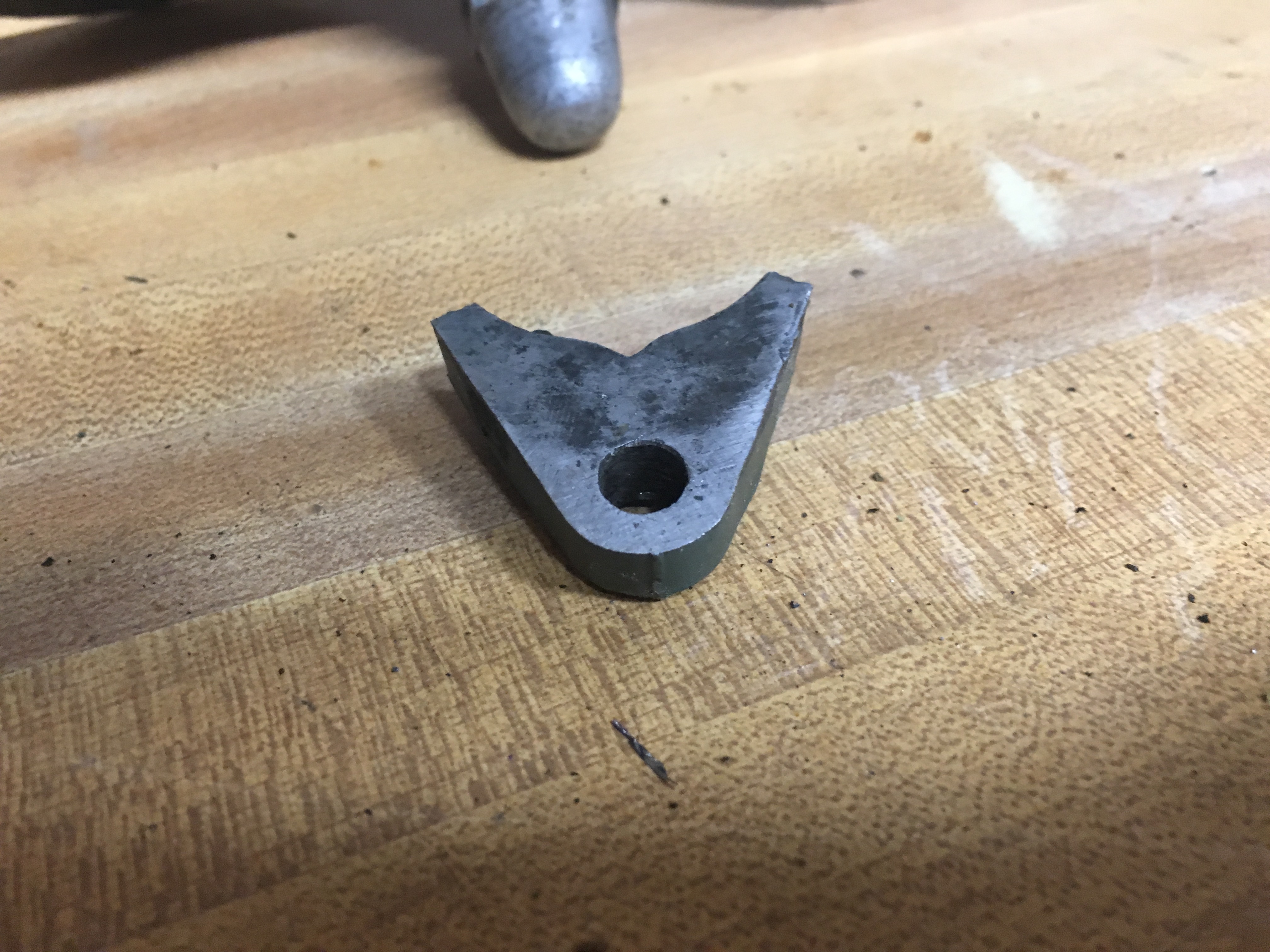

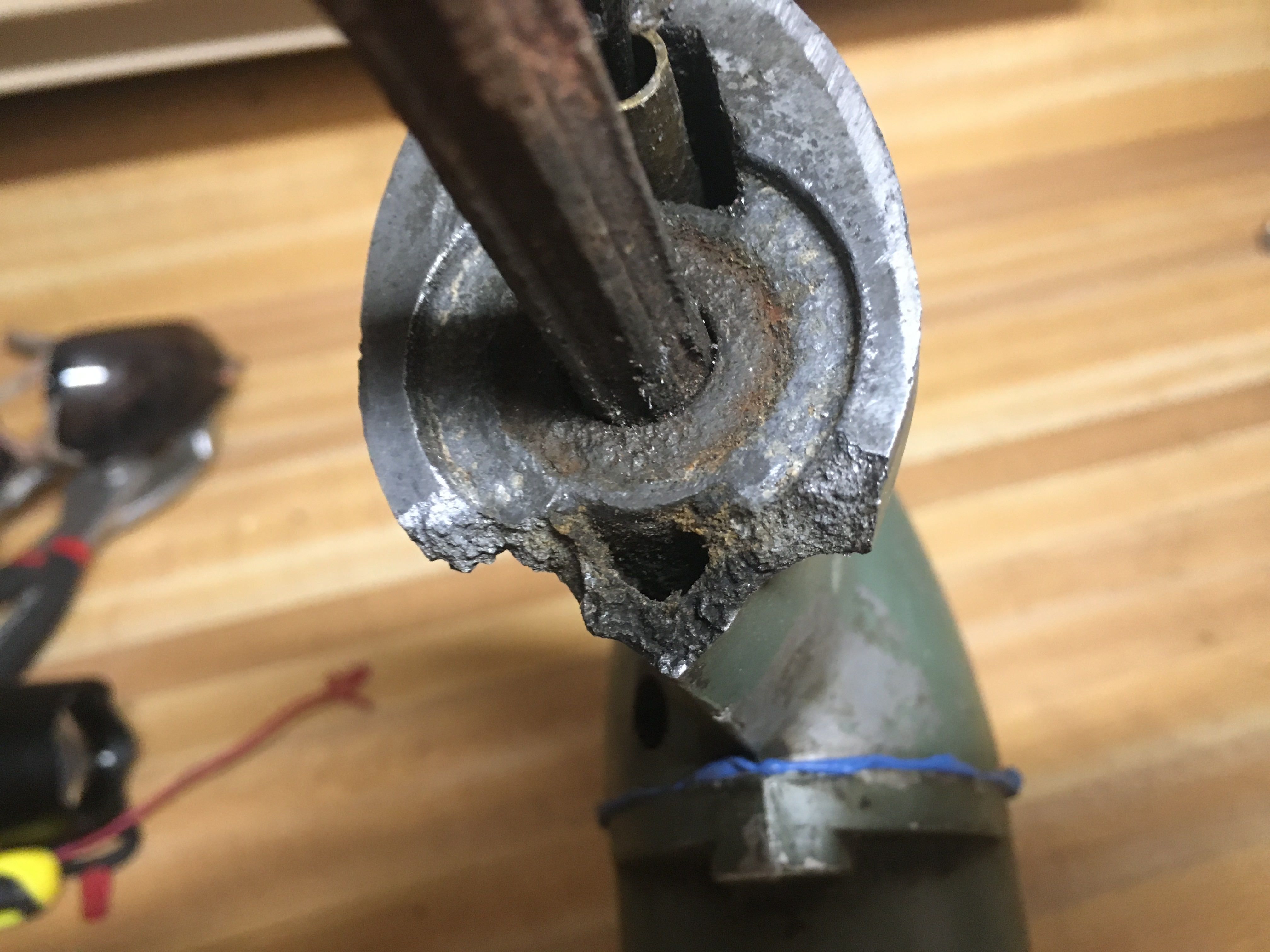

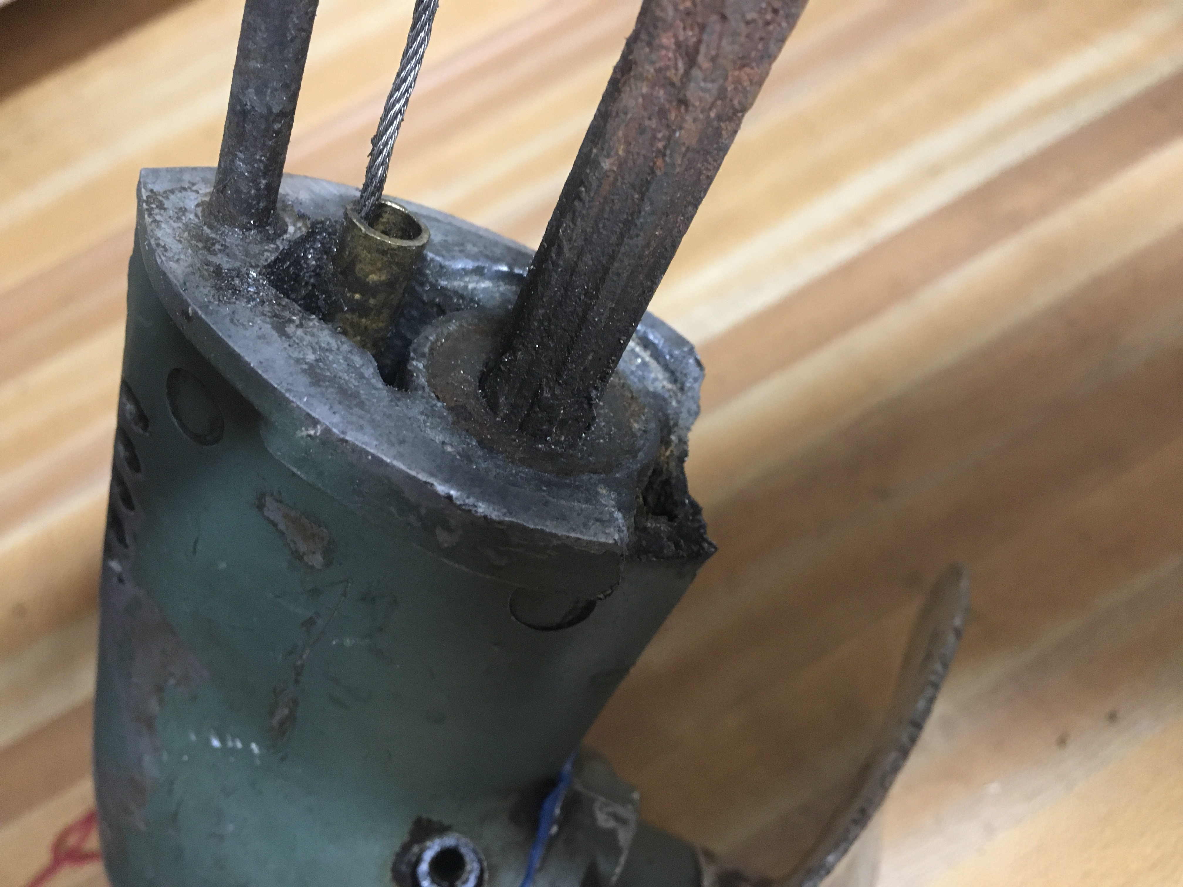

      I recently was changing an impeller on my Elgin 5.5hp, when I over tightened the bolt that holds the gear case onto the lower unit, and I forgot about a hairline crack that it had in it to start, and to my luck it broke off. Any suggestions of where I can find another gear case, or of a simple but reliable repair? Thanks.

          #67417
          chas56x
            Take the broken parts to a propeller repair shop. They can weld the broken part back on.

                #67466
                20mercman
                  JW, your welder must have been having a poor day….. 🙄 I have welded lots of lower unit cases. The case on my "Johnny Cash" Mk-25 had the gear sticking out the side of the case. It runs great now!
                  These all have a lot of oil soaked into the aluminum. Also, I think a lot of our post war motors were melted down B-17’s and etc. They were not the best castings, and when you weld, the impurities will boil out. You have to just grind it off and try again. That may be what he was trying to do with the rose bud, burn out the oils etc., but he got carried away.
