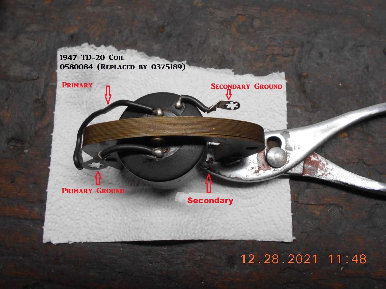

April 10, 2023 at 9:29 am #275027
As noted in your picture these coil have 2
grounds. Be careful with them. The solder
connections can break free (become loose)
very easily on this coil and there is no
known substitute for them as the OMC style
coil is to large.
TubsA "Boathouse Repair" is one thats done without having tools or the skills to do it properly.
coil is to large.

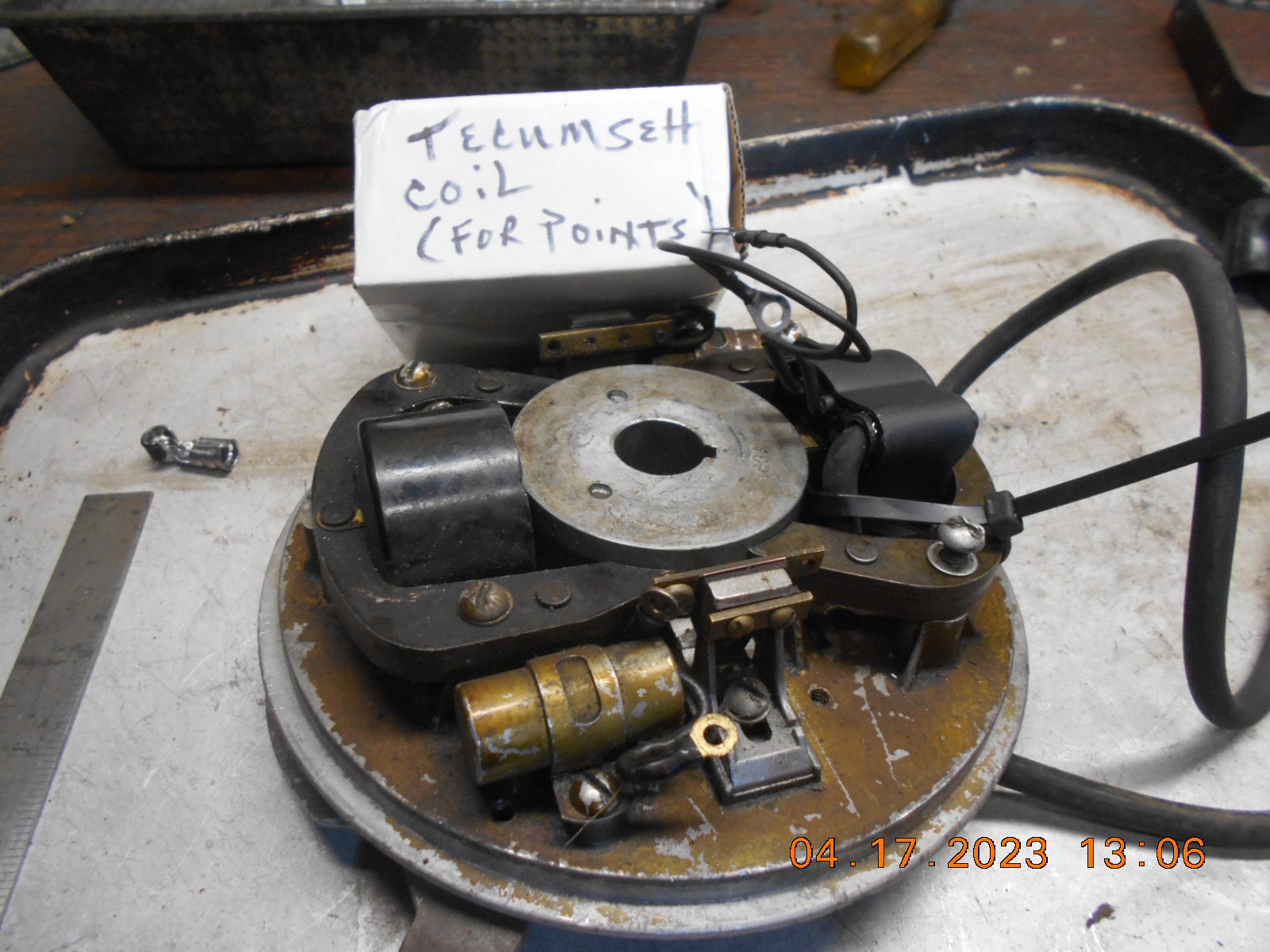

April 17, 2023 at 10:08 pm #275258I ended up ordering a couple of those cheap, aftermarket coils for
Tecumseh engines. They’re a little loose on the laminations,
and with the way they’re made with the secondary tower
shooting out the end of the coil, they end up 3/16″ taller than
the original coils.
I would have to tear the Sea King back apart to see if the flywheel
would clear.I mocked up one of the Tecumseh coils on a Gale mag plate that
was loose.
The plug wire would rub on the rotating magnet, unless it’s “bound back”
like in the photo, with a tie wrap.
When I get in the mood, I’ll probably investigate some more,
with the possibility of these working for a coil swap.The best part about these coils is that they only cost me $29.27
for “two”, with free shipping, off of EBay.(Ignition Coil For Tecumseh 30546 30560A 30547A 30548B 29632 610768 Lawn Mower)
