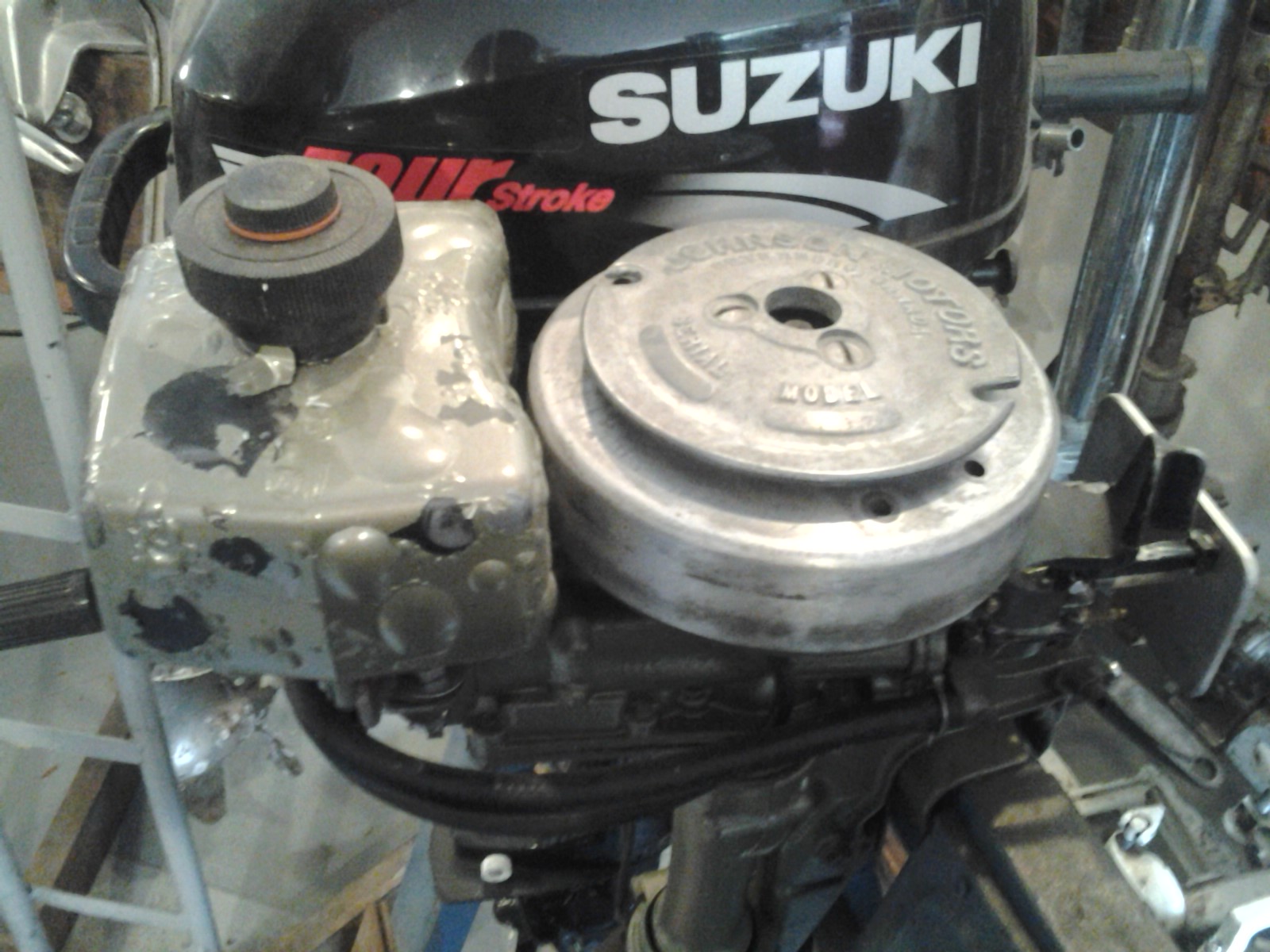

                      #69162
                        This wouldn’t be the first time someone has used whatever’s handy to get a motor running. A long time ago someone posted this running 70’s two horse with an early flywheel on it.
