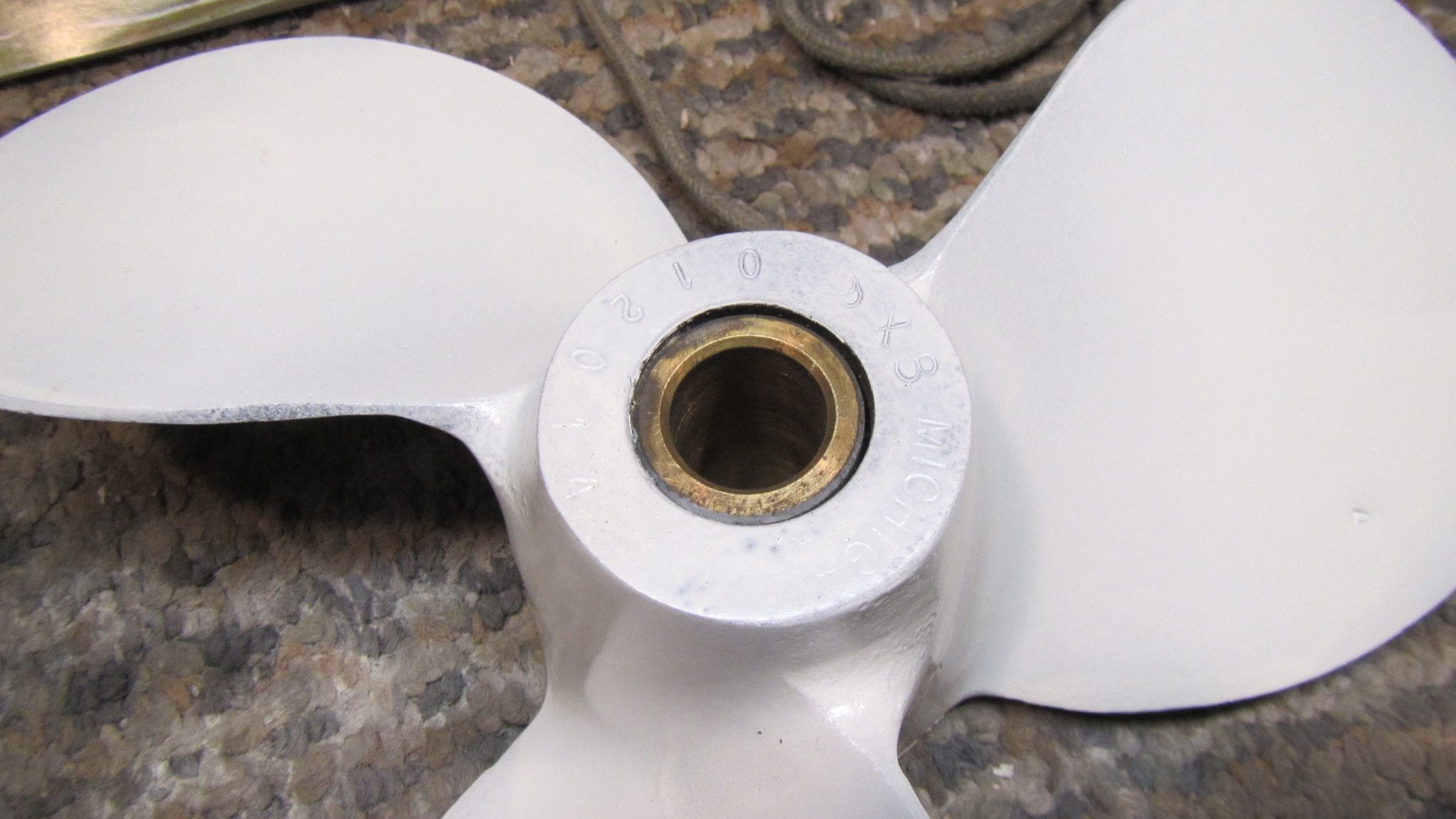

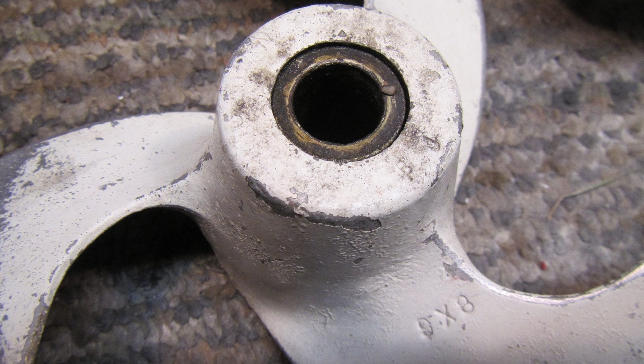

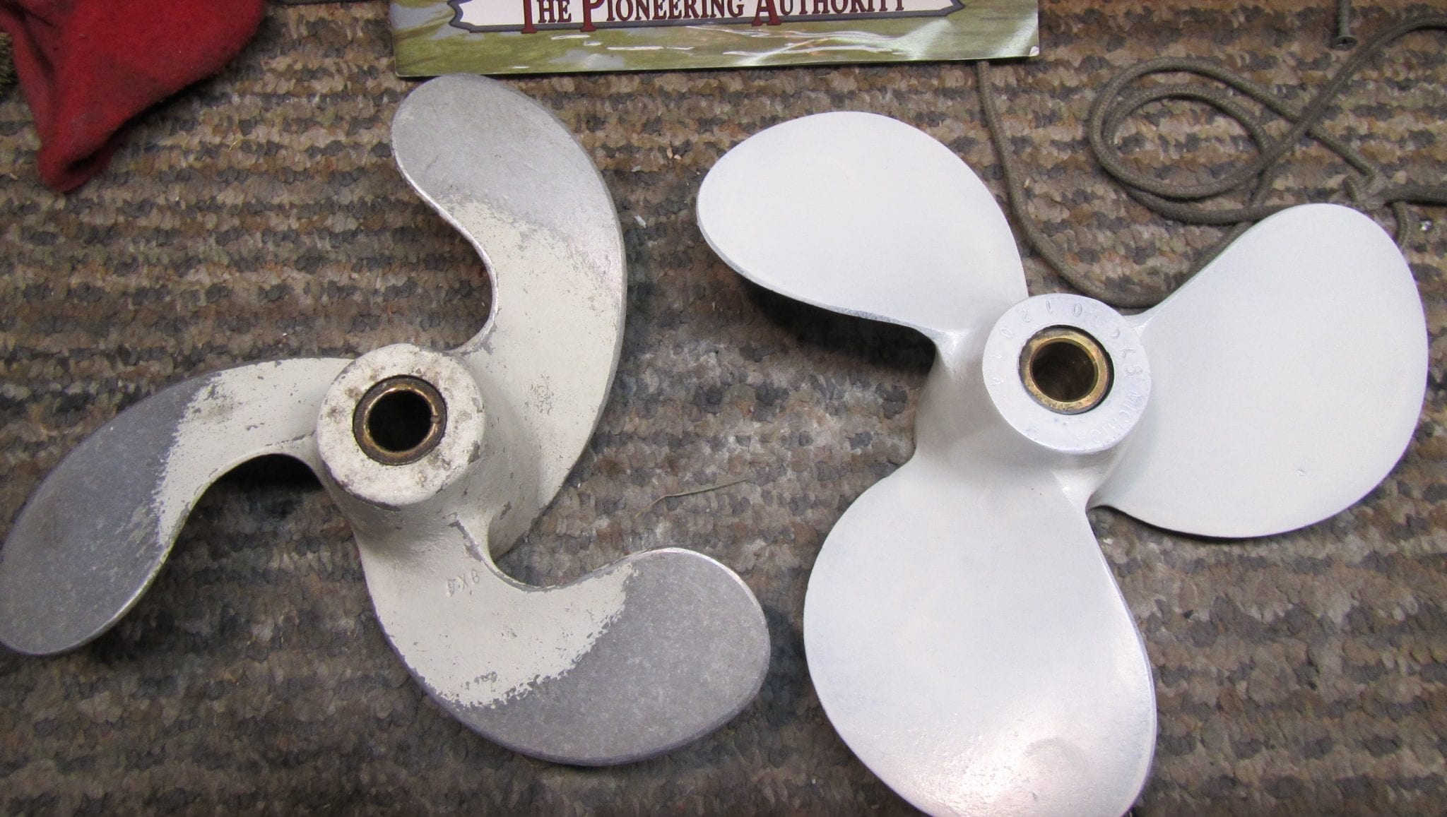

      I want to ask the vast knowledge out there in cyber land which of these propellers will perform better? Early fifty’s OMC motors 10hp and up all had a propeller that was suppose to be weedless. I found a propeller on the shelf at my prop doctor welding shop. With the same diameter and pitch that I usually run on the 10hp OMC that I have around here. It has much wider paddles. How is this wide paddle guy gonna perform? The weedless propeller pushes my 14′ MirroCraft about 19 MPH. Any Guesses?
      dale
      Both have same pitch and diamiter er
      IMG_0003-1
      IMG_0004-1

        Michigan lists that prop for 15-25 hp for 16-18ft boats heavy load. I think it would have your 10-hp gasping for breath.
        #197784
          Are both of those props for 10hp, 1957 and older? If so, they also fit 15,18,20,25hp which explains why it is for heavy boats. But 9 x8 is appropriate for a 10hp on a 14″ Anyhoo, it is kind of hard to predict which will win without a sea trial. My bet is on the wide blade.
          If you run in weeds, you already know that weedless doesn’t shed weeds worth a hoot.

            Yes Frank, it fits all those motors you mentioned. I guess that a sea trial is the only way to find out. I am putting an 18 together right now. I have a 9×10 that I was saving to put on that motor. So called weedless prop. This wide paddle might work on the 18. I wish I could find a book about propellers. Something simple and informative. Pine tree guys managed to get 30mph from a 15 OMC motor. Racers secret on how they did that! thanks

              I own and have run both of those props on my Evinrude 15012, and once they are below the surface of the water, and I can’t see them, I can not tell the difference. I carry one on board for a spare. They both run 28 mph on my Alumacraft. Have fun boating! R.T.

                The bottom one looks like it would have a bad hub.

                  RT your 15 does a little better than mine. I get about 22/23mph. Good to know how yours does. I don’t remember what prop is on my 15. But am gonna check!
