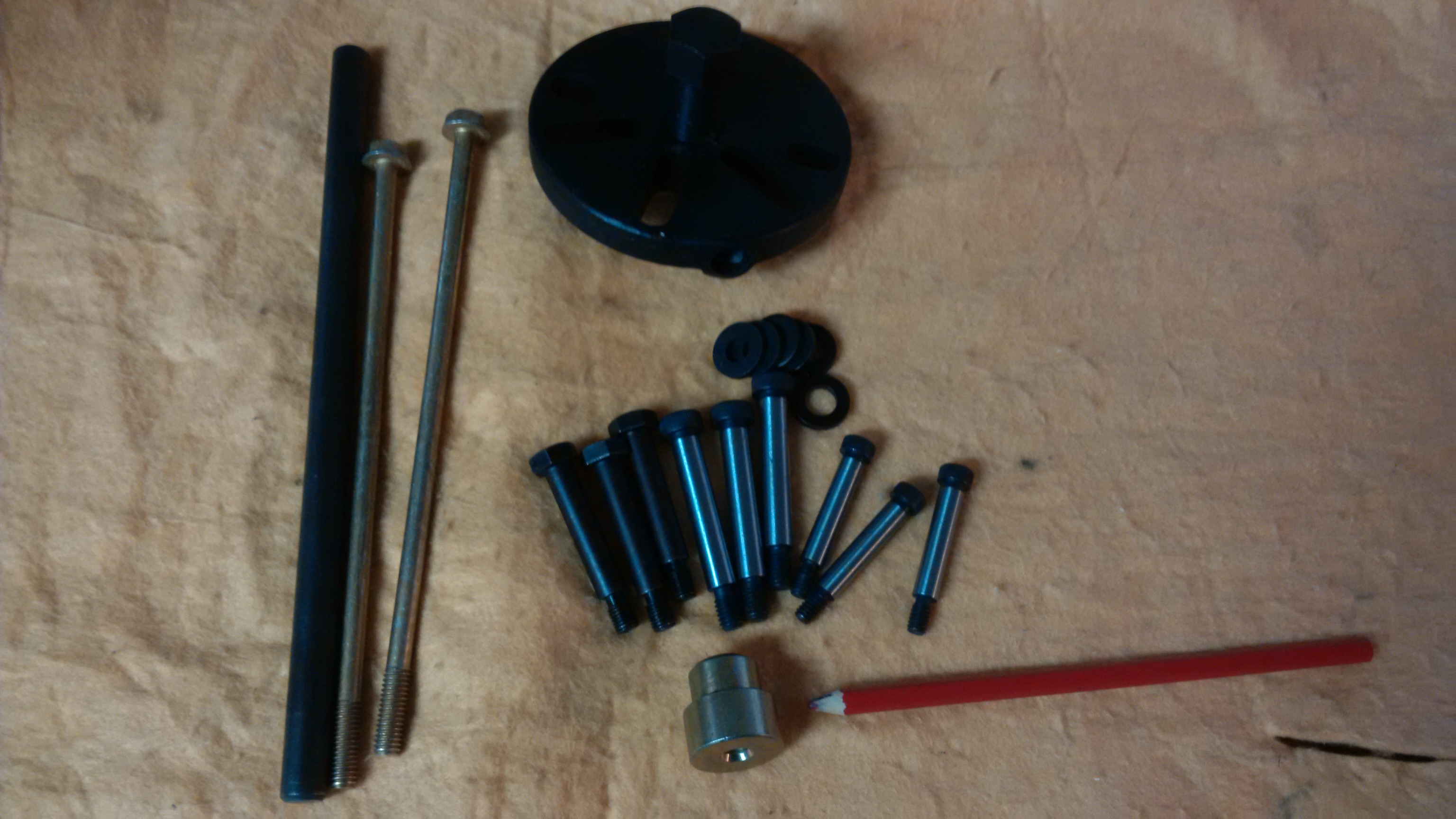

I just finished reading a couple of threads re: how great the OMC puller is for removing a flywheel that is as stubborn as the one is on my ’66 Ski Twin. Before I spend extra time and $ on an OMC puller, I’d like to know if anyone had better luck removing their flywheel using the OMC tool vs the one that Harbor Freight sells. I have been soaking the flywheel/crank interface with penetrating oil for several days while the puller bolt is under considerable pressure (administered by an impact gun) in addition to whacking the puller bolt a few times and heating the interface with a Bernzomatic until its hot to the touch.

July 25, 2016 at 1:21 am #40865What you sometimes need on the big crank motors like the one you have, is leverage on the wrench you have on the center puller bolt. I had to put a long 4′ piece of fence pipe on my wrench I had on the center bolt once to get one to crack.

July 25, 2016 at 1:31 am #40867I wedged a piece of wood between the flywheel teeth and the lifting eye so it wouldn’t turn using a 3′ pipe on a breaker bar. I left it under considerable pressure for about 48 hrs now.
Man, I HOPE the last guy that installed it didn’t use Loc-Tite.July 25, 2016 at 1:34 am #40868I just bought one from Crowley Marine, but haven’t had a chance to test it out yet. I have a ’69 Ski twin flywheel that gave me fits getting it off with the harmonic balancer puller. Broke a few # 8 bolts before it finally popped. I bet the OMC pull set would’ve made short work of it.

July 25, 2016 at 2:00 am #40874I don’t have the OMC puller or the HF puller. If I were to buy a puller for OMC flywheels I would buy the OMC puller. It is a very well made and perfect functioning tool. I made mine out of 1/2" steel pate. I use the center bolt from abother purchased puller (since I had it and it saved me making one) and for the tough ones I use an impact wrench on the center bolt. Most of the time that’s not needed but that pops the stubborn ones right off. Thankfully I have not found one loctited on yet. 😮

July 25, 2016 at 2:15 am #40876I just used the omc puller on a 58 lark last week. They work great.on stubborn ones I put the load on the center bolt then pry the flywheel up with a heavy duty screw driver to lift the ply in the crank. Then give the center bolt a wack with a small sledge. then re tighten the center bolt. normally 2 or 3 times of this and it will pop free.
