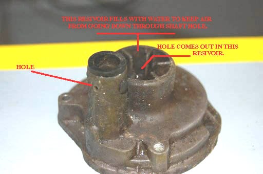

      Guys I have been having a water pump problem on my 1957 18hp erude. It pumps water great at speed but at idle it sometimes quits. I have had it apart twice now changed the impeller twice and the grommets looked good. I was checking the water pump housing for wear and that looked good. I pulled the grommet for the water tube out and I noticed a mark on the side of the grommet. A small drilling was blocked by the grommet. Maybe there is a shorter grommet? I don’t know. Do you guys think this drilling in the housing being blocked could be my problem? Engineering put the hole there for something! Maybe the pumps need water on the top to make it work? Anybody have experience with a problem like this. Pictures coming!

      What is this little drilling for?
      I cut the Grommet to uncover the hole.
      #232136
        That hole is drilled at an angle, connecting the water outlet to the well surrounding the drive shaft. The purpose is to keep the well filled with water, creating a water seal to prevent exhaust gasses from entering the pump via the drive shaft hole. The UPPER end of the angled hole will be blocked by the grommet, but the LOWER end of the hole should not be blocked. If blocked, it may cause erratic pumping.

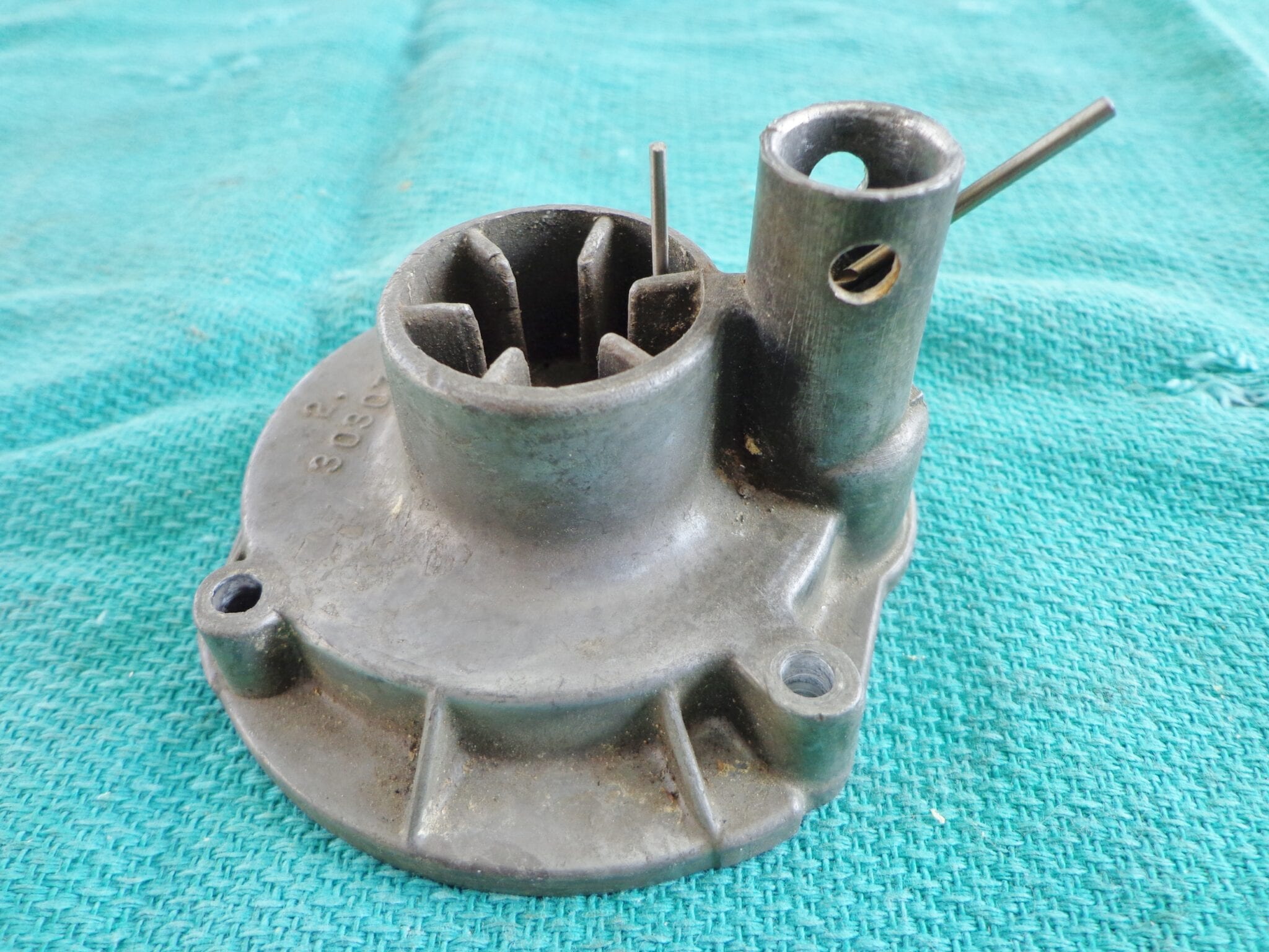

          Found my picture
          Water-pump-housing-bleed-hole
          #232146

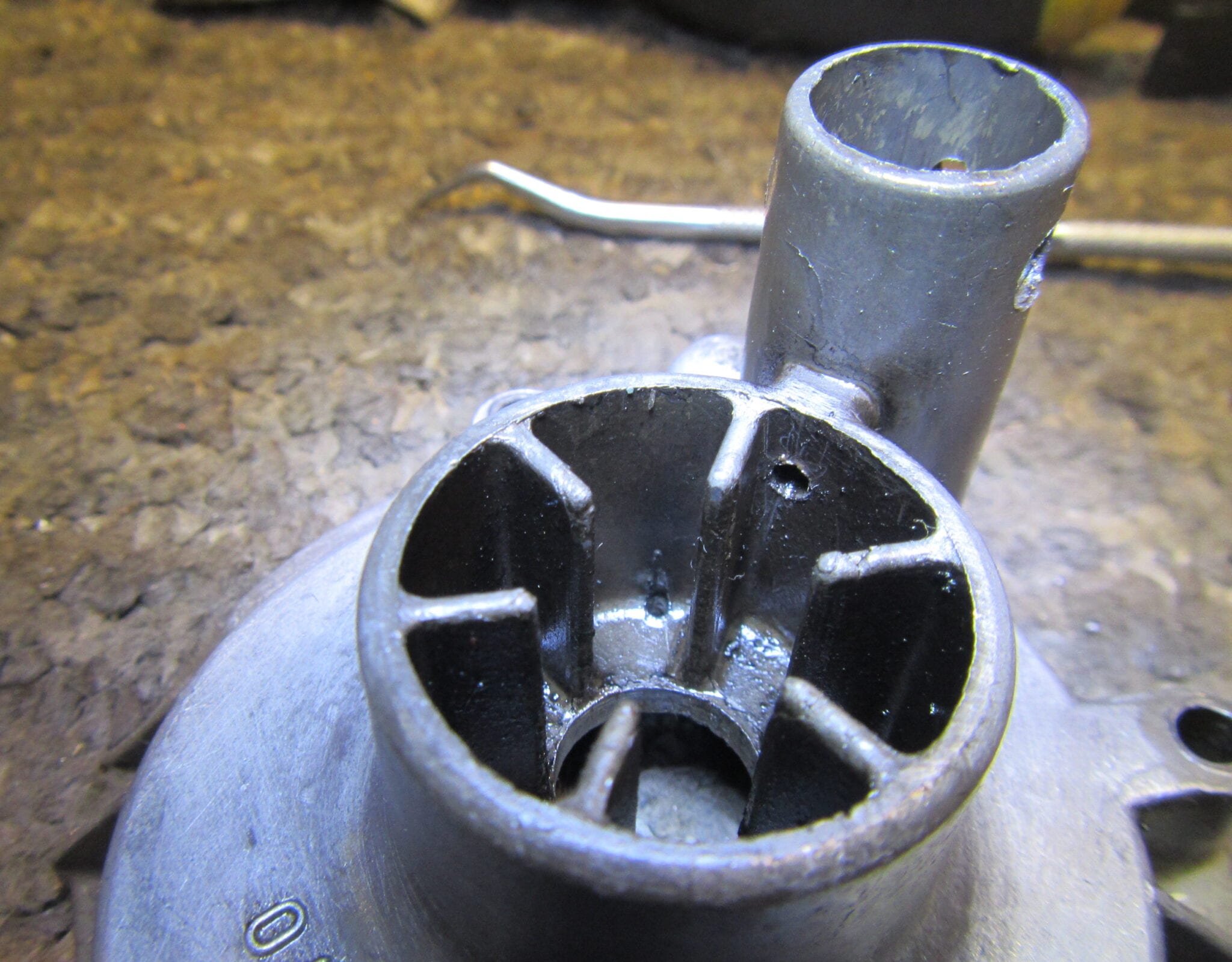

            Here’s another view showing how that hole is drilled on an angle. It and the small bleeder hole at the bottom of the well must both be clear and open for the pump to work properly.

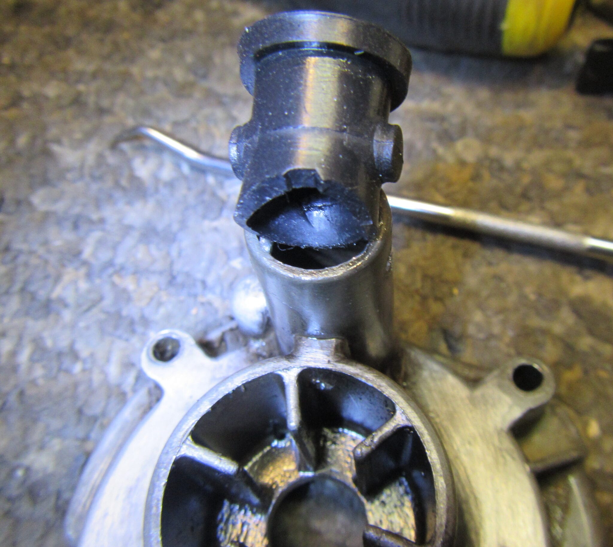

              I have had a few cases where I had deemed the pump housing good enough, as the engine was pumping okay before service…..but then would not pump well at idle with a NEW impeller. The trouble is, the old housings and impellers wear together and fit like a glove, in some respects. A new impeller doesn’t fit into the old wear pattern as well. Changing the housings to new ones solved my problems astonishingly well. I guess this was me, peeing on the electric fence, right? By the way, what is going on with the bottom of your grommet? It looks torn up somehow, in the picture.

              Dale
                • This reply was modified 5 years, 8 months ago by billw.
                Some people gotta learn the hard way! me too! I cut the bottom of the grommet so it won’t plug off the small drilling in the housing. I think that will fix my problem. Wonder how many other motors around are messed up? Those pump housings are getting harder to find lately.

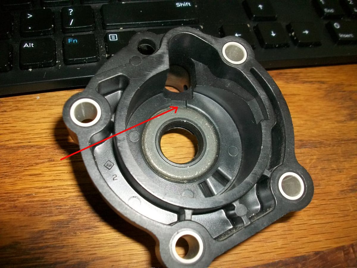

                        Crosby, are you sure there are no bleed holes in the new housing? I don’t have one to look at, but I do have this OEM one which I think is for a 35hp. They went out of their way to deal with the shaft hole. First, they added a seal, then they also added a slot between the outlet tube and the area between the the plastic housing and the stainless cup.
                        bleed-slot
