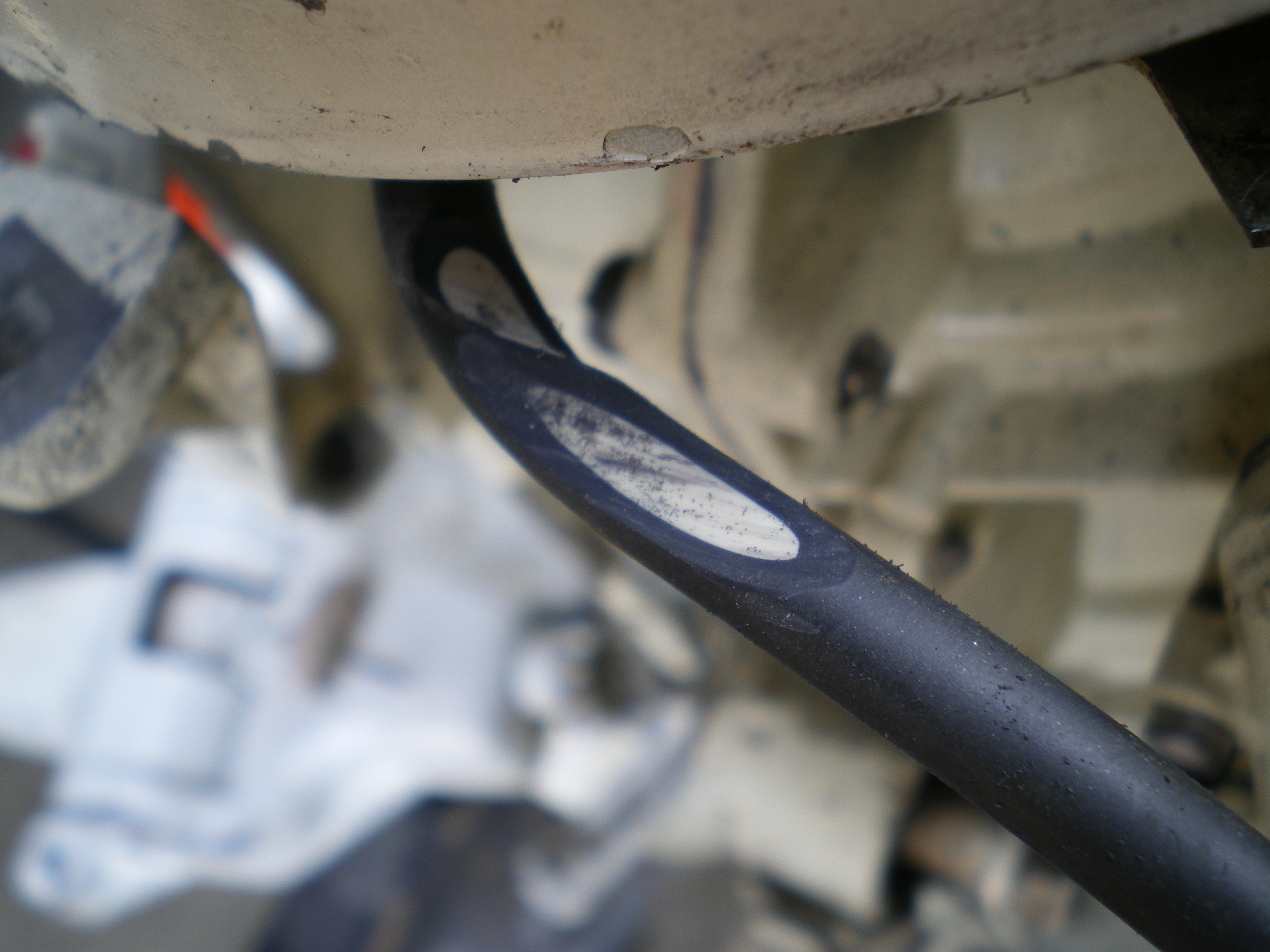

        I think the PICO wire has just one layer of insulation and is rather flimsy. I bought some from my auto supply once and ended up returning it. It is tinned and will work but it wasn’t what I wanted. This STANDARD wire from Amazon is OK as it has a white core with a black jacket. Neither of these are as good as the original with the woven reinforcing but they will work fine as long as they don’t rub on anything, like a spinning flywheel.

          I agree with Mumbles about this wire being a bit flimsy and it does have only a single insulation layer. That said I have a roll of it and I have been using it on my motors that have needed new wires. So far so good with it. I have not had any problems yet. The price is right, but I may go for a more robust wire when I run out of this. If there is any place this looks like it may rub or wear, I will put a piece of heat shrink tubing over that area for some added protection.
          I have not tried the BWD or the Standard yet. A spinning flywheel will wear it’s way through most any plug wire insulation in a fairly short time.
