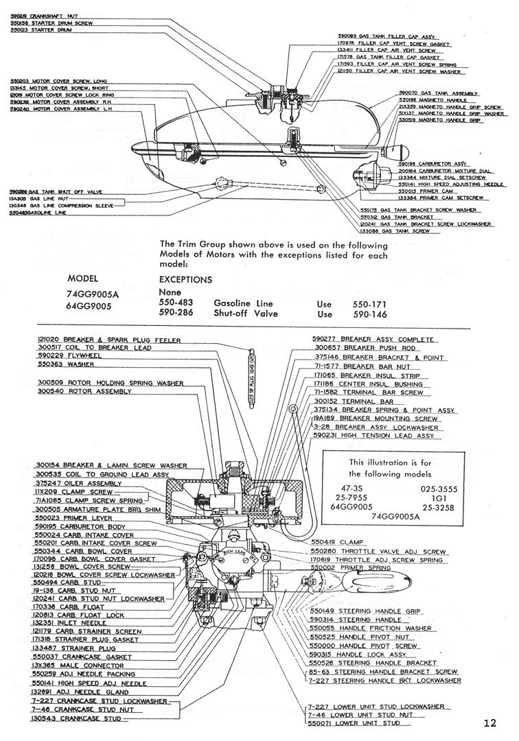

May 10, 2023 at 9:23 am #276115Magnets are in the round rotor in the center and not in the flywheel. It does not have 360 degree steering. Has a caring handle attached to the stern bracket. I attached a picture.
May 10, 2023 at 9:29 am #276116May 10, 2023 at 9:31 am #276117Not sure where that picture came from. It’s not mine. I can’t get my picture sent to you. It’s a .jpg and only 1.4 mb
May 10, 2023 at 9:35 am #276118Try renaming your photo and see if it appears here.
By the way, nice gaskets!

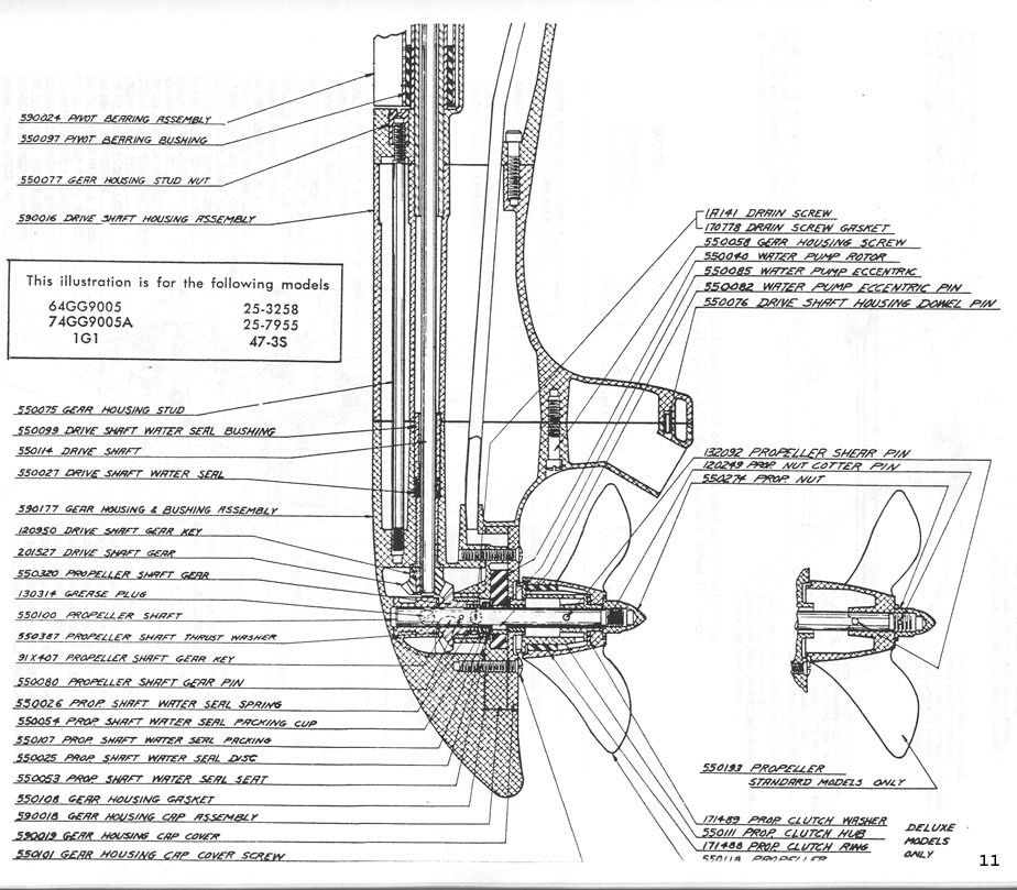

May 10, 2023 at 12:01 pm #276123May 10, 2023 at 5:01 pm #276131Frank, the illustration you sent is great. Looking at the trim my model appears to be the 1G1 version.
