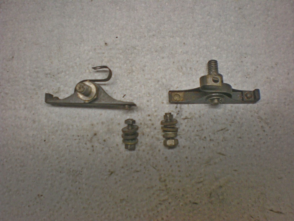

      The fixed half of one set of points on my A-80 Johnson
      is wore down right to the nut as you can see
      in the photo.

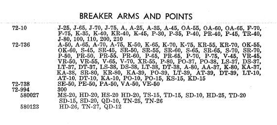

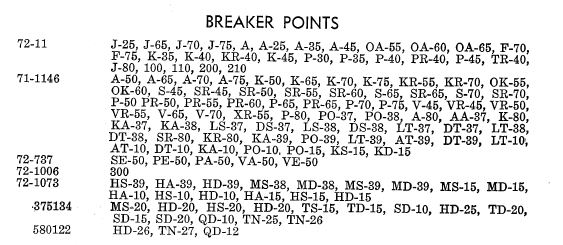

          Those look to be common points used in oodles and oodles of motors. You shouldn’t have any problem finding them or just the piece you need.
          #67097
            Thanks for the article and points specs!
            I’ve never heard of silver solder sheets
            or granular silver solder with flux. I do
            have a roll of silver solder though.
            Don’t believe I’ve ever seen that list of
            points either. I don’t see "A-80" listed,
            but assuming they’re the same as the A-75
            listed, I might have some on a parts motor.
            I did find some Ford Model A points in my
            parts box today. They have a "screw type,
            fixed half", point set as well, but it’s not
            quite as long, and it’s a little fatter,
            but I think it would work using different
            size fiber washers.

            #67101
              quote Buccaneer:
              I don’t see “A-80” listed
              P/N 72-736.

                  I did not find any un-used points from my
                  LT & DT Johnson projects, so I’m going to
                  use the contact from the Model A Ford points
                  for now, but will scrounge up the correct points
                  to have on hand.
