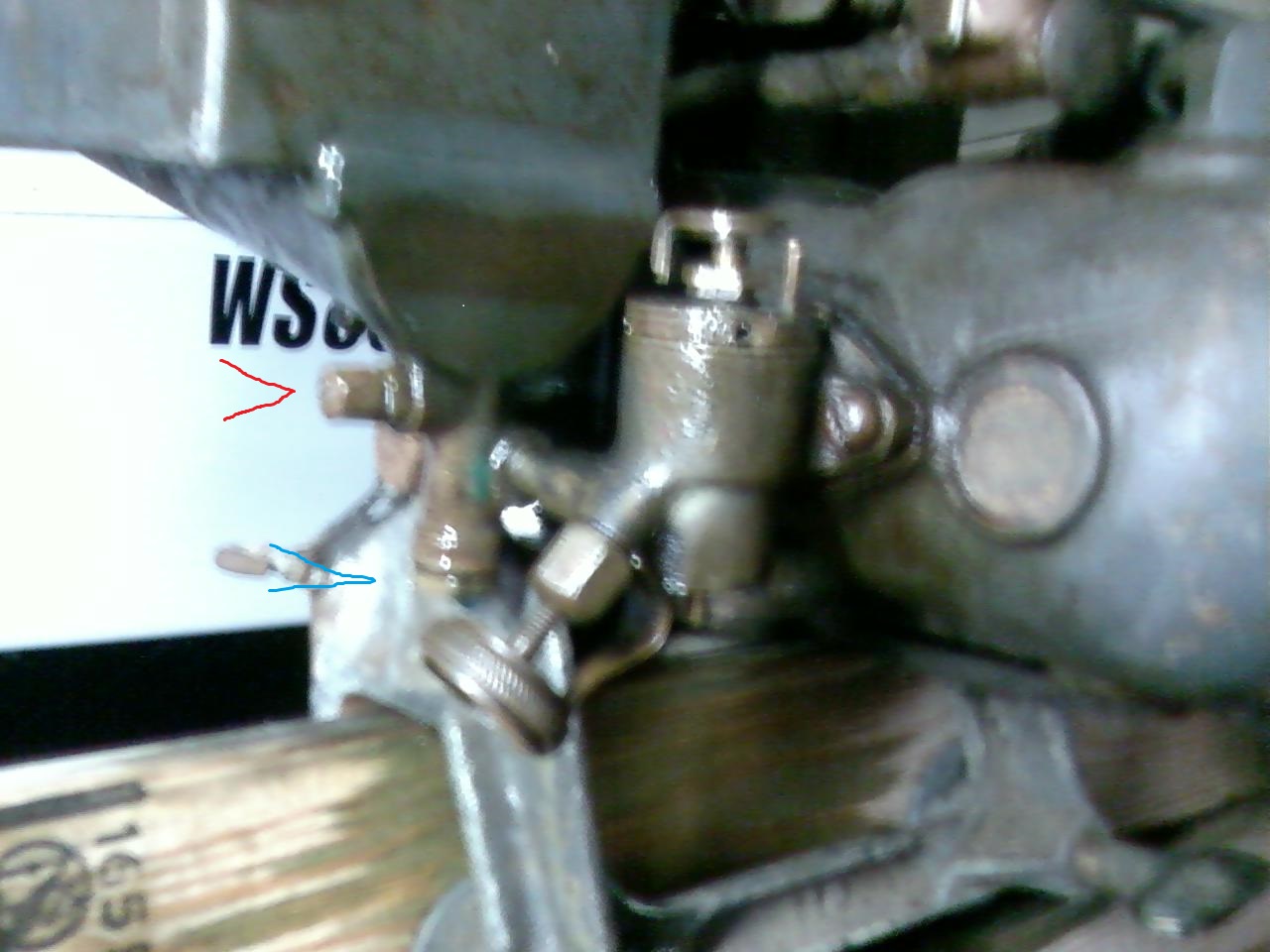

      I have a 1922 Evinrude model A. It has good commpression and spark and NOS spark plug. I put my last OMC packing washers in the poppet valve and a few drops of penetrating oil in it because the primer button is stuck. I could use any info on starting procedure, maintenance, etc. Thanks, Slim

        Poppet valve has to move freely. You have to lift it by pushing on the stem from underneath. The poppet valve is spring loaded and needs to have pressure on it when you lift it off the seat. There is no primer button on that mixer.

              Poppet valve is clean and free. Fuel comes out when pressed up. Does it matter which end of spring goes up? Small end was up but seems to fit better small end down. Fuel shut off stem is broke but got it open. Cleaned the filter but gasket fell apart on screw. Will a cork gasket work? Anyway I turned the flywheel back and forth three times and it fired…once. It fired again but just once about every third time. Motor was mounted on a sawhorse so it was not level. New water hoses so I could try it leveled in the test tank after I fix that leak. This thing is heavy so anymore advise would be very much appreciated before my pore aching back has to lift it into the tank. Thank you all. Slim

                  Poppet valve setting – I usually open the knob/handle thing until it butts up against the stop pin. Normally, that’s all it needs. On my early Evinrude that doesn’t have the stop pin on the mixer valve cap, I open it about 3/4 to 7/8 turn and leave it there, she runs just fine that way from start-up to shut-down.
                  Needle valve – these have a coarse thread needle so you don’t want to turn it open very far…. if it coughs every time you pull it but won’t keep running, try shutting the needle valve off completely, pull it over, and see if it fires up again and acts like it really wants to run until the fuel runs out (only takes a few seconds)…. if that’s how it acts, you know your initial needle valve setting is too rich. I usually go open 1/2 to 5/8 turn to start, then lean it out from there to get her running smooth.
