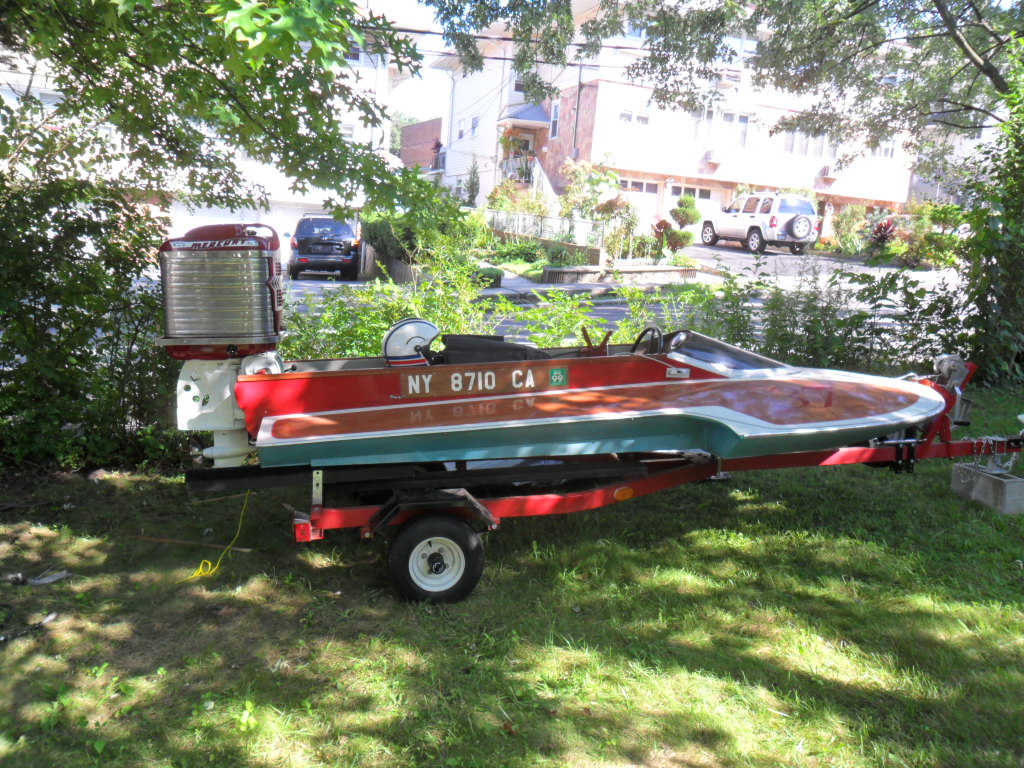

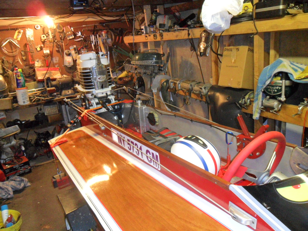

          Here is mine the pic with the mark 75 is a mockup in the build I am running a merc 500 on a D quickie lower.
          should be in the 65mph – 70mph. With the 4 cyl.
          #52375
          thumper
            That’s gotta be stupid fast!
