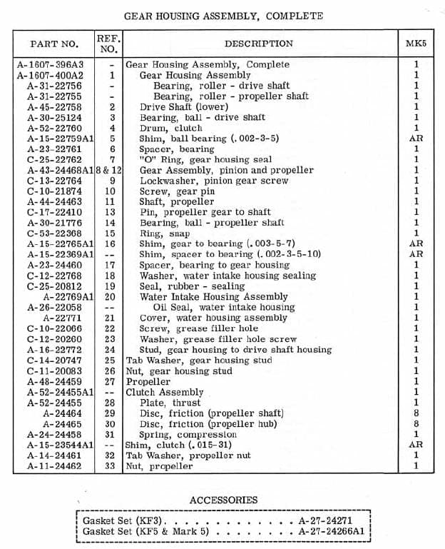

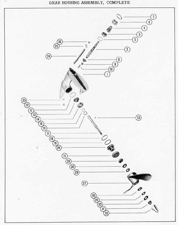

              Items #29 & 30 are the clutch disks, 8 each.
              Mercury-Mk-5-gearcase-2
              Mercury-Mk-5-gearcase-Parts-List
