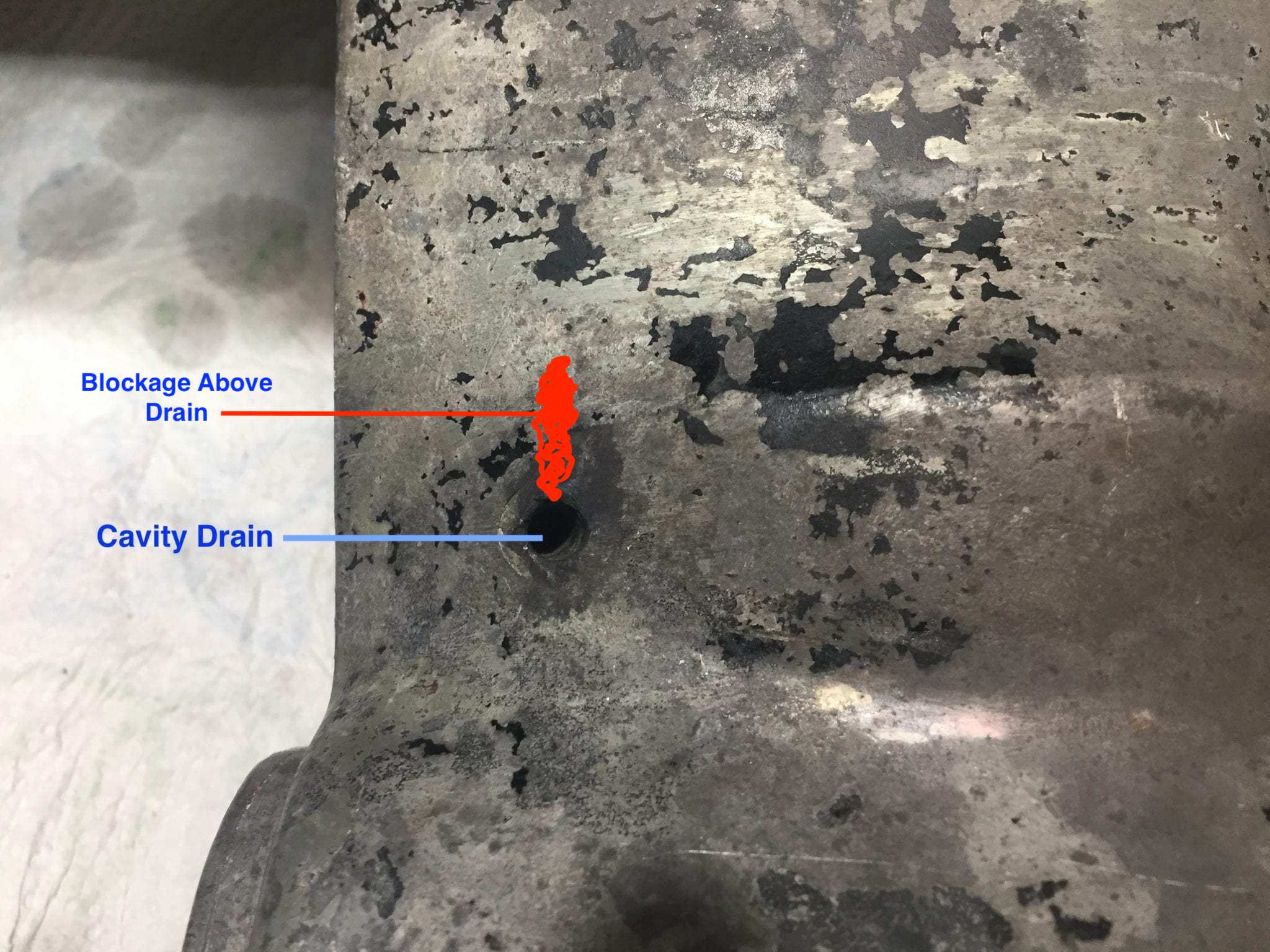

                #221350
                  If you are seeing aluminum by poking and prying directly into the drain hole itself, that’s the inner wall of the cavity. The blockage is above the drain hole.
                  Gearcase-Drain
                  1982 Evinrude 25hp
                  #221354
                    I believe the bottom weep hole is offset from the vertical drain hole a little ways,
                    and that’s why you are seeing shiny metal when probing ……. I believe on mine,
                    the vertical hole is a little off to the left of the weep hole.
