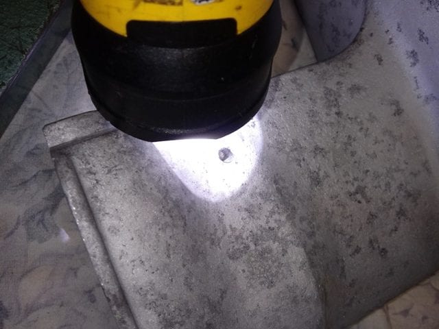

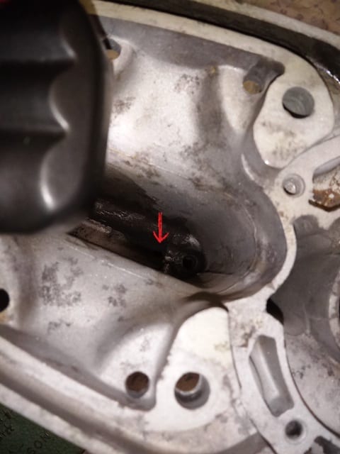

    outboardnut
      Well – someone in 1955 was was hung over and did not drill the drain hole all the through to the weep hole.
      I know your going to say that crude gets in there and is hard to get out.But for SURE the hole was not drilled all the way down.
      I do not have the facilities to drill the hole all the way.
      Nor do I want to spend the money to have the hole drilled all the way.
      My question is this
      Would you still use the gear case even through the drain hole does not function????????
      drain
      drain-3
      #221319
        I would think this drain passage was not something that was drilled but was part of the factory casting. I’d poke around in there with some real stiff wire or maybe a drill bit on an extension and be sure it’s not just plugged up. On my QD-20 I thought sure the drain did not go through to the drain hole – 2 days of digging around finally cleared the rock hard blockage.

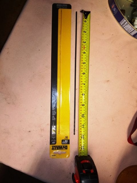

        #221321
        outboardnut
          I did drill in the hole
          drill-bit
          #221324
            Well, I wouldn’t use it unless you want to pull the lower unit off and drain the water before you put it up for the winter. Maybe some others with more experience will weigh in on this but I’ve never seen or heard of one that had a bad casting at the drain passage. I’ve had to drill the passage on every one of my motors and just found them plugged up. A couple drilled very easily and quickly but my QD-20 and RD-18 both took a lot of work to clear them out. When you drilled yours, did you get any dirt/debris on the drill bit or did you get aluminum shavings?
            Edit – you say you drilled in the “hole”. From your picture, I assume you mean you drilled from the top of the case down into the drain passage and not into the drain hole itself?

            #221327
              Most of them are plugged. You could lay the motor down on it’s backside to drain the cavity before standing it up for winter storage.
              #221328
              outboardnut
                I drilled from the top
                I hit debris
                then hit aluminum
                I also cleared the other hole
                When I drill- I put some naphtha in the hole
                For two reasons
                It helps dissolve the debris
                plus it -leaks out the side hole telling me I went through

                  #221330
                    Well, I would swear I have run into this “undrilled” situation before also, but it is hard to say….The problem is you have to be so careful, you must know where your drill is at all times, you sure don’t want to drill thru and puncture the oil cavity….I would certainly mark the drill bit with some tape or something to make sure you don’t drill too far.
                    You have that gearcase all apart now, I would definitely clear the drain hole….Water trapped during the winter could split the housing open, have seen that happen more than once….

                      #221334
                        I’m confused, your video looks like you have solved the issue with some sort of drill bit/wire rig set up…..
