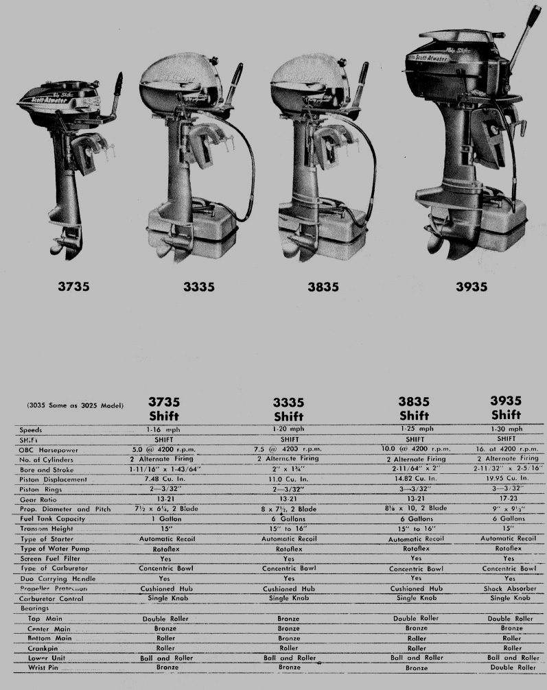

          Do you mean the 1953 model?
          1953-Specifications

                    Model # 3755 is a 1955, 5 HP, Twin cylinder engine as per the Scott-Atwater info I have. he #3 indicates it is a Scott-Atwater, #7 indicates 5HP, #55 reversed, indicates year, which obviously makes no difference in this case. I have the 3735 model, 1953

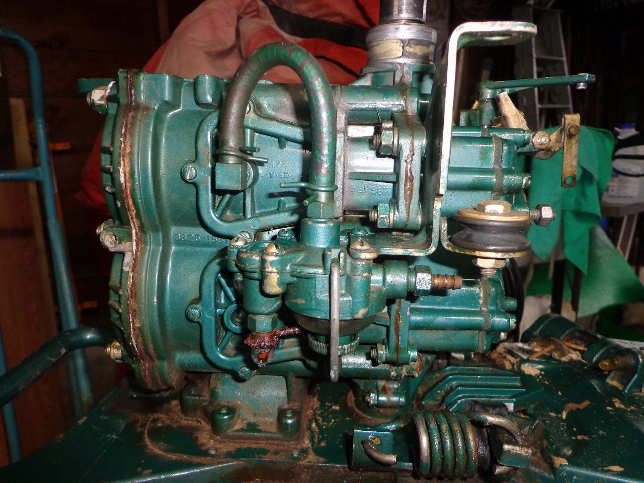

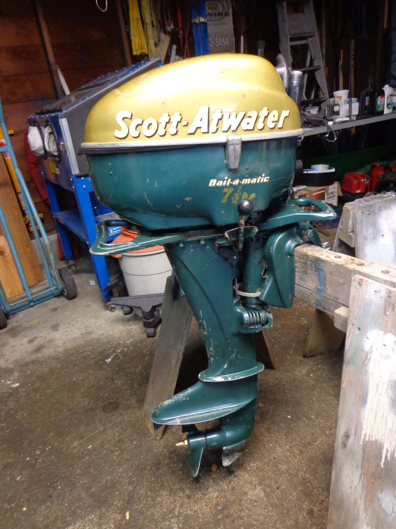

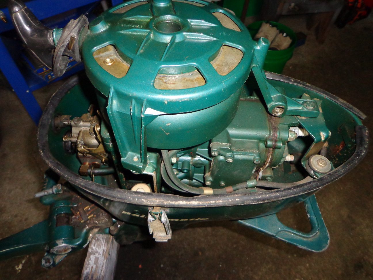

                      Not sure what you mean by hood mount brackets but here’s a pic of the fuel pump on my ’56 gold top 7.5 horse motor. I’m not sure  if it’s the same as yours or not though.
                      Also, here’s an interesting read about the Scotts/Firestones over at Oddjobs:
                      https://www.oddjobmotors.net/scottatwater.htm
                      DSC01482
                      DSC01478
                      DSC01604
