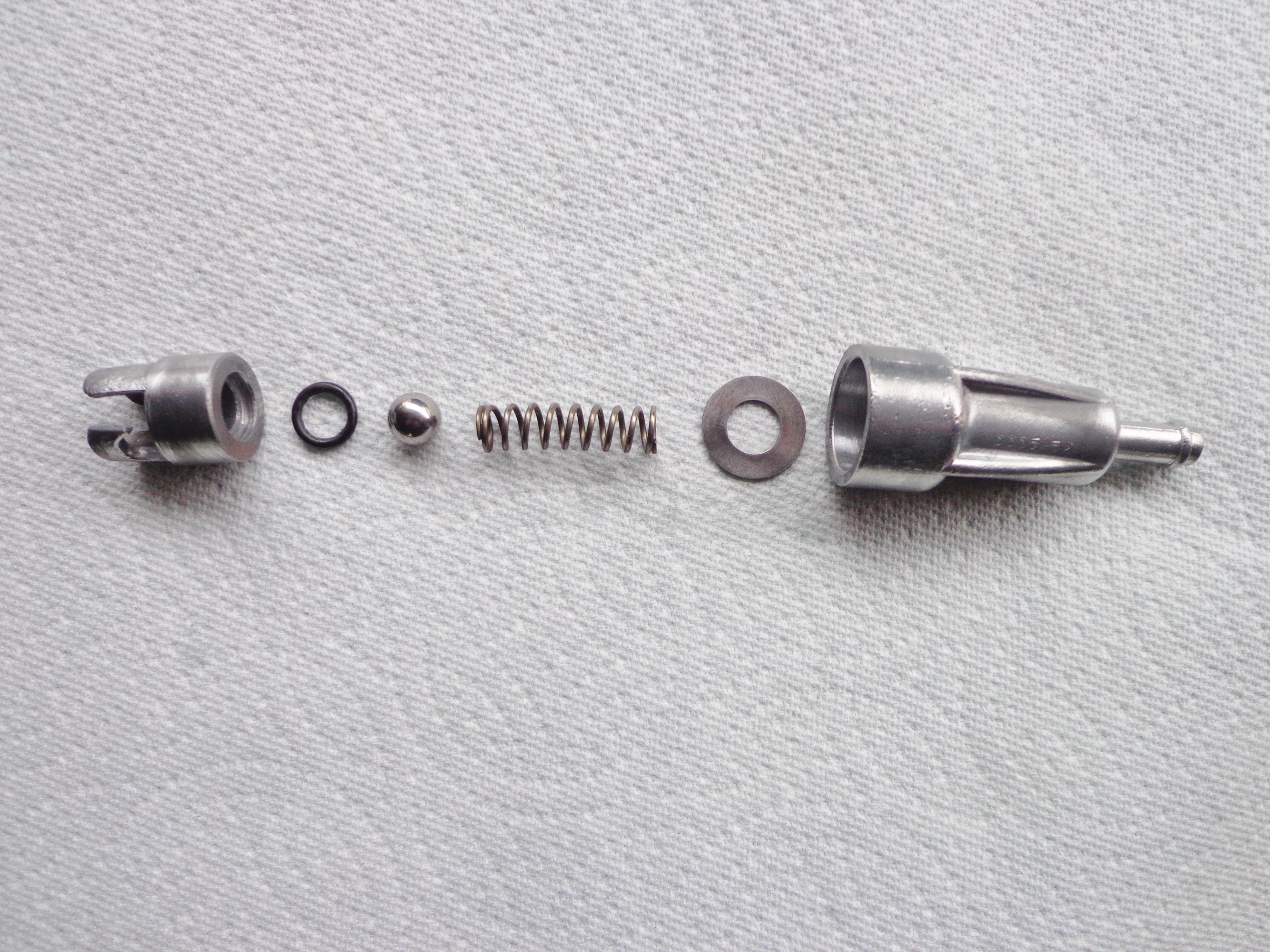

I’m looking to purchase a Scott Atwater fuel connector for my Corsair project, and I found one for sale, but the seller says it leaks. Do these have an o-ring inside that can be replaced? Also, I read somewhere that the smaller Mercury fuel connector (for the MERC39 and MERC60 models) will work with the male Scott motorside fittings. Can anyone confirm that is true; if so, I won’t buy a Scott fitting as a have a couple small Merc fittings.

JPFebruary 7, 2017 at 3:14 am #52562JP, That is true. The small one fits and I have seen that Merc connector go for $50 plus. Ed

February 7, 2017 at 7:08 am #52568If your connector is leaking, you can put a new O ring in it to fix the leak.
A few years back I fixed a couple of them. I’m pretty sure I had to heat up the connector to get it apart as it had a sealer between the two halves. A standard O ring from an assortment kit fit right in and with a bit of sealer, the two halves got pressed back together and the job was done.
February 9, 2017 at 2:54 am #52682Thanks for the repair tip, Mumbles. I’m going to give my Merc fitting a try, but it is good to know you can fix up the Scott fittings!

February 9, 2017 at 3:36 am #52684Thanks, Jim. I kinda figured you’d figure it out. I looked thru a batch of service info, but I’ve never seen a how-to-fix on these fittings. Maybe they just didn’t leak very often ?

February 9, 2017 at 3:19 pm #52700Jason,
Yes thank you for asking. I have a few smaller Scotts as well. A press fit is all it takes, cool!
