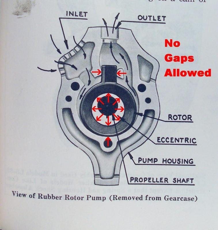

      hello. we got my friends 1948 5hp sea king running but its running hot. we took apart the water pump and cleaned it out but i dont understand exactly how it works and how to tell if its worn.will i see water coming out from anywhere while its running.there is a tube at the bottom of the powerhead on the port side.should water be coming out of there? thanks

        Wobbler-pumps-diagram
        Found this in my files, saved from the forum a couple of years ago.
        The wobbler type pumps “displace” the water around the rubber
        rotor as the eccentric “wobbles” it, forcing water “up” to the
        power head. There should be no gaps where indicated in the photo,
        or water won’t be properly displaced, or “forced” up hill.
        #164201
          You will often see the rubber rotor is swollen because of grease leaking out of the gearcase. Major telltale sign is a gap between the eccentric and ID of the rubber. Also, the rubber often is swollen to the point that it fills the housing on the OD.
          That pipe is the crankcase puddle drain. No water comes out there–at least there better not be. Water slobbers out of the slots about half way down.

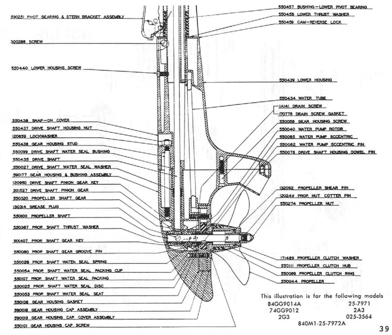

              #164228
                Doesn’t look like these have actual seals……..do they?
                Pg_39_Lower-Unit
                #164233
                mike n
                  i dont think so .it didnt look like a normal seal
                  mn
                  #164234
                    The “water seal packing” serves as a seal on the prop shaft to keep grease out of the pump. It is a properly fitting rubber washer. Let’s face it, most motors of that era had crummy seals. That’s why you were supposed to re-grease them so often. And use grease, not oil.
                    #164235
                      You should be able to blow through the water pipe going to the powerhead. But do not ever remove the side covers from the powerhead unless as a last ditch effort. They are very difficult to reseal. The service manual says to send it back to the factory for re-sealing them. Kind of hard to do with the factory being long gone.
