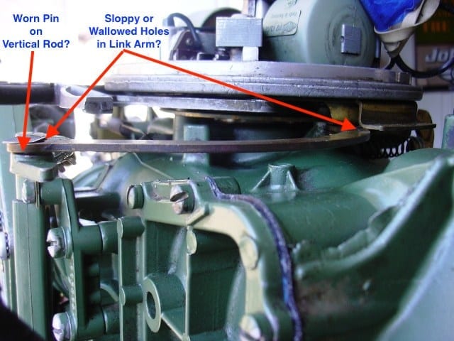

      If the vertical rod hits its stop with everything connected, that can only leave a bent or loose link arm or a worn pin on top of the vertical rod as the problem.

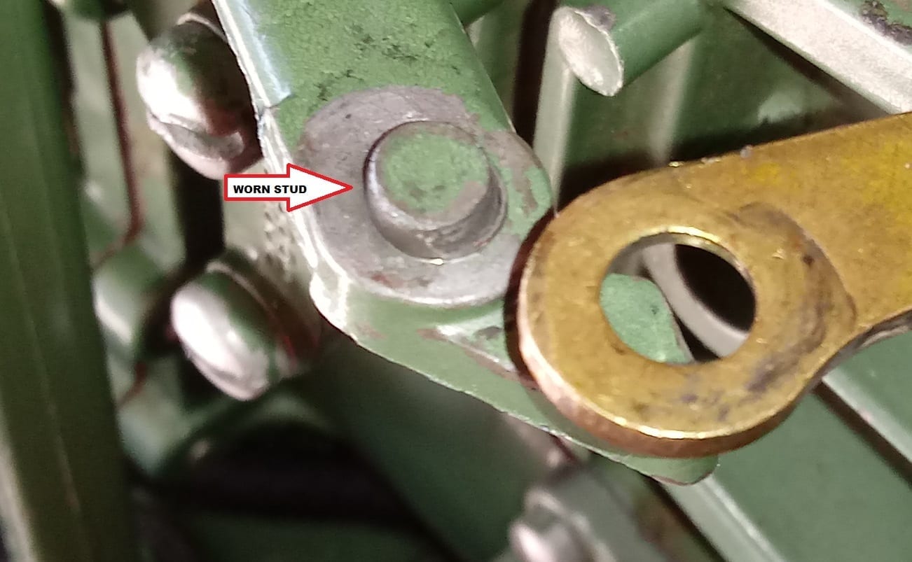

        outboardnut
          I have determined that the problem is a worn stud.
          I have about a 1/8 inch play.
          I’m not going to worry about unless other wise told.

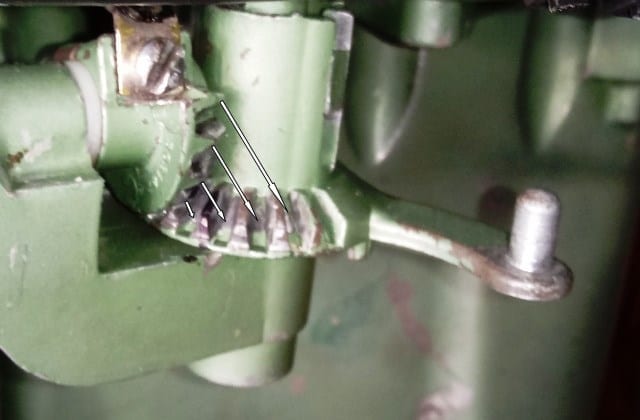

            Steve D
              Not sure if I’m seeing it right but as Richard said, you could still be off one tooth?
              pinion-gear-off1
              • This reply was modified 5 years, 11 months ago by Steve D.
              #196986
                Yes, does appear to be off by one tooth. But, it is off in the direction of being over advanced….Perhaps the extra tension pushing on the vertical throttle rod helped wear out the pin….he screw definitely looks buggered up, so someone has been in there before…
