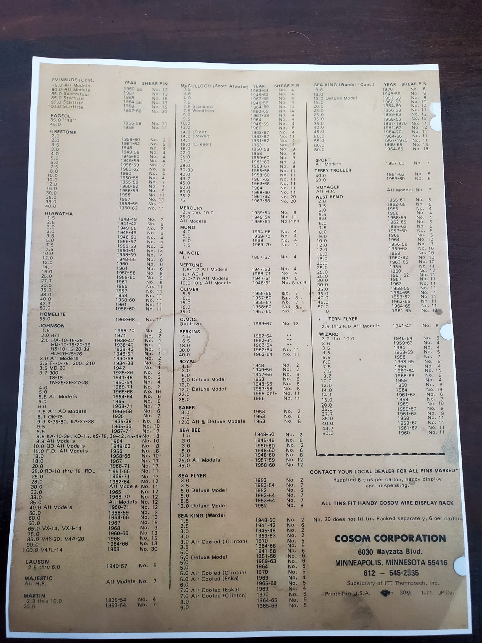

                #229071
                Steve Martin
                  20210128_192700
                  Here it is….
                  I’d like to see information like this guide available to members as a sticky or in the resource section of the Inner Sanctum as a benefit of or an inducement to membership.

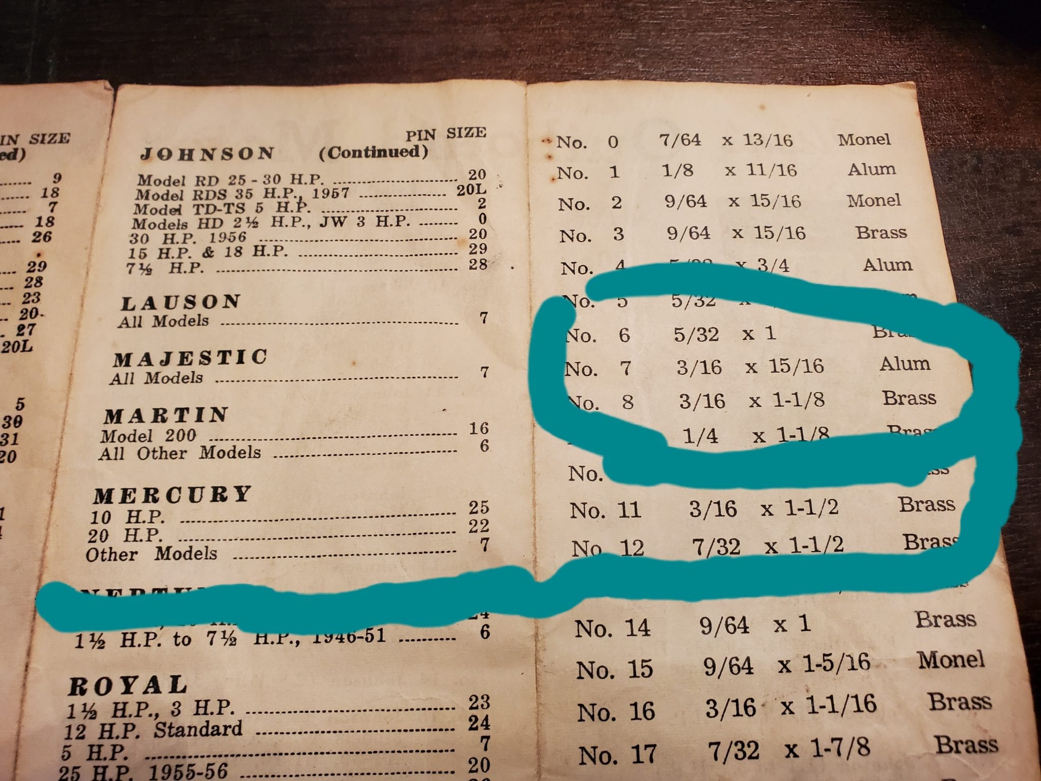

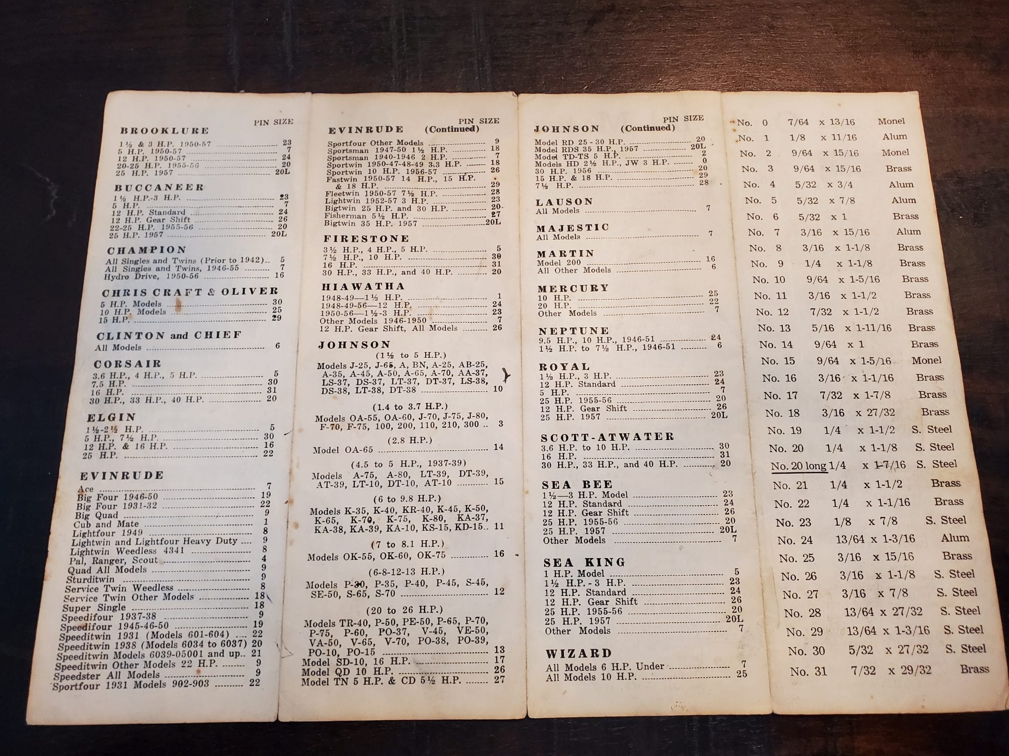

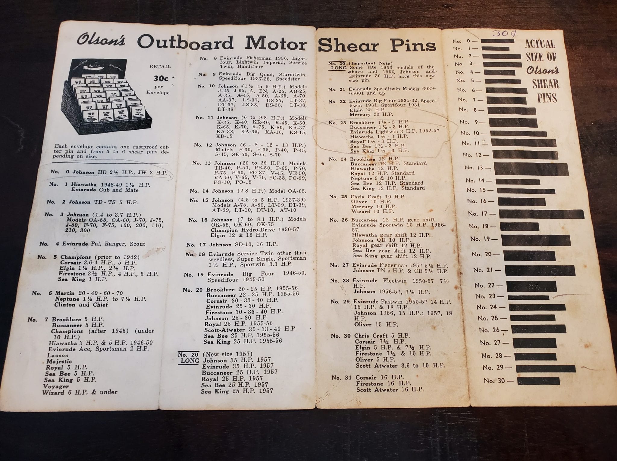

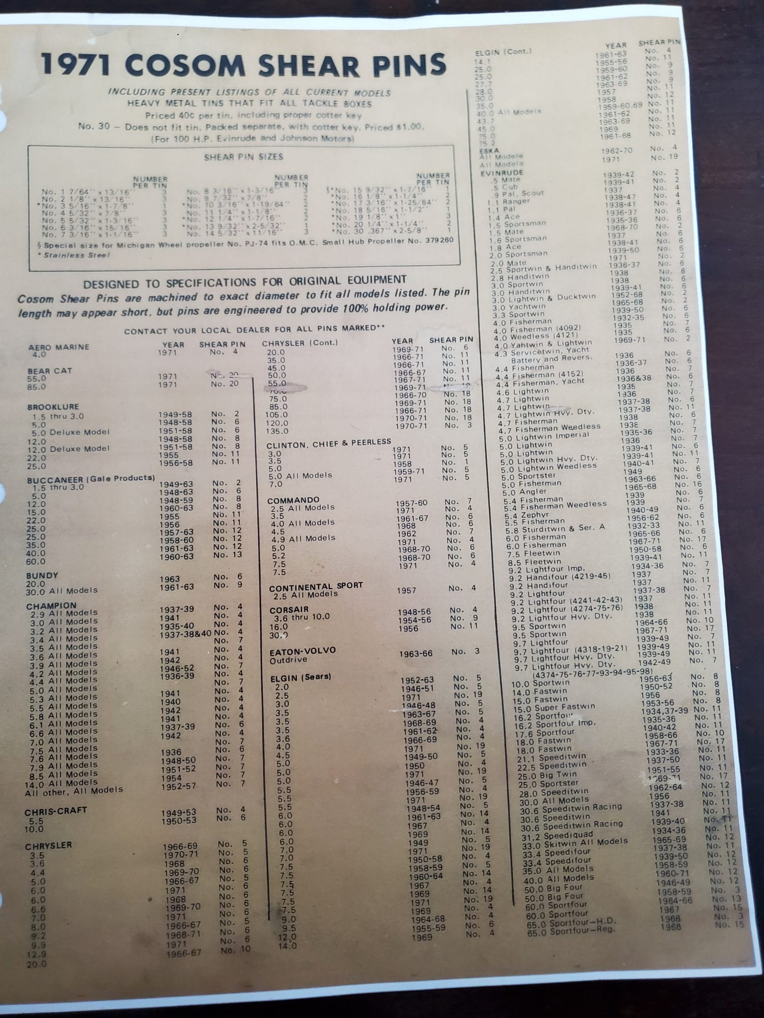

                  #229074
                  49morphew
                    20210130_082034
                    20210130_082125
                    Here’s the whole thing
                    20210130_082558
                    20210130_082337
                    This is another list I have as well
