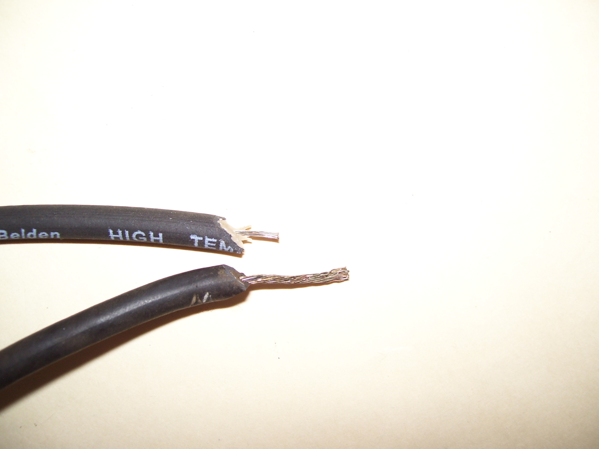

      I am replacing the wires on my RD18 and notice the replacement wire core seems smaller dia than the original. I got the replacement at NAPA today and the wire is printed "Belden High Temperature 7 MM Metallic Cable 14". It seems to me that would be harder to hit the core with the pin connections on the coils and the plug terminal ends. Am I missing something here?

        I get mine at NAPA, 7mm. No real problem with the plug ends that I’ve noticed. Since it’s 60 year newer wire, maybe it can be smaller due to better material?

                I do a resistance test from the boot to the coil leads, always get the same reading as no plug wire installed, if I hit the wire strand. You’re good to go then.
                #29416
                  Good practice is to strip 1/4" insulation off the plug end and fray out the strands so they will touch the spring, ensuring a contact. You are dealing with high voltage, so touching is good enough.
