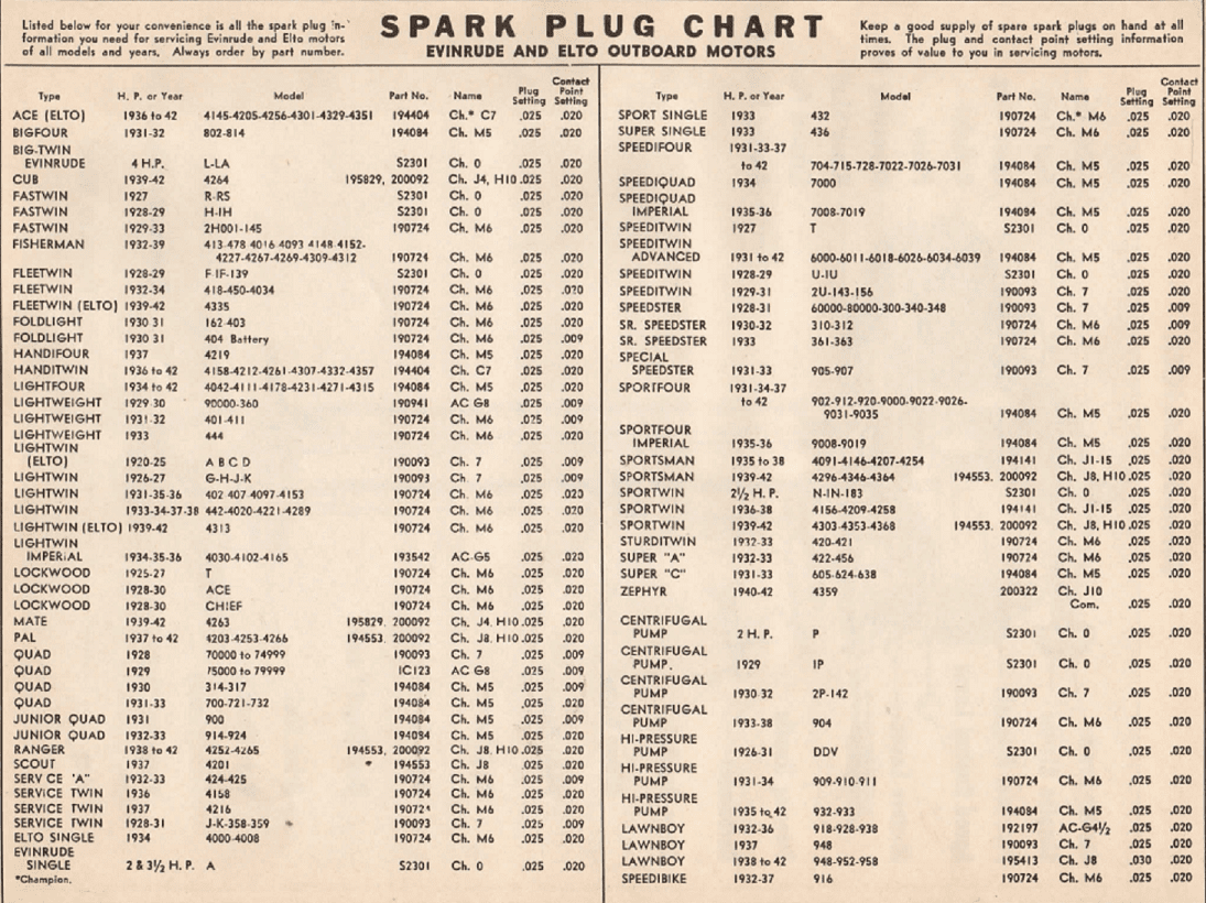

      #199981
        champion M6 according to the chart. I need to build myself a chart for
        showing myself all the “replacement” plugs shown in these old charts.
        Evinrude-Elto-Spark-Plug-Chard-early

        #199983
          If Champion 6M is the same as M6, it looks like you could use the Champion D14
          18mm spark plug heat range chart … Hottest on top, Coldest on bottom
          Champion – – – AC – – – Autolite – Bosh – Motorcraft Prestolite
          C7 (D23) – – – – – –
          C15(D21) – – – C88 – – – – – – – – – – BT9
          7 (D16) – – – C87 – – – – – – – – – – B8X
          6M (D14) – – – C85 – – – 386
          5M (D9) – – – C82 – – – 373 – – M8A – — – BT4 – – – 18-3
          R7 (D6) – – – – – – 372 – – M7A
          R1
          R11
          R11S Old racers using Alcohol
          R2
          R2S Using Nitromethane.
          #199985
            The 1942 service manual says your motor uses a P/N 190724 Champion M6 plug gapped at .025″ but I think they meant 6M and not M6. A modern replacement would be a Champion D14.
            https://www.sparkplug-crossreference.com/convert/CHAMP_PN/6M
            https://aomci.org/forums/topic/champion-6-m-cross-reference-or-replacement/
            • This reply was modified 6 years, 6 months ago by Mumbles.

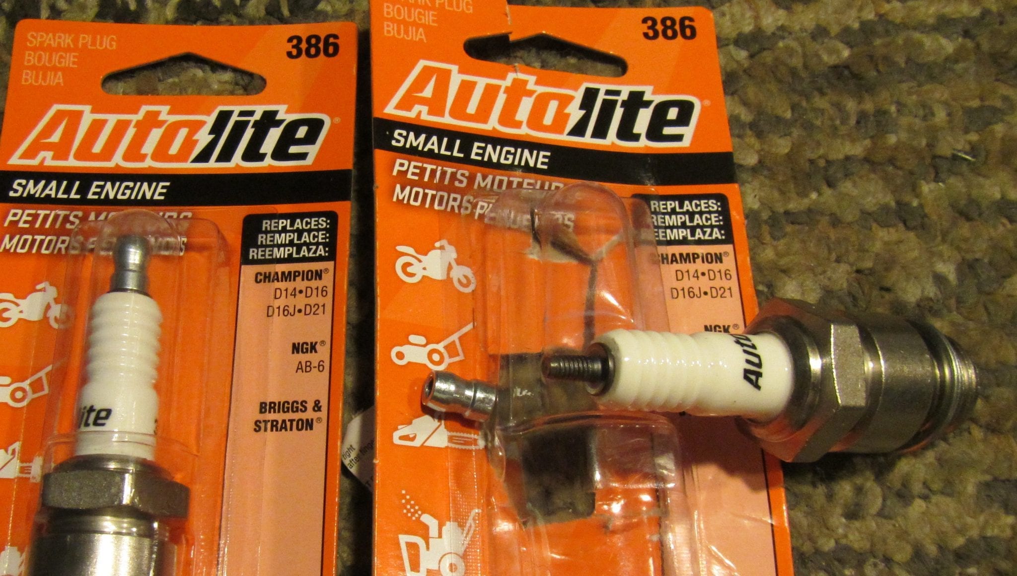

            #200031
            Dale
              Geer, I just picked these up at wallieworld! 18mm Autolight. Surprised to find them and a cheep price. Check.em out.
              dale
              IMG_0005-1
              $1.78 must be a mistake!
              #200034
              Geer Pyron
                Ha!!!!
                That’s what I got!
                From The Wally-World too!
                A friend says the ‘37 fisherman will take a Champion D14 too.
                But it was black.
                The auto lites are a nice brushed nickel.
                Ha!!
                Picky picky me.
                But alas, spark plugs weren’t the problem.
                Still not running after two mag plate rebuilds, two carb the aparts and put back together, new rings, and hours(?) of chin scratching.
                It did pop and I think fired once. Made a popping sound.
                I had to walk away from it today. Hard to do, but it’s the first time I’ve been really frustrated.
                G
                JMGP

                      JOHN D.
                        The #386 spark plugs may be the resistor type. They may not work as well under compression.
