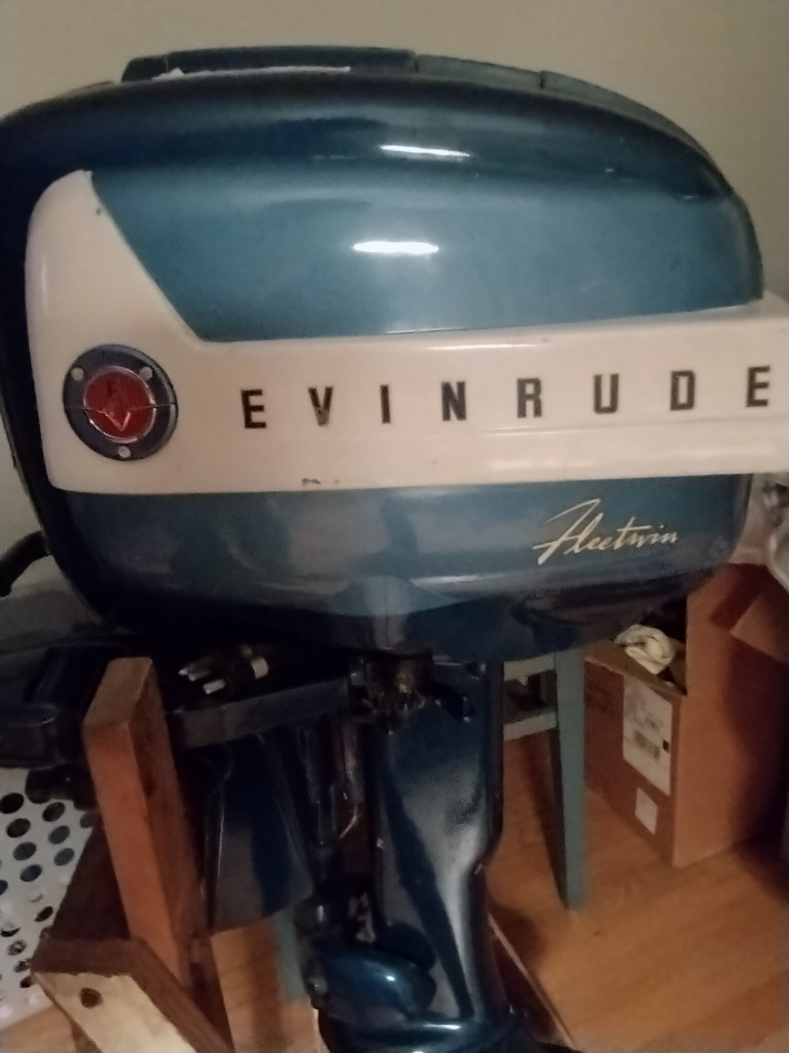

Purchase a 58 Evinrude 7.5 out of an estate. Looks brand new. And had a tag that it was winterized in 1995! Motor is clean as a whistle. I’d like to start it but I want to make sure I do it the right way. Any tips? Thanks in advance. Matt

etc…. we like pictures !!!
April 11, 2024 at 8:21 am #286657I’m so envious! Even though the engine is new/never been used, it is likely that the coils have failed/cracked. You can inspect them fairly easily by removing the recoil and the little inspection cover over the flywheel. Like everyone says, gear lube, water pump impeller, ignition service.

PS As promised, a few more photos. It really is remarkable how clean this motor is – it’s hard to tell it ever ran! (The only thing missing when I bought it was the starter mechanism. As you can see from the different color, I found one online. 😉 )
