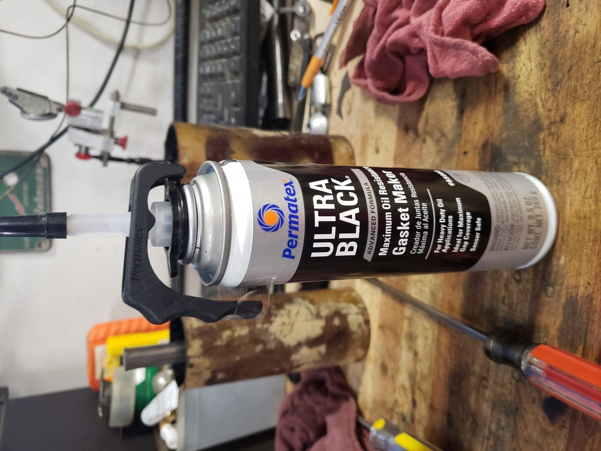

            This is the can I was referring to….

                Ben Ditmar, Ben Breitner and Ron Baker were using this, they advised you can remove the hardened stuff and continue using…I have not opened mine yet… but the 847 is still oooozing from the dad gummed puncture…ugh
                    THAT explains the *cough* in the same line as the “fine gentlemen” 😉😁
                    I have had to open up the valve on my can before too, but it took two or three months for it to set up that far down. Usually it just hardens in the nozzle and it can be removed with a pin punch or a finish nail or something. I have used both 847 and Ultra Black for gearcases and I much prefer the forgiving nature of the Ultra Black for that application. I have used my 847 for crankcase halves too, but actually prefer Yamabond 4 for that. Nothing wrong with 847 and it works for different applications. There are newer, more specialized sealants available now that I think do a better job for specific things.

                        I have resealed two Gear Cases one with 847 and one with Ultra Black. I have ran the Motor (65 Small Case 18) with the ultra black about 45 Minutes in the lake and no water in the case when I drained the oil. So far so good. One thing I did do before applying the Ultra Black is I cleaned all surfaces and screws with M.E.K to ensure the surfaces and screws were clean and oil free. Then as recommended I applied the sealer and fitted the parts just a little snug. Then came back one hour later and final torqued the case screws. I haven’t ran the Motor with the 847 yet (69 Big Case) and yes the 847 is more cumbersome to work with but not terrible. Anyway thank you for all the replies
