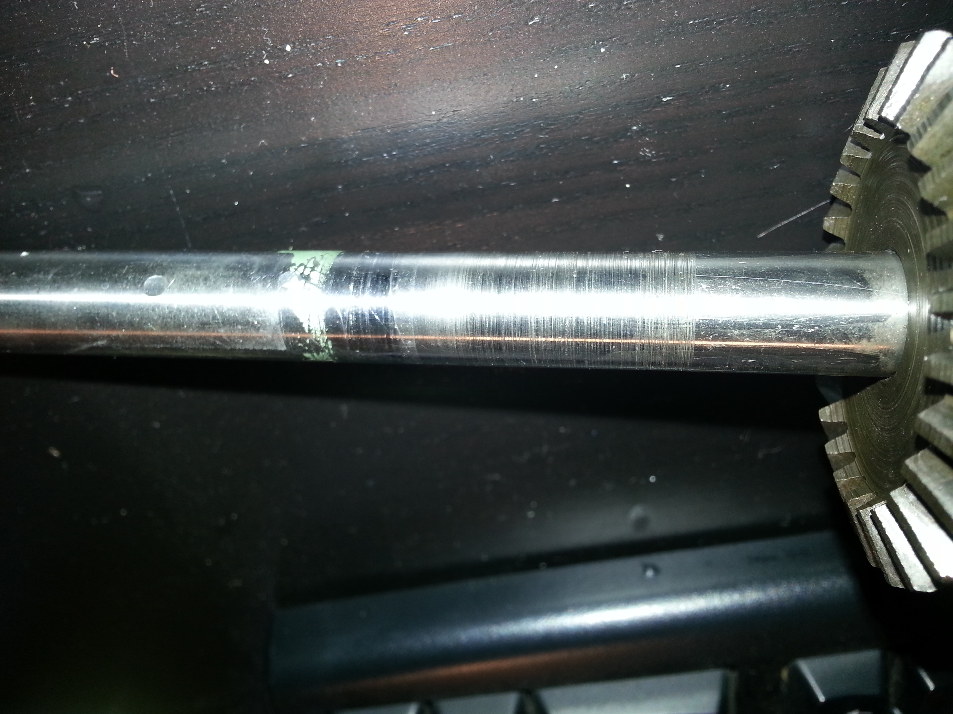

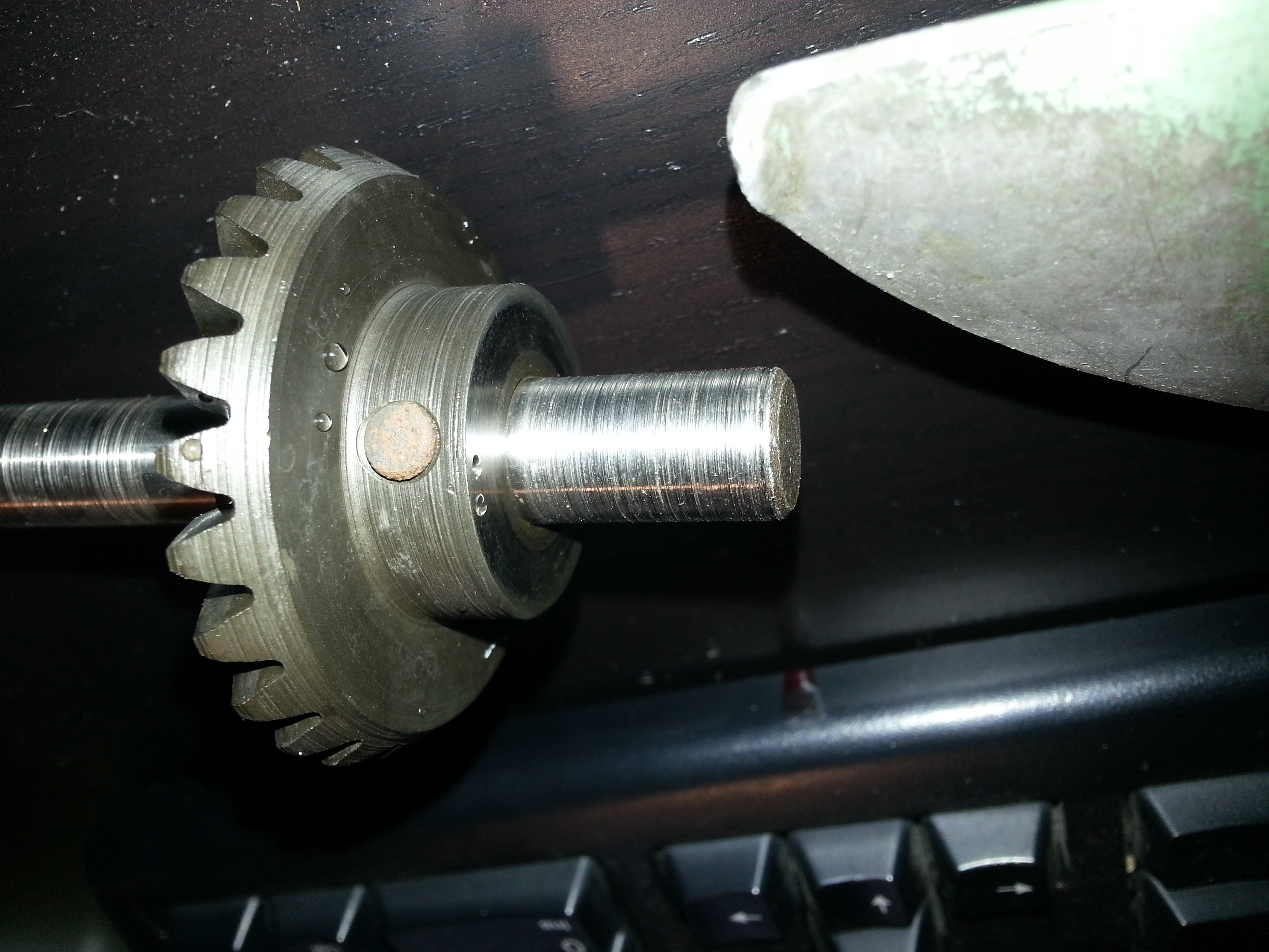

is there any slop with the shaft in the bore? If not, and if it was mine, I’d just polish it up and throw it back in.

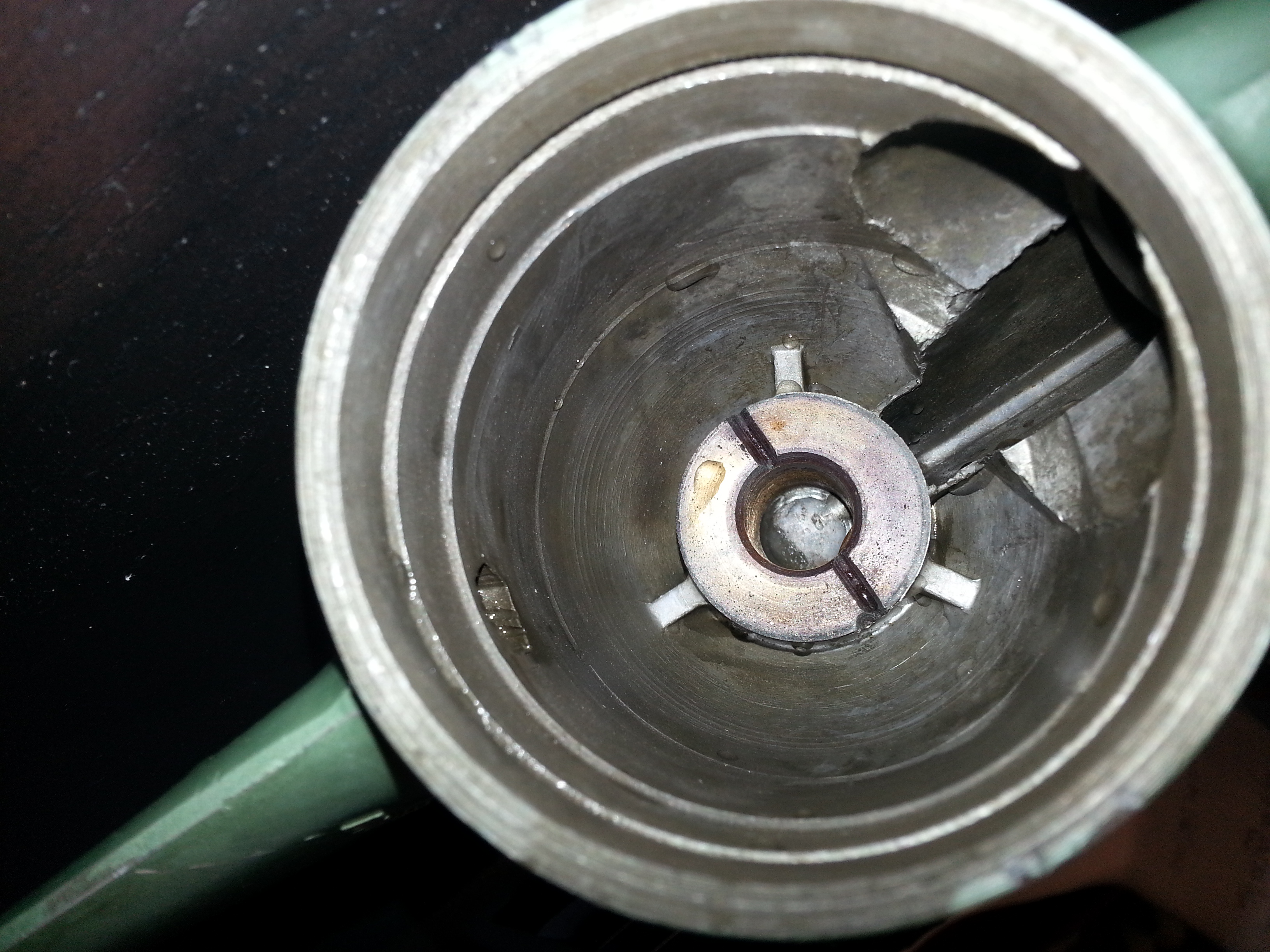

That impeller looks brand new. the one I replaced looked worse and did not return to a pliable state (maintained its position that it was in the housing)
July 1, 2016 at 11:41 pm #39406I can’t say that it’s really sloppy, but you can feel the grooves in both surfaces. The seal behind the prop is rock hard and looks like it let some sand into the gear case. I’ve cleaned it out really well, solvent washed then Pine-Sol then soap and water followed by hot water so there is no grit left.

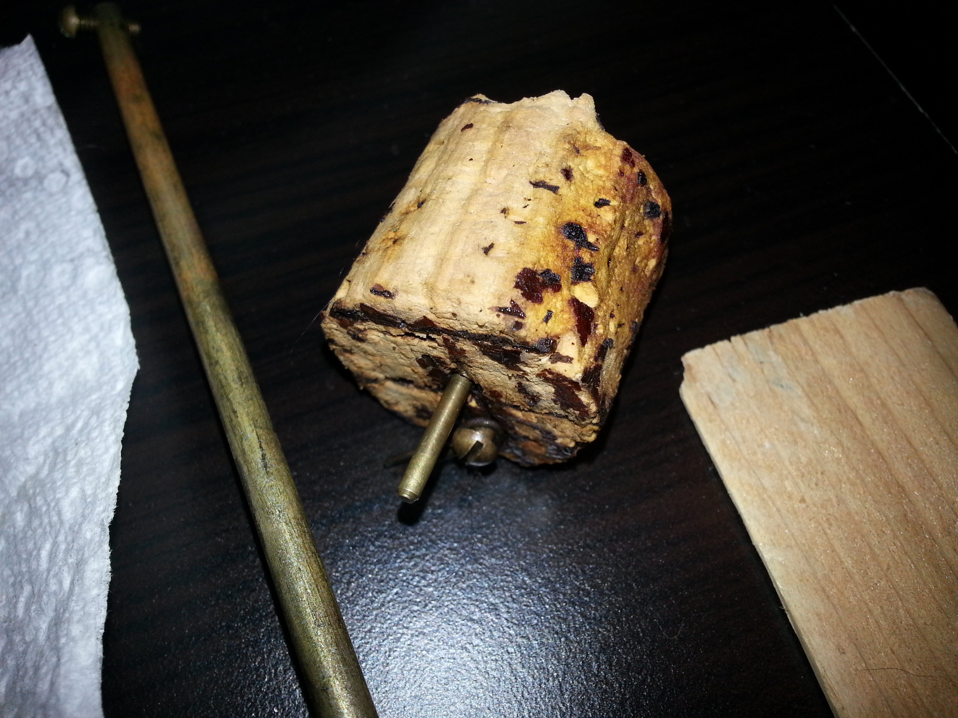

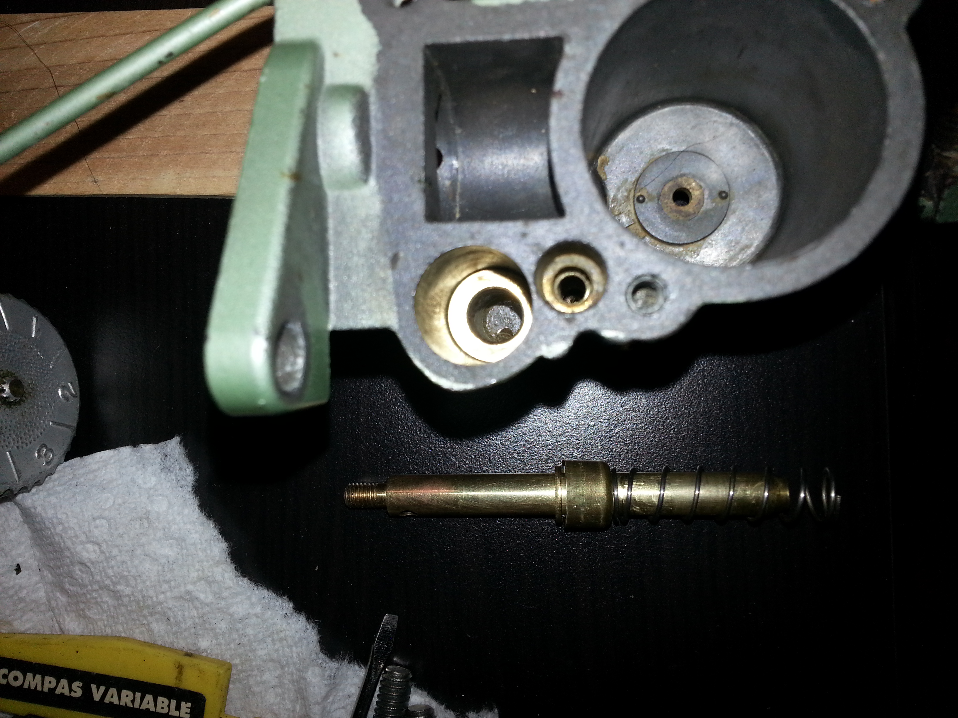

July 2, 2016 at 12:23 am #39407you can coat the original float in clear fuel resistant model airplaine dope couple of coats and should be fine. The impeller if any of the vanes are not straight even if it is flexible replace it while it is apart not worth the risk
Doug
turned off?July 2, 2016 at 12:39 am #39408The longer this float sits dry the more crumbly it gets. I’ll get some butyrite dope tomorrow as well as a new cork and will give a try to turning a new one to the same specifications.

July 2, 2016 at 12:55 am #39412July 2, 2016 at 2:28 am #39429I’ll just bet that motor will run quite a while with that shaft. If you seal it back right as you said, and fill it with "Ackempucky", as my Dad used to say (Corn Head Grease in this case), unless you run it every day for years, I’d say you are good to go. Grease everything well when you re-assemble. Just keep watch for water in the lower unit and keep pumping the grease to it. You are making me want to get my TN28 fixed and going down the river!
July 2, 2016 at 2:44 am #39432quote ShoestringMariner:is there any slop with the shaft in the bore? If not, and if it was mine, I’d just polish it up and throw it back in.That impeller looks brand new. the one I replaced looked worse and did not return to a pliable state (maintained its position that it was in the housing)
Yeah, just take any sharpness off with a polishing grade paper (600-1000 grit), but not diameter. Be careful.
July 2, 2016 at 3:13 am #39437That float may or may not work with a couple of airplane dope coatings. I prefer to use a Mercury float that is made of foam and it is just the right size. Others have used this foam float as a replacement with good results. I have replaced the carburetor float in my 1953 TN28 and my 1937 Johnson 1.7hp model 110 with the mercury float listed below and no problems. There is a post that describes the slight modification to the float to make it work.
Post with information:
viewtopic.php?f=2&t=6125&p=31868&hilit=TN+float#p31868
Sierra Marine Mercury Carb Float 18-7208
http://www.marineengine.com/newparts/pa … SIE18-7208
