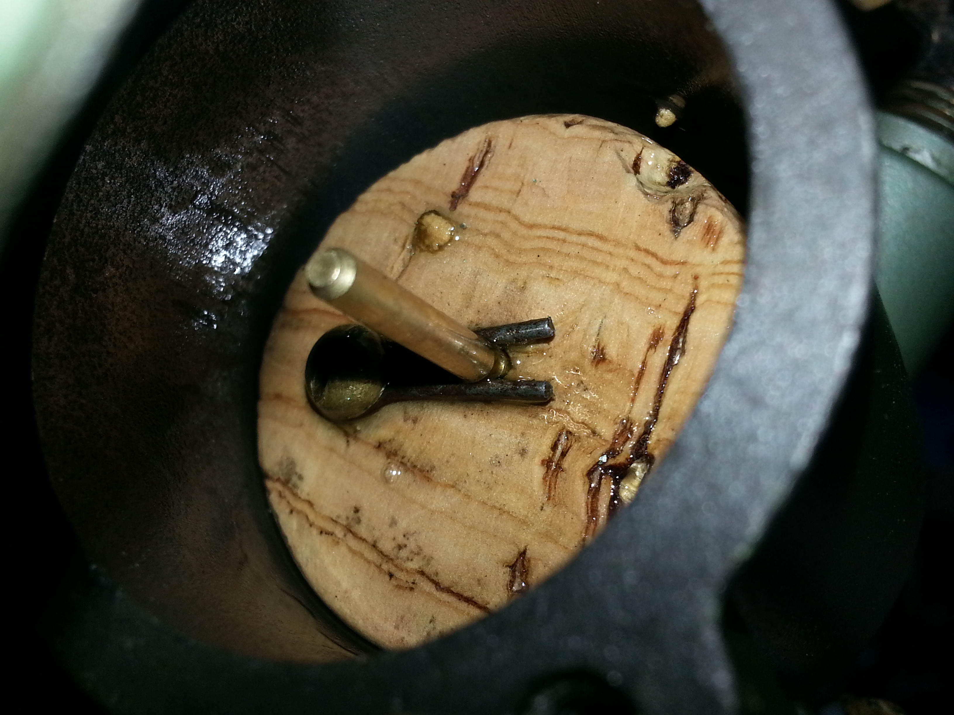

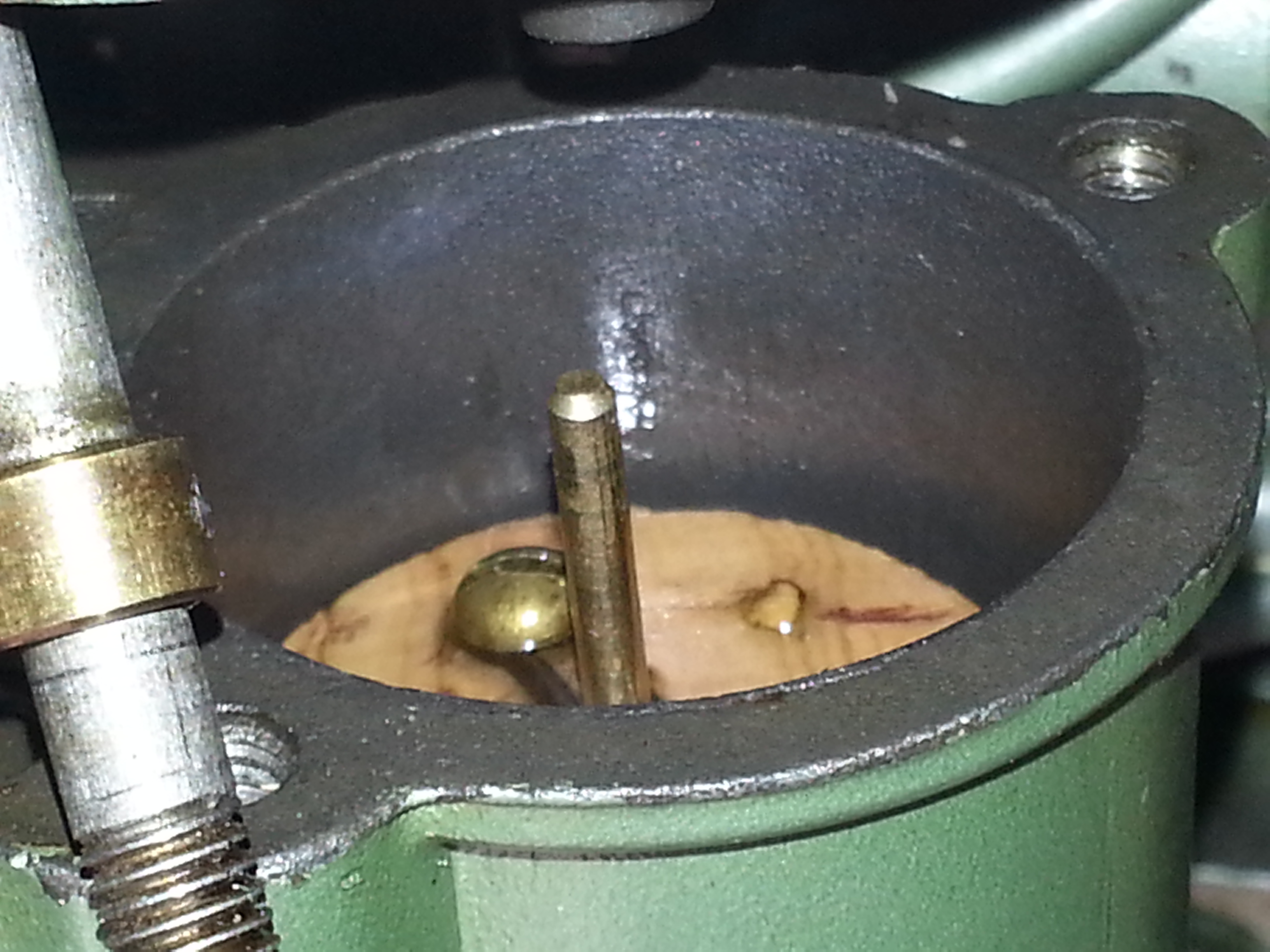

quote :Carb Cap Gasket Leakage after Re-install: Sometimes the carburetor cap gasket will leak a little on re-install. Run the outboard and allow the gasket to swell with gas and oil. It might also be that the float is stuck after the motor has not been run for a long time or the float was recently replaced. This usually will stop after a few minutes of running the outboard. If gasket continues to leak, the carb head screws might need re-tightening or the gasket might need replacement.July 6, 2016 at 11:52 pm #39751cap gasket is good, it’s just all the bowl screws. I’m making thin fuel safe cork gaskets (I love hollow punches) to insert between the nylon and the carb.
I took a little time to rebuild the carb on my daughter’s motorcycle, she’s off and running, so I can finish up!

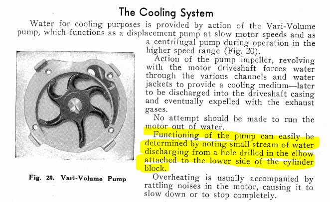

Started great, set the slow idle. Remember I’ve never used an outboard before so it’s all a learning curve for me. Water is churning, I see water spitting from up high. Unfortunately it’s from a steel tube that comes up and connects to the head. It’s leaking at the fitting on the bottom. I shut it down but it seems pretty hot. It did spit quite a bit of carbon out of the exhaust, which didn’t surprise me with the excess fuel in its past.
What is the likely issue and how much harm have I probably done?

July 7, 2016 at 11:08 pm #39828I removed the flywheel and found that one coil did not have sufficient clearance to the magnet hub so I set that to spec, it runs a lot more smoothly now. But after about 5 minutes of runtime, water started spurting out of two holes at the top of the driveshaft casting. I don’t think that’s supposed to happen. Looks like I have bigger problems.
