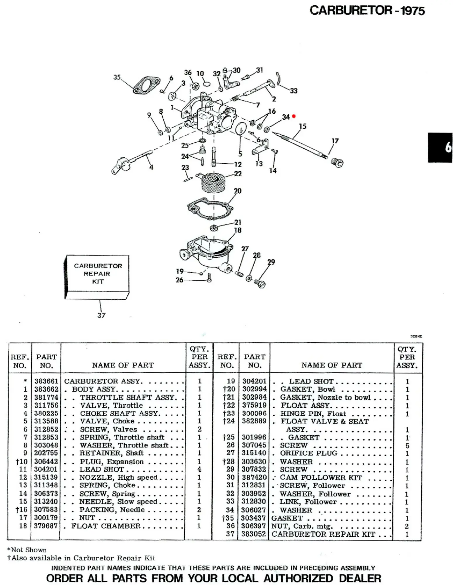

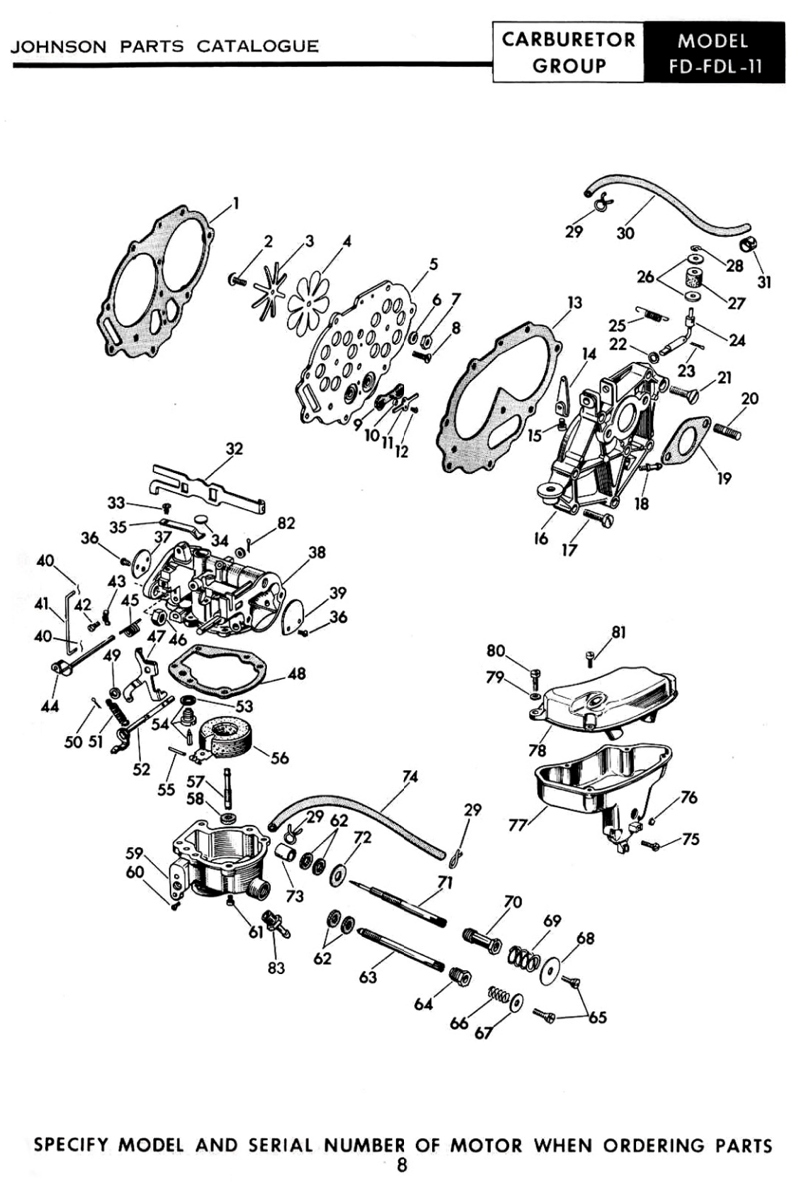

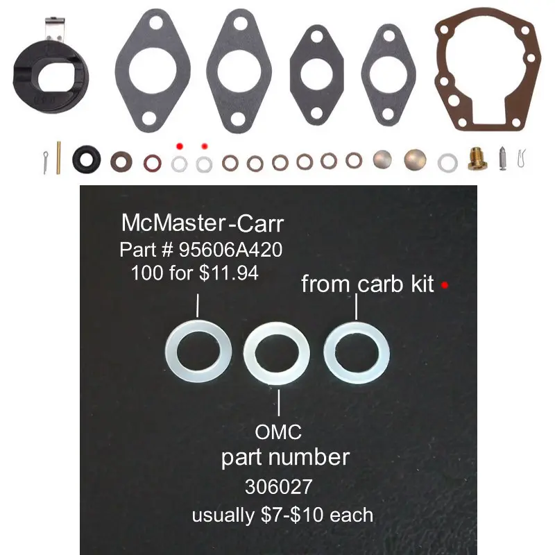

                #326574
                Steve D
                  I bought one of Ben’s packing tools a few years ago and I love it. (I use it on a flattened out cereal box and it seems to be easier on the blades than on wood).
                  But whatever method you use to make them it’s a good idea to use the nylon washer that came with the kits. I don’t know if they were included in the earlier kits because they don’t show up in the parts diagrams until the 70s I think. But using them between the packing and the nut helps to keep the packing from getting damaged too much. And it creates a nice smooth feel when adjusting too.
                  Pg.08-FD-11
                  1975-6-HP-carb
                  Carb-kit-439071-and-nylon-washers
                  #326583
                  outboardnut
                    To Steve D
                    Did you buy 100 of the 306027 ??
                    #326596
                    Steve D
                      #326612
                      fastjohn
                        I would like to buy 10 of the McMaster Carr nylon washers.  How do I contact you?  Thanks
