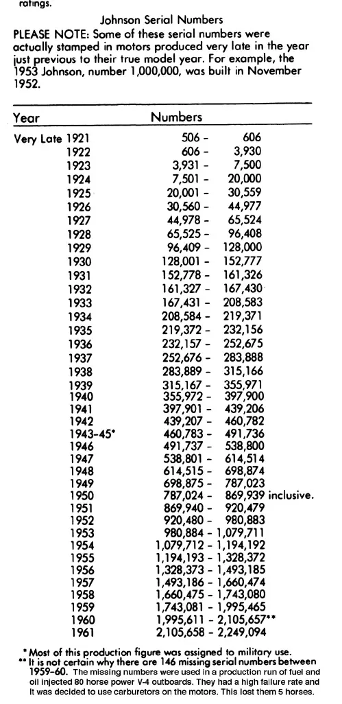

            Bob, you have some older motors listed.  I’m guessing mine is 1940ish.  Would you know of a good search lookup website?  None seem to work for me.  I typed in my model A-50 and the reply said I need more figures.  Struck out too using the serial of 147022, which appears on the rope sheave and the engine.  At least consistent which is not what I found when restoring an old Ford farm tractor.  Not sure if Johnson had serial number for each model or just kept using the next number regardless of model.
            I did find more numbers if they help to ID a date:  Under the flywheel:  71C1243-2:  Two halves of the engine: 25D2 and 25E1:  Top of prop leg: 25B9.
            Thank you for your time:   Did you rebuild those engines listed, have them all now, or just what you’ve had over the years?

              Your A-50 was a model produced in 1930-1932.   For future reference, here’s a link to a list of Johnson motors by model year.
              https://www.southcentraloutboards.com/pages/johnson-model-year-guide/

              Steve D
                Johnson-serial-numbers-1921-1961

                    Thank you for finding out what I have.  Earlier than I thought.  Thanks for the link.
