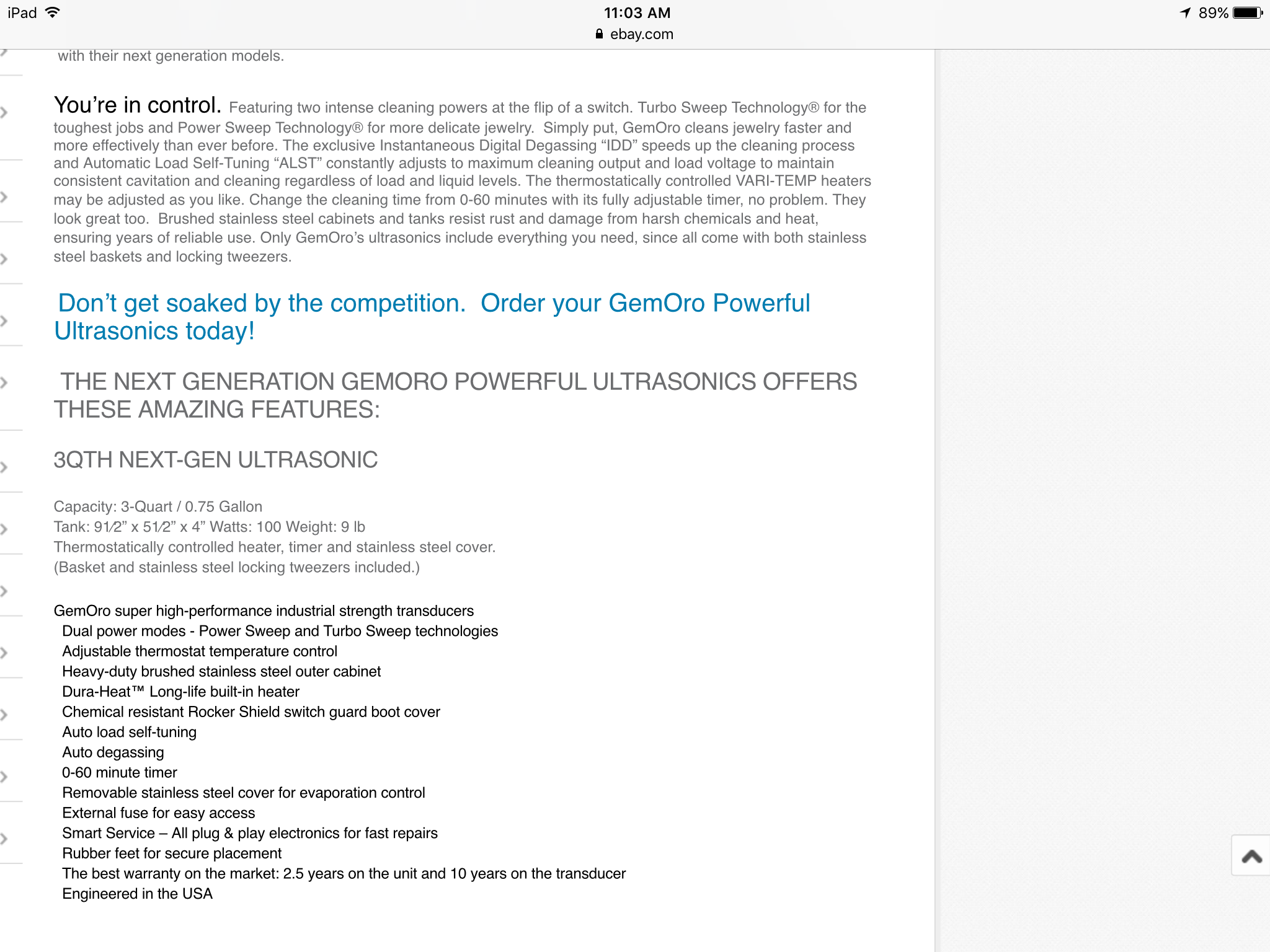

      Thinking of getting one for Christmas. Have spent days researching, apparently there are a lot of poorly made Chinese imports that don’t hold up. Prices range from $29.99 to thousands. Have narrowed it down to this model, primarily due to it’s warranty of 2 years on the unit, and 10 years on the transducer. I think is bit pricey, but I would rather spend a bit more upfront for a unit I won’t have to replace a year or two down the road.

        Looks like a nice unit. With warranties where do you have it serviced, local or shipped, and who pays for S&H each way ❓ How does Smart service work ❓

          Looking at that it seems good, but I noticed one statement that concerns me….
          "Engineered in the USA"
          means we speced it and it is probably made in China as well.
          That does not mean it is not good, just not made here
