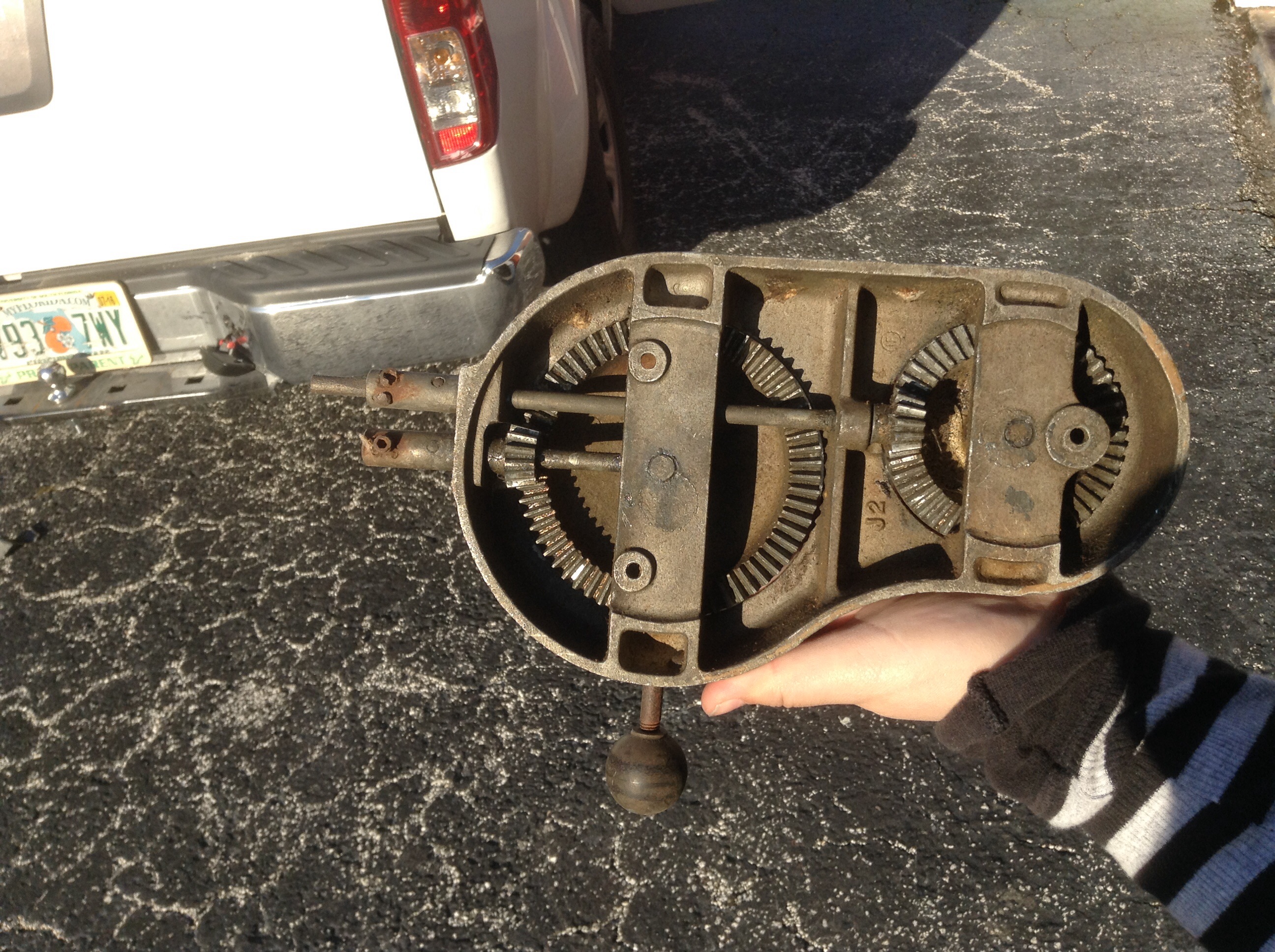

      does anyone recognize these controls? If so do you know what motor goes to? 😐
      #32624
      SCOTT BOGUE
        Check the July 2014 issue of The Antique Outboarder. Adam Gibb did an article on those controls.
        #32626
          In short, they were used on the first 25hp alternate firing twin motors of the 1950’s.
          #32627
          ADAM GIBB
            Randy,
            If you can track down the motor side of the system, you will be in business. The rods can be made to suit the length required.
            #32635
            Randy in Tampa
              I hope I can find the motor side also because I actually have a 1951 bigtwin and a 1954 electric start Johnson, thank you and I would appreciate any more information on them that I can get 🙂

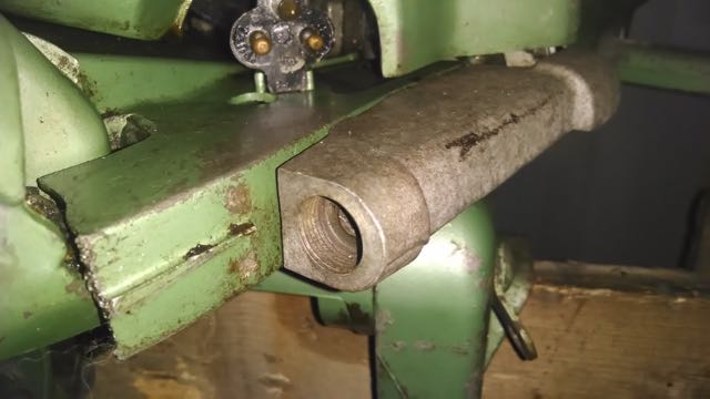

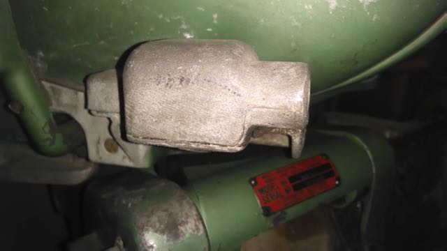

                Randy, Appologies if these photos can’t be opened. If not I will send to you by PM. Haven,t read the article but removed these controls from my 52 or 53 Johnson 25 a few years ago and sent them to Opposed Twin who may still have them. Always wondered what the rotary actuator looked like at the driver’s end.
                #32655

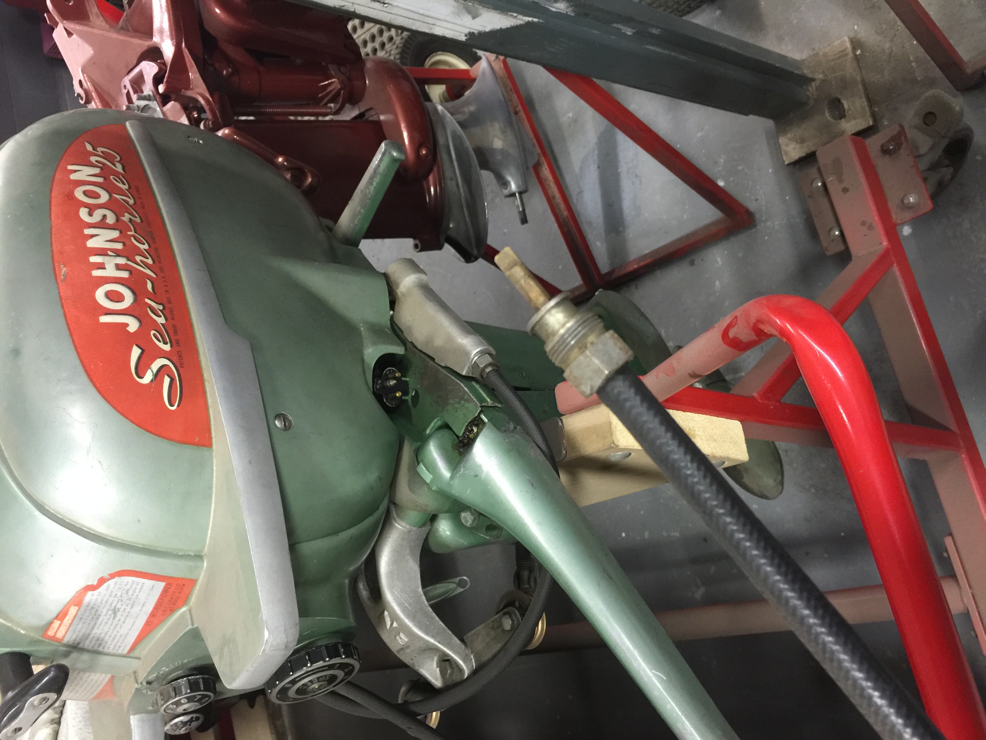

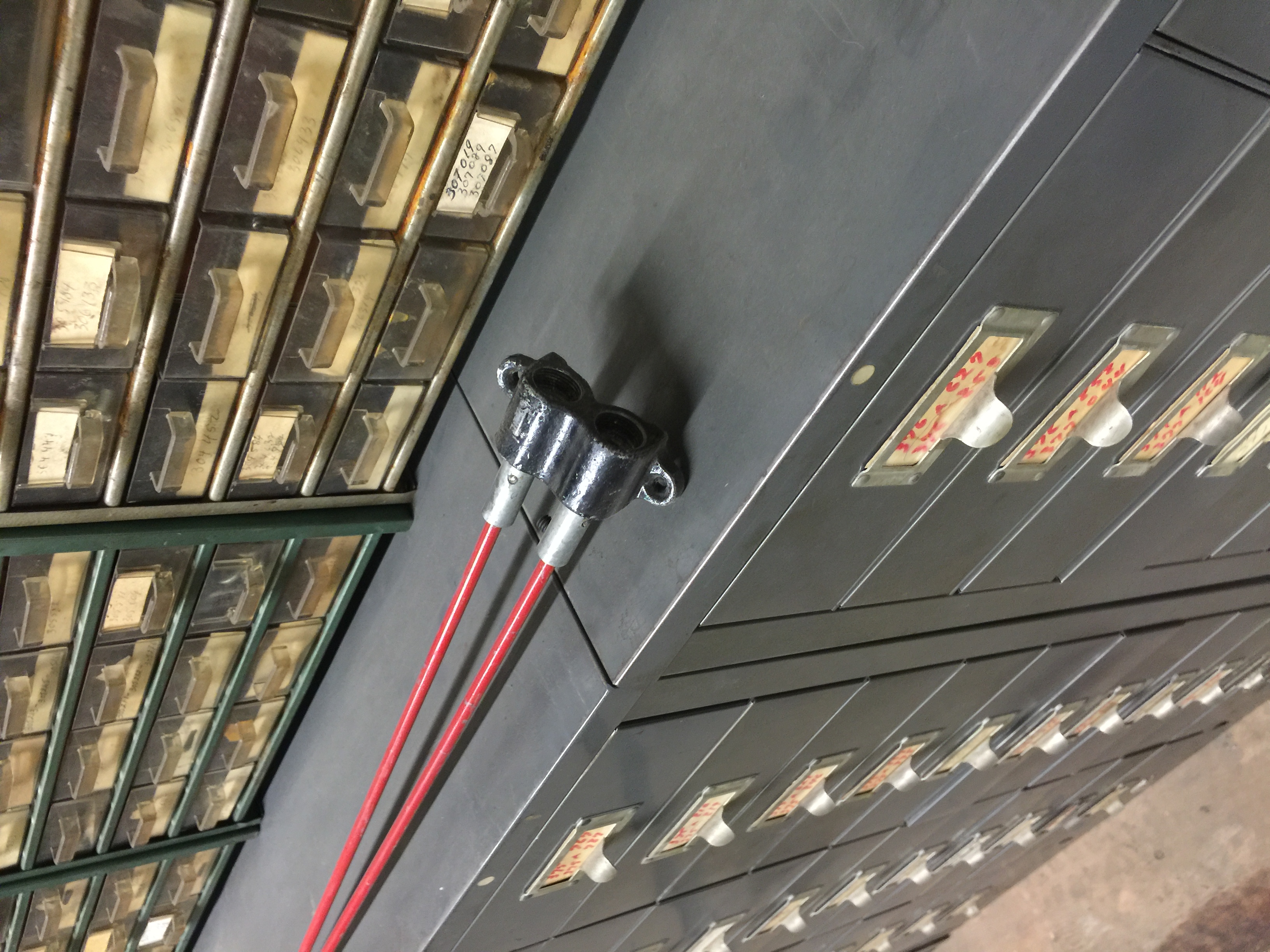

                  And a third part of the equation is the rotary flex cables that connect the rotary rods to the adapters on the engine. And..the adapters that connect the rotary flex cables to the aft end of the rods.
                  #32709
                  ADAM GIBB
                    Here is the flex shaft and the unit that goes at the motor end of the rigid control rods.

                      Wow. Very interesting. First time I have ever seen a control box like that. Definitely different from the later style
