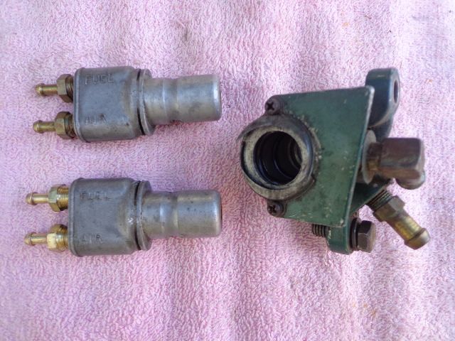

                  Anyone have photos of the Mercury hose "hook-up"
                  at the engine?

                    #21085
                      Here’s the motor side connectors with wrong size brass fittings. I don’t have the tank connector to match.
                      #21086
                        Thanks Mumbles. I’ll keep my eyes open for those parts some day, and
                        maybe I’ll find that needle in the haystack too!
