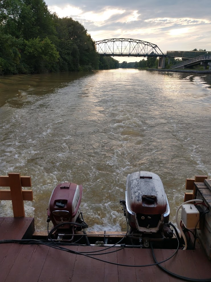

              I run it on the Erie Canal. (Pic attached)
              It started happening there so I replaced the impeller and am now testing with ears and it doing the same thing.
              Thanks.
