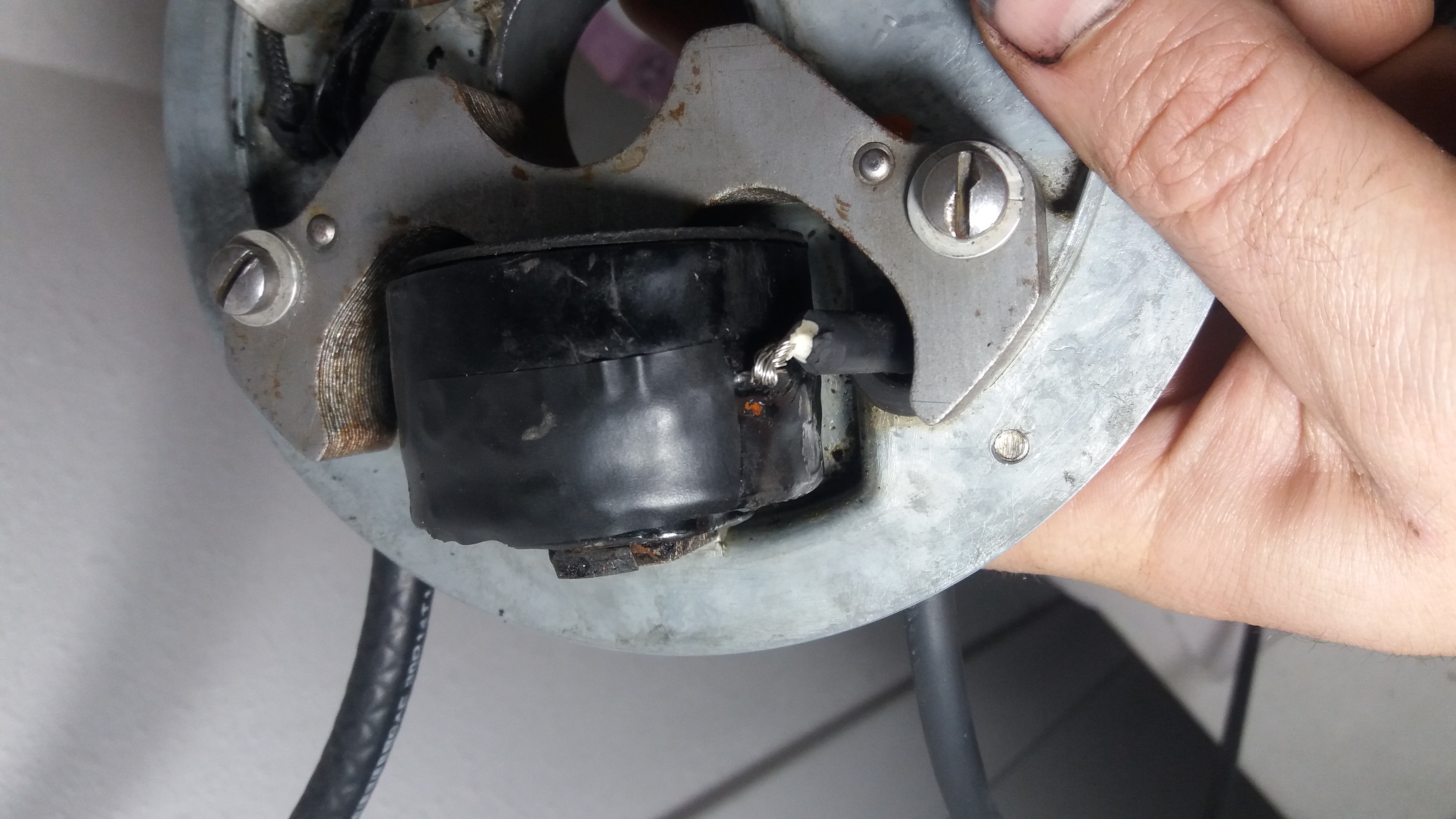

                  Heat will destroy the secondary windings, Get a pic of the connection for us to see please,

                      That will be just fine as is. I don’t know why it worked after you twisted it and not before. But there are thousands of motors out there with merely twisted spark plug wire connections, and no problem
                      BTW, what’s with the tape? Maybe something hiding under that?

                        There is a small ding under the tape. I put it there to see if it was arching in that area but it is not.
                        Thanx for your advice, all. I will leave it twisted and test t again.
