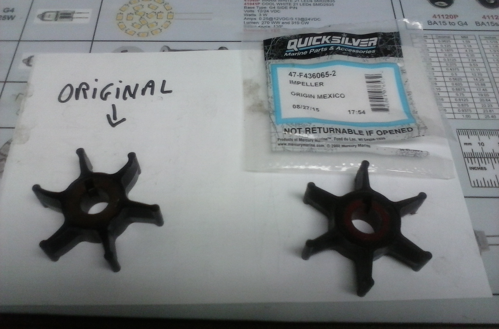

March 16, 2016 at 11:13 am #33510Bill that’s an interesting idea on the water pump. I had never thought of doing something like that. That idea could work on many different applications where the impeller is NLA. I think that I have found an inexpensive impeller to fit the 12 hp West Bend. I am going to try it today to see if it works. The NLA Merc impeller that fits these are insanely expensive on Ebay [to the tune of $70] I’ll report back my findings later today.
March 16, 2016 at 1:43 pm #33517Ok, here is the impeller update. The new OEM Quicksilver impeller is a perfect match for my 12 hp [West Bend built] Elgin. If the 18 hp motor uses the same impeller cup, etc. this might work. Maybe someone can research that, as I don’t have an 18 hp parts catalog. This impeller retails for $20 from Mercury Marine.

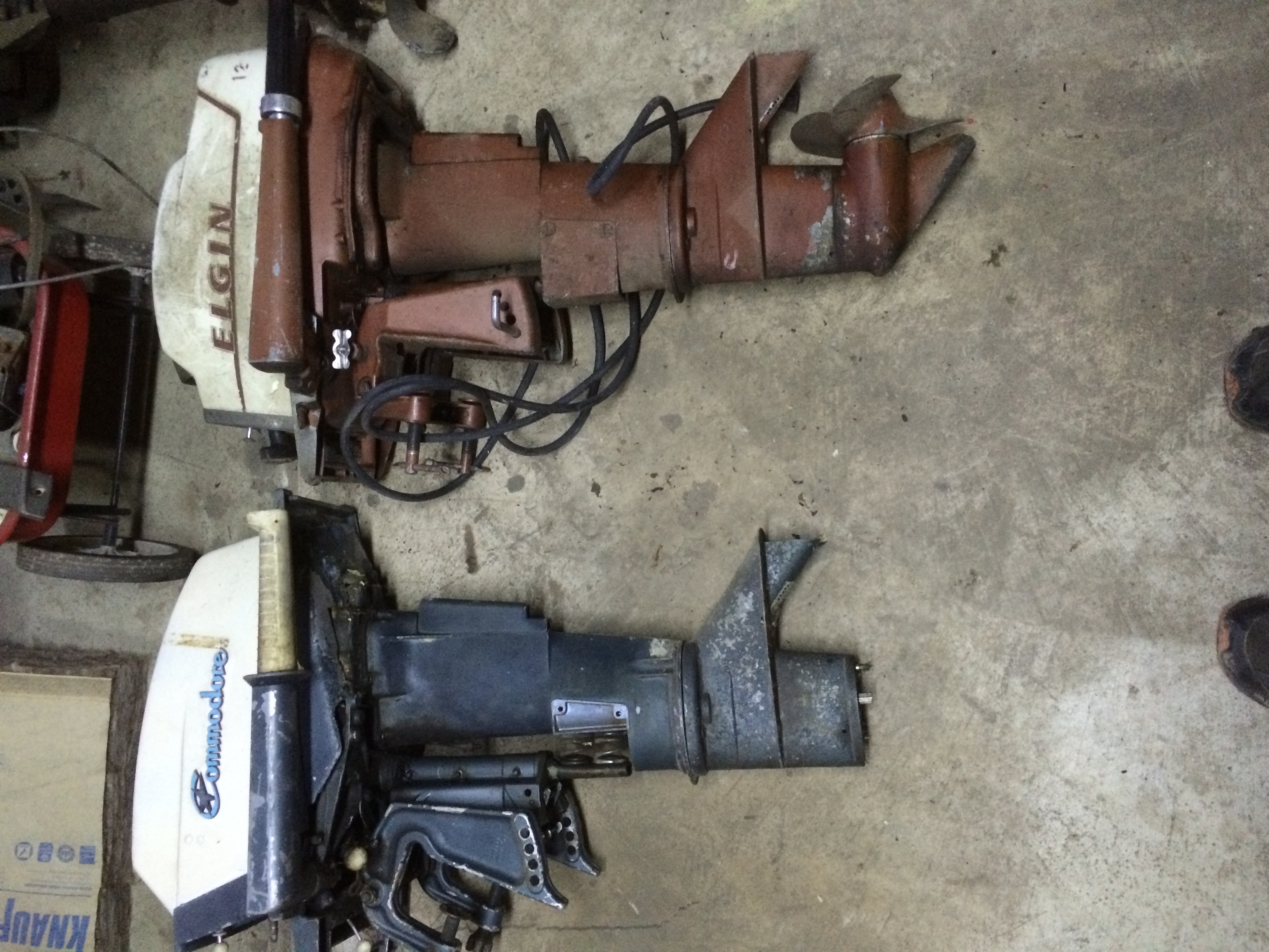

I know the 12hp Elgin lower end is just about identical as I have a ’58 Elgin here also.
I picked up a lower gear case from a seller on ebay supposedly form a 72 Chrysler 20hp that is mechanically an exact match to the Commodore 18 (skeg shape was different) But I still need a seal kit for it. Would a Sierra 18-2638 or 10-2639 seal kit work? I picked up a pack of obsolete Chrysler 9C 78555 Gaskets for where the upper and lower gear cases bolt together but still need the seals.download/file.php?mode=view&id=1886
