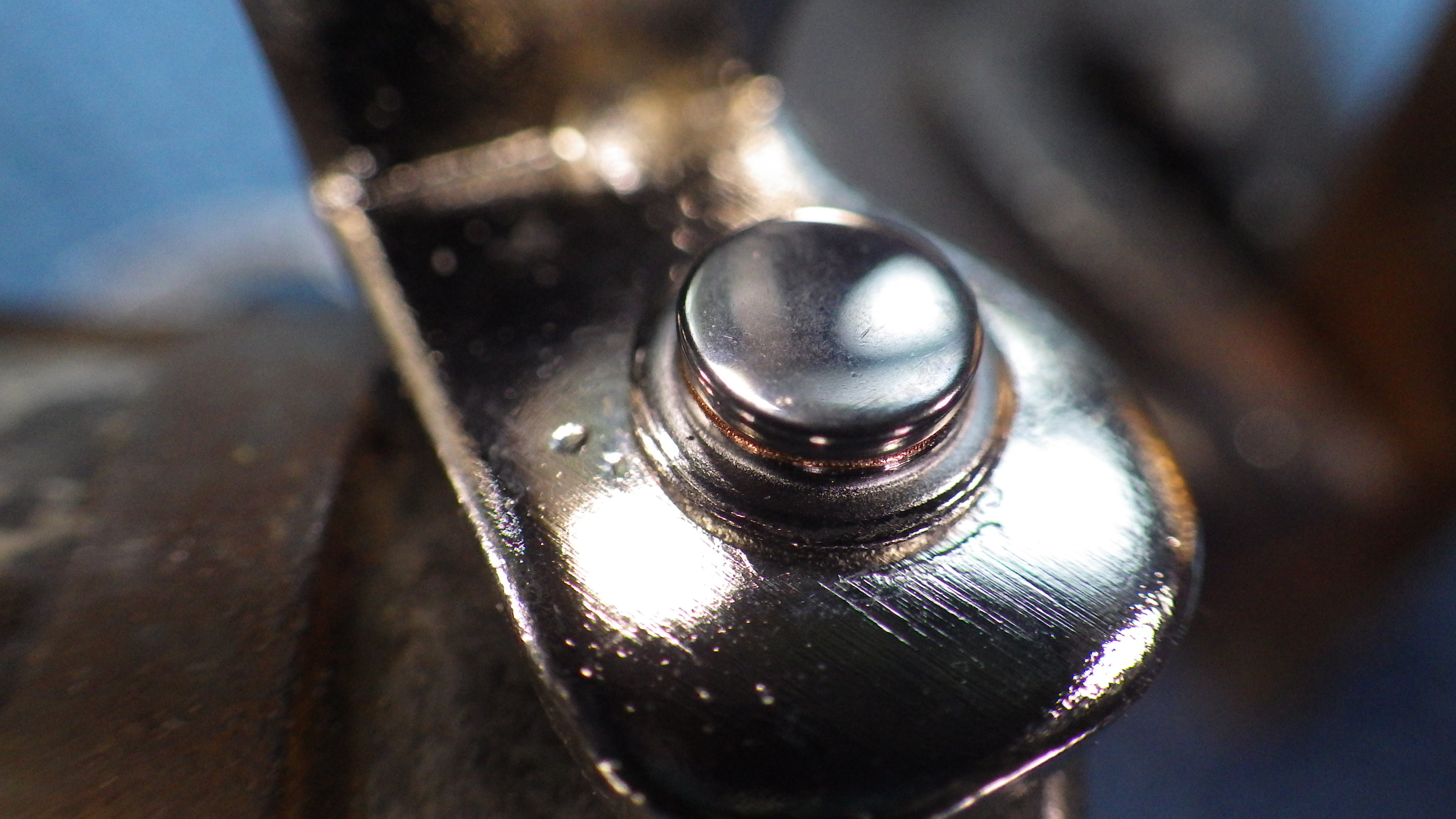

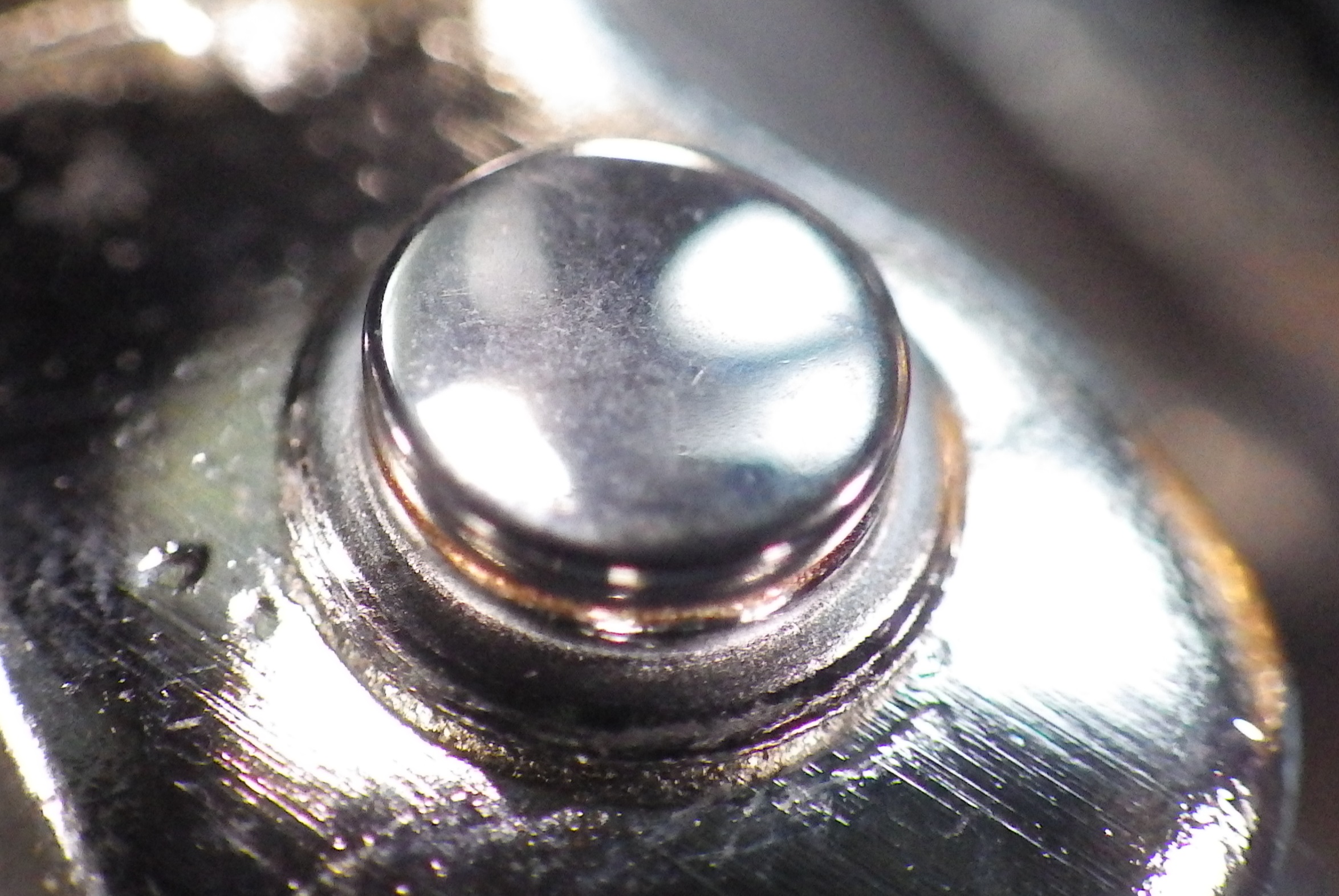

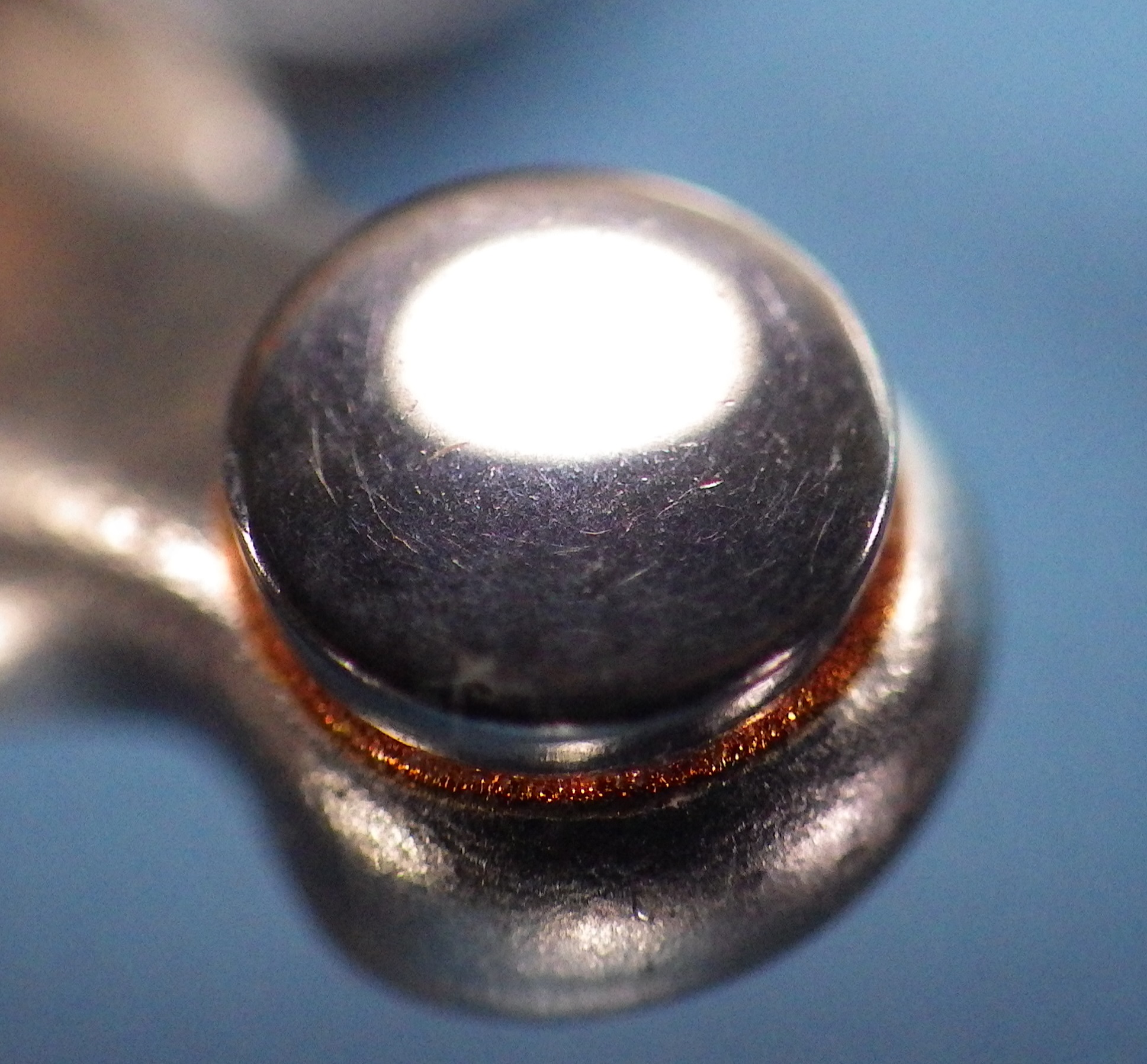

        Usually they are tipped with tungsten which is hard and resists eroding away from the spark arcing across the points surfaces. Here’s where a smooth polished surface and proper condenser is needed to help keep the arcing to a minimum.
        You can see the laminations in these pics.
